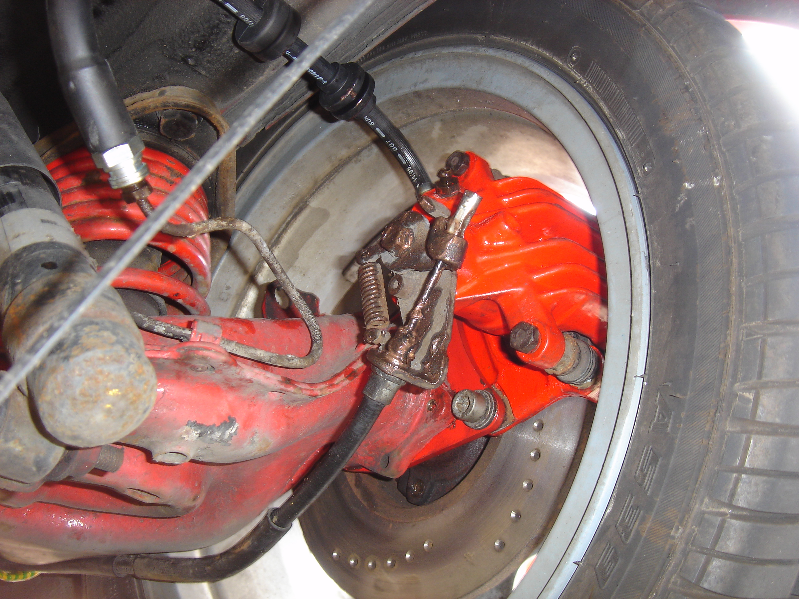

Well today i spend about 3 hrs ish fitting the new rear discs . worked out really well apart from snapping the end off a hex key ...:p even got misses to help bleed the brakes :worship:.
took the car for a 20 mile drive after i tested to make sure wheels wouldnt fall off lol pads started to bed in to the discs and the hand brake works better then my drums ever did even though i havent finished adjusting it yet :D
Here is some eye candy for ya ..

AFAIK ? what's this ?
If I undestarnd, you have 4 front brake lines in your car ?
oki thanx , my english is so bad and every topic I'am not sure to understand well lol
I used the same brake lines that are on the front as the fitment is the same . I will be upgrading to braded hoses as soon as i have the money and figure out where to get them (y)
