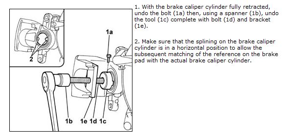

New or reconditioned calipers are usually supplied with the pistons fully retracted, however you may need to turn them slightly to align the two cut-outs on the face of each piston. They need to be horizontal to allow the pads to locate correctly.

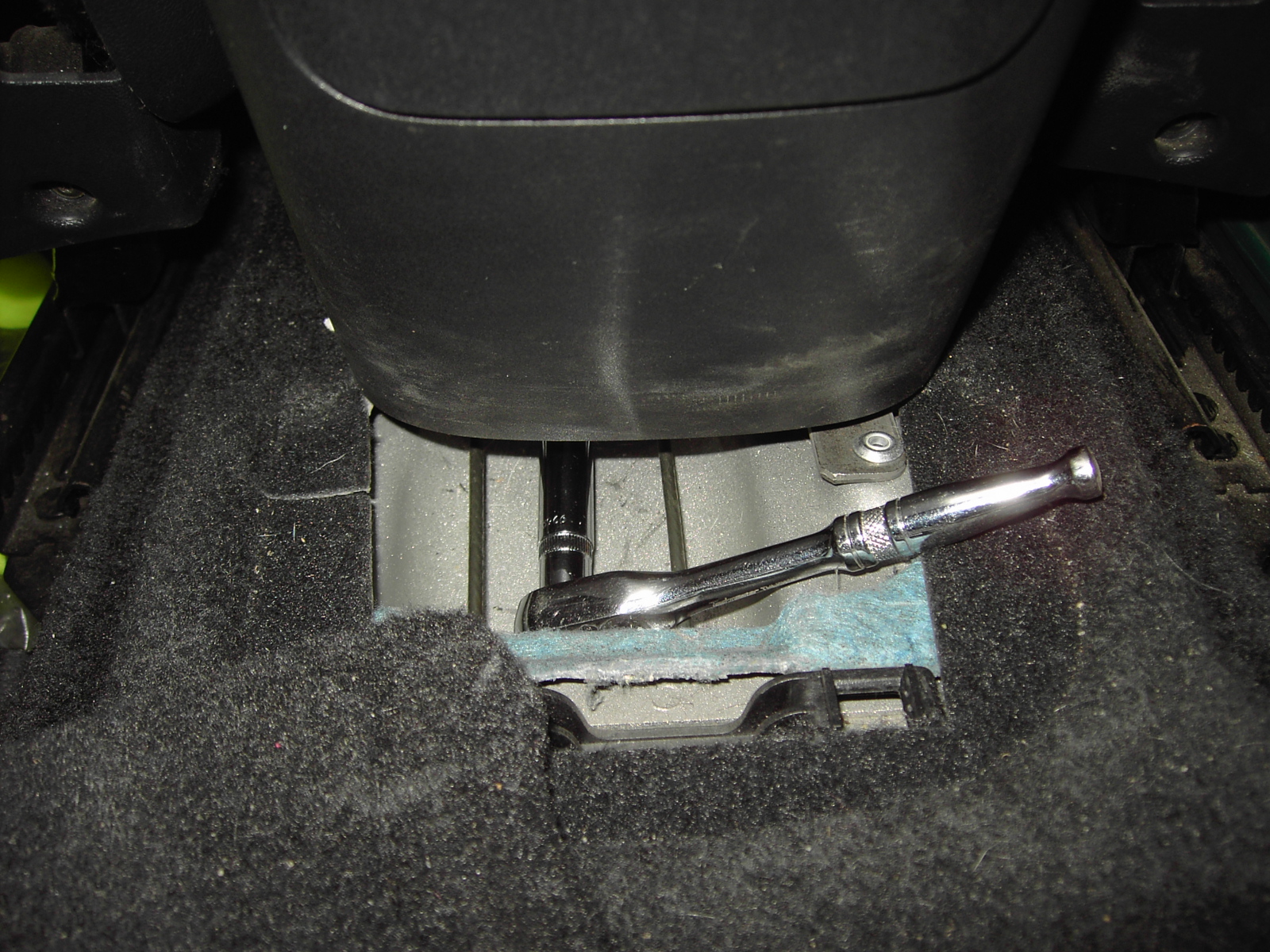

Once the new cables, pads and calipers are fitted, press the brake pedal several times with the engine running, then adjust the swivel yoke at the back of the centre console so that both rear wheels are locked with 5 clicks of the handbrake lever ratchet.

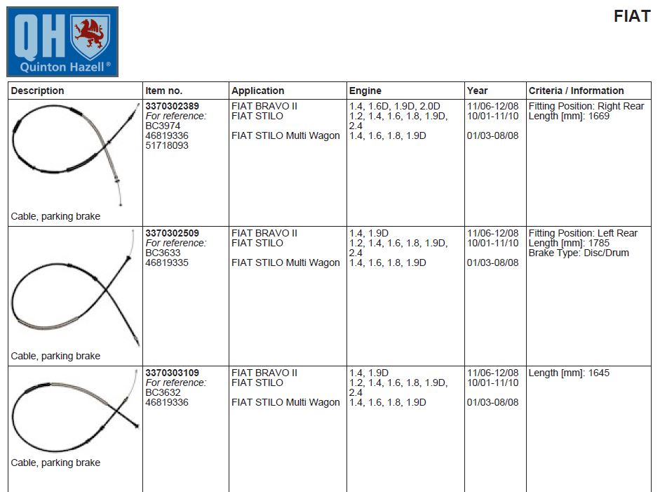

A lot of online sellers (especially on eBay) don't give accurate alternative part numbers for the item(s) they list. My guess is that they list as many alternative part numbers as they can find, just to get you to their listing (via a search for any of those numbers) just to make a sale. You buy the part, then discover it's wrong and send it back for the correct part..... They've got the sale, but you've been inconvenienced. I always do a a lot of my own research from ePER and aftermarket manufacturer parts catalogues before buying anything from these sellers.
Best way I find is to search ePER using your VIN, then cross reference the Fiat part number in aftermarket catalogues to get their part number. Using your VIN in ePER will highlight the part number(s) fitted to your car, and grey out numbers that are not fitted. That's a bit difficult in this case though, because ePER shows 4 part numbers (LH & RH for early cars and LH & RH for later cars), whereas the QH catalogue only shows three numbers and doesn't say which side one of them is for. It's not mentioned whether the lengths quoted by QH are for the inner or outer part of the cable.
BC3974 RH 1669mm.
BC3633 LH 1785mm.
BC3632 ?? 1645mm.
>> EDIT: One seller is quoting that QHABC3633 is compatible with both 46819335 AND 51702642.. and is 159cm long. Not sure if that helps. Ralf S.
46819335 and 51702642 are the early and late part numbers for the left cable. The change or modification reason is shown on ePER as "New brake and handbrake tubes on rear suspension". Your guess is as good as mine as to what that means..... Changed the size of the cable mounting clip on the rear axle perhaps.

But if BC3633 is really 1785mm long, then it is the longest cable available .. but the cable I received is too short.. which is why I suspect that it can't be the correct cable.
Fittings are correct though. I bet it fits some other Fiat/Alfa.
1785mm is the inner cable length. The cable I received measures 1460mm (outer sheath) whereas I have seen BC3633 also listed as "1590/1785".... suggesting that I need a 1590mm outer sheath. The closest I could get it (pulled tight) was around 100cm too short.. so 1590mm would be a perfect fit.
