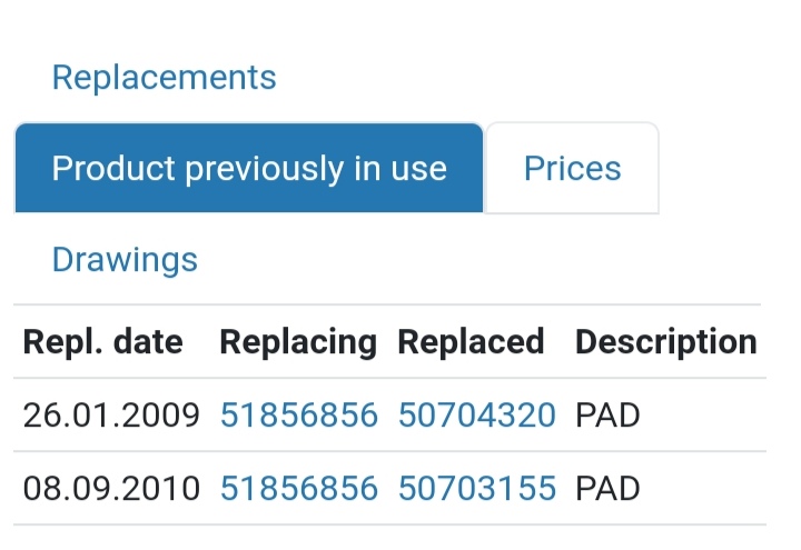

51856856 replaced two earlier numbers
51856856 appears to be correct for various models including the cross
