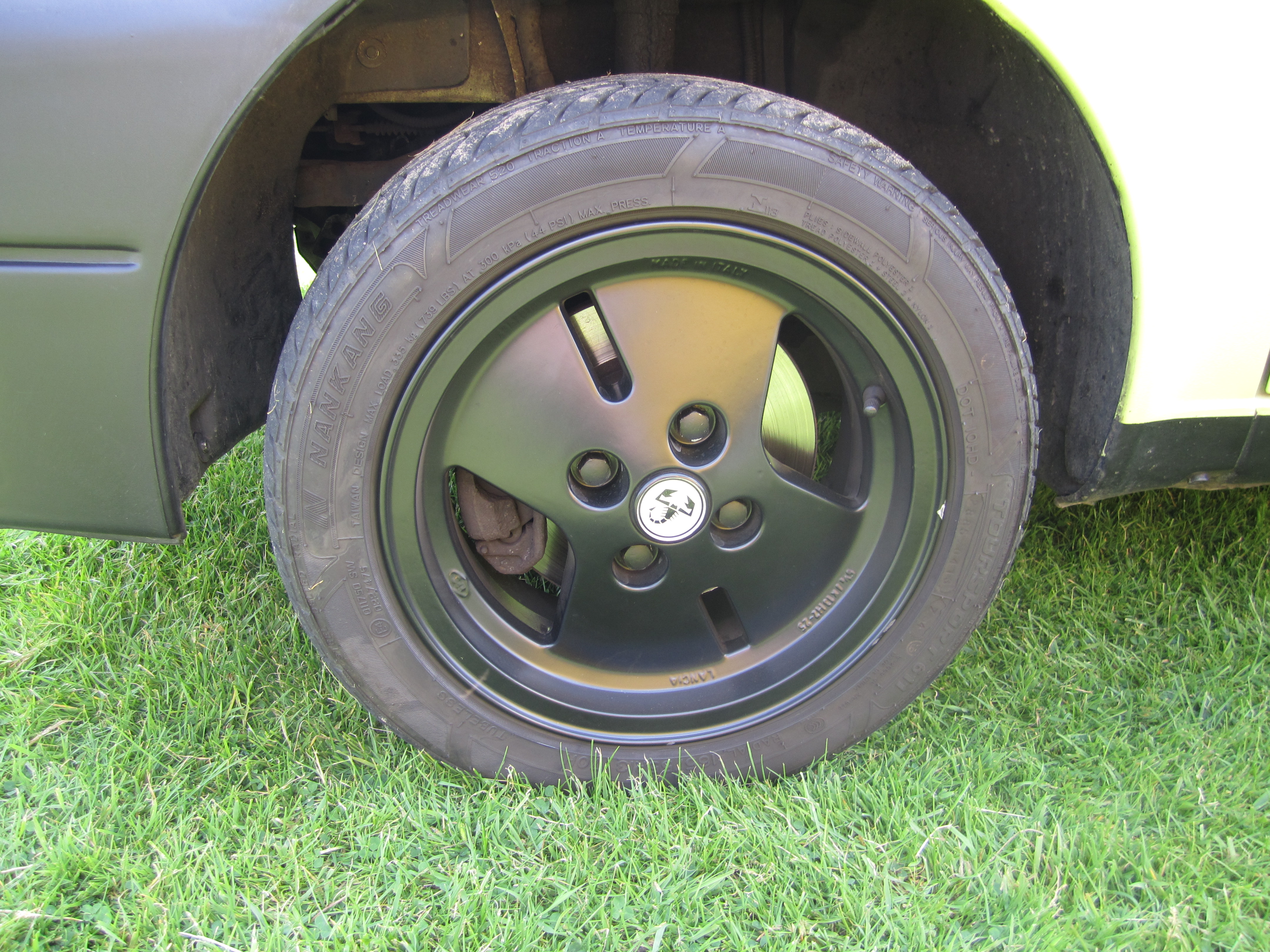

Ugh stupid bloody tyres, the rears which have become the fronts are terrible.
It was raining, the car wheelspinned in second. The roundabout I always do at 30MPH, today I was doing almost 24 MPH and the front end went, they have no grip whatsoever, causing me to drive gingerly... ok, thats a lie. When theres any kind of moisture on the floor I can't drive 'normally'.
managed to clean the wheels and underside of talon well, and i must say. 175's stop a lot better in the wet than 145's!
