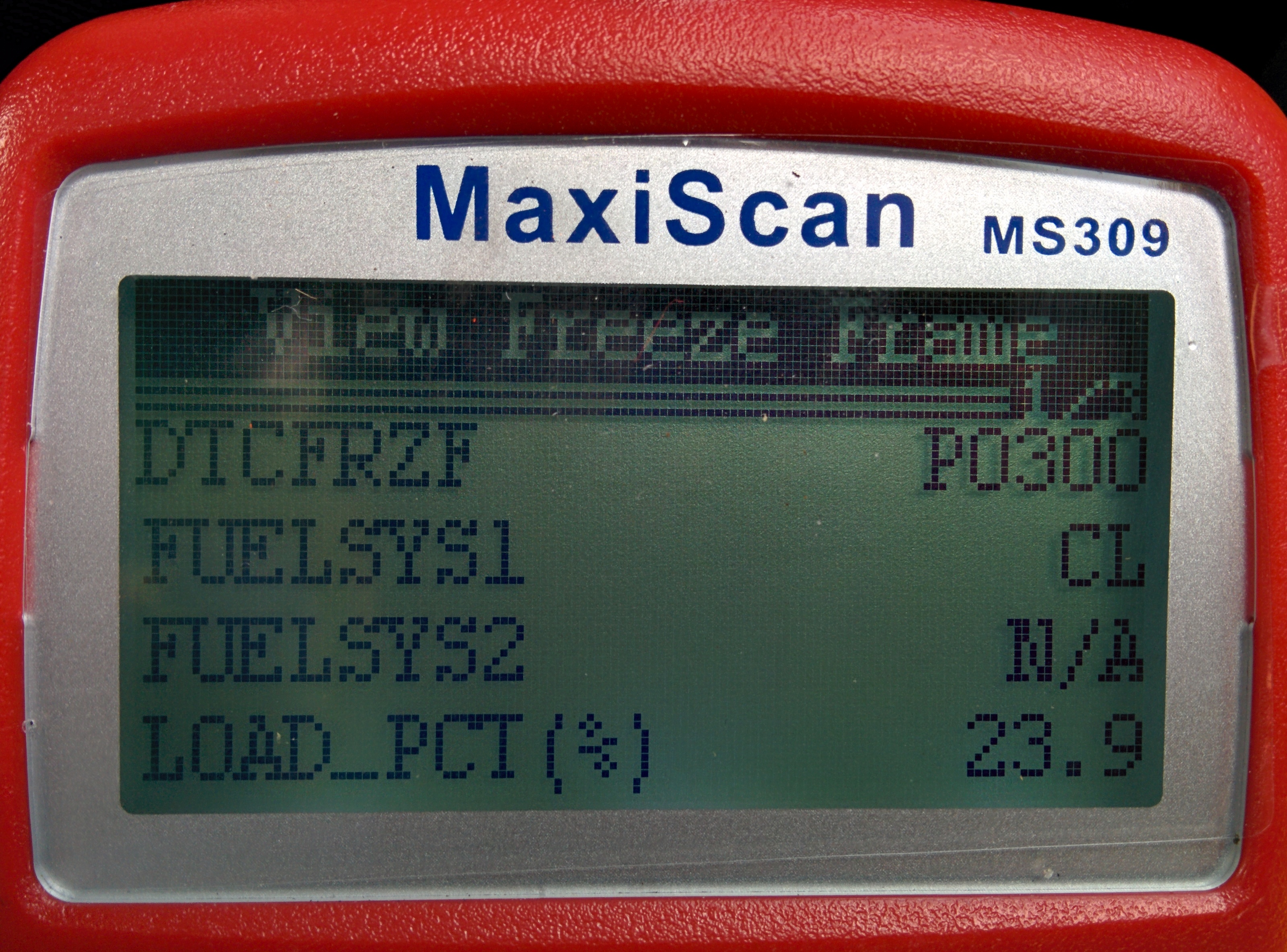

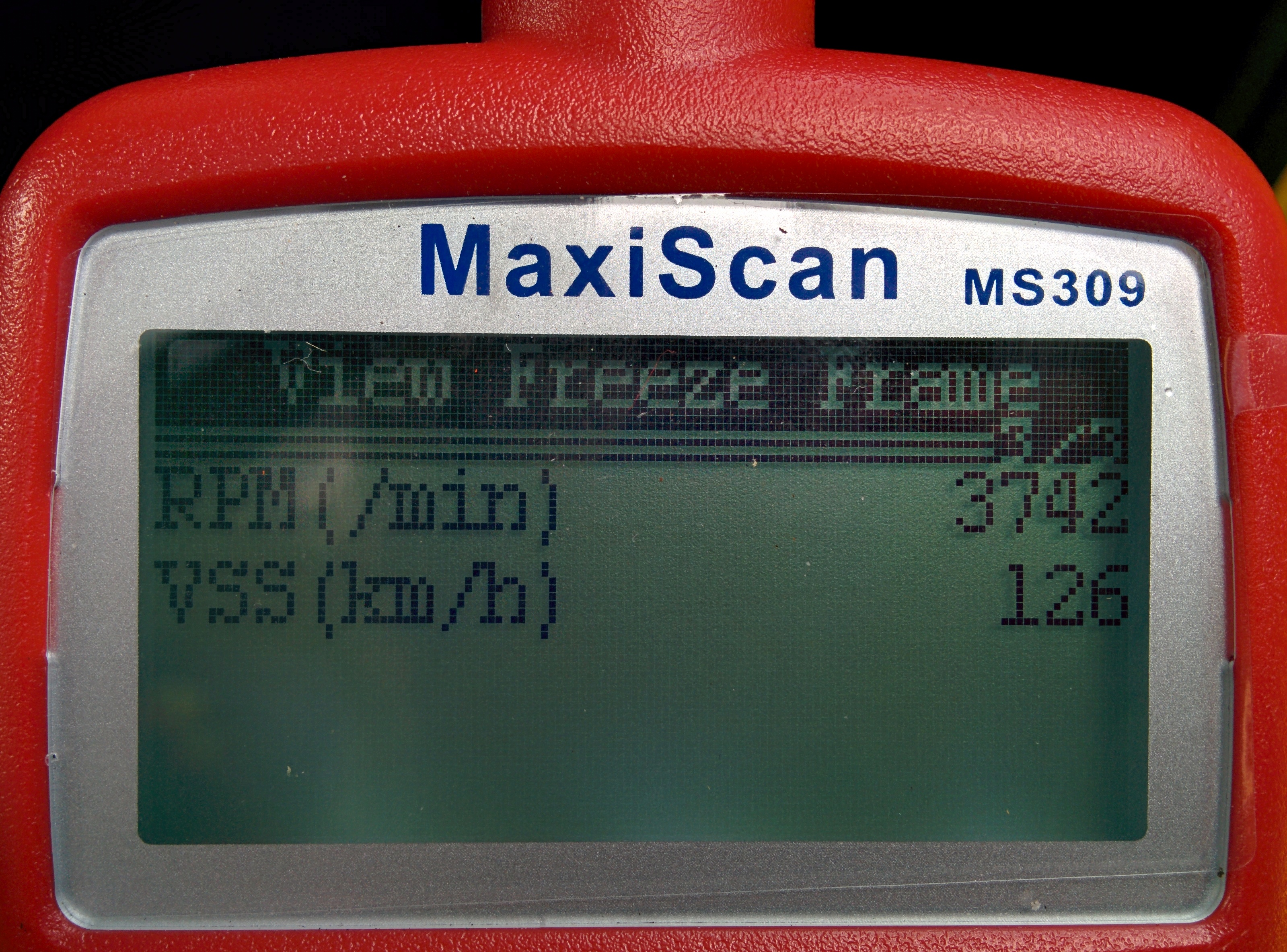

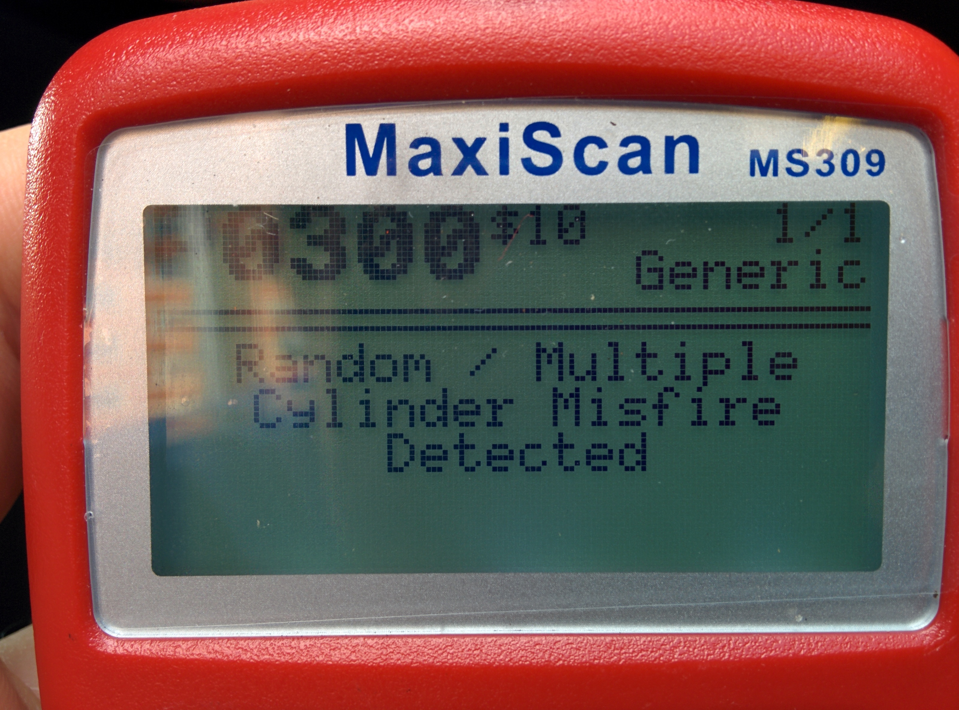

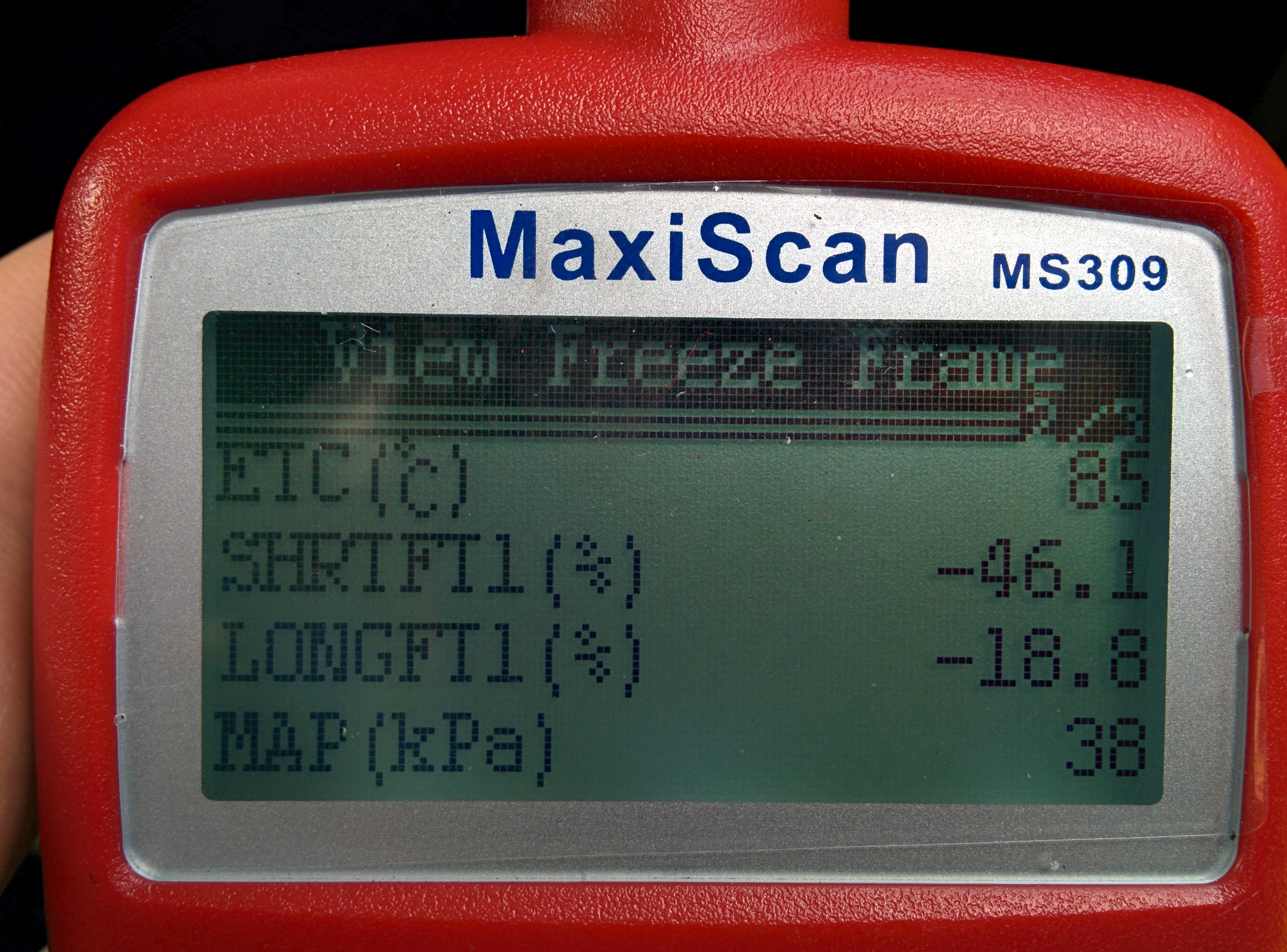

going down the motorway when I got above 4000 rpm my engine management light started flashing, let the revs drop and it stopped, got above 4000 again it started flashing again.
Plugged in my code reader, got random / multiple cylinder misfire detected.
It has.
new Magnacore kv85 leads
new NGK iridium spark plugs
new crank sensor
I have also visually checked wires
so all the things that I have looked up point to ^ so suggestions needed, also freeze frame data attached.
