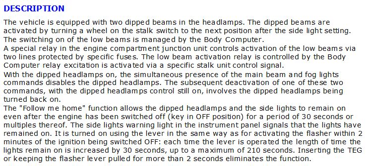

ok, but for automatic light i need of a sensor on Grande Punto? becouse i cant find and i dont know where i put it on car..
Not sure such a feature exists on the Grande Punto...
See description and drawing from eLearn.
BRs, Bernie
