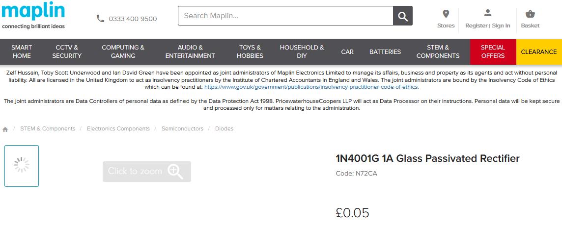

BUT Maplins have now become online only, I think, and do not seem to list any components any longer....
Hence the reference number for the diode N72CA gives a "no products match that" type response, so,
May off chance question, based on my not being an electronics specialist, is what are the characteristics of this diode and can ANYONE give me a link to something that will do the job ?
I know being DC the calculations are easier, supposedly, but that is about the limit of my knowledge...... what current does the radio consume, are there any other things that need to be considered ?
So, can anyone help me ? I know the thread is old and that things have moved on, but of course my motorhome is one of the old style ones....
The 1N4000 series of diodes are all probably electrically adequate, but not perhaps sufficiently physically robust in a vehicle enviroment. The 1N5400 series are more robust with thicker lead out wires, and are rated at 3A.
