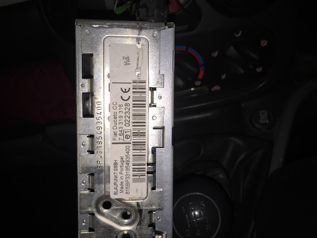

Hello
Could someone gine me the code for the old unit?
<M009492> and
<M015934>.
