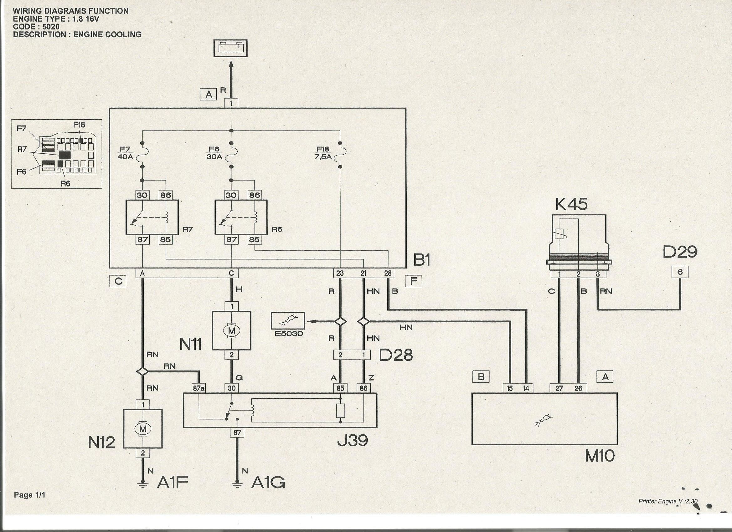

Your Ecu sends the earth signal's down pin 14 (low speed) & pin 15 (High Speed). On the diagram B1 is the fusebox in the engine bay, J39 is the black relay attached to the fans (this controls how the fans are connected (high or low speed). Relay 6 is low speed, Relay 7 is high speed.
There's a connection with two wires in front of the gearbox, this has the two wires which are your earth's from the ecu, they control the fan relay's in the fusebox, check that plug is connected (mine had rotted away).
