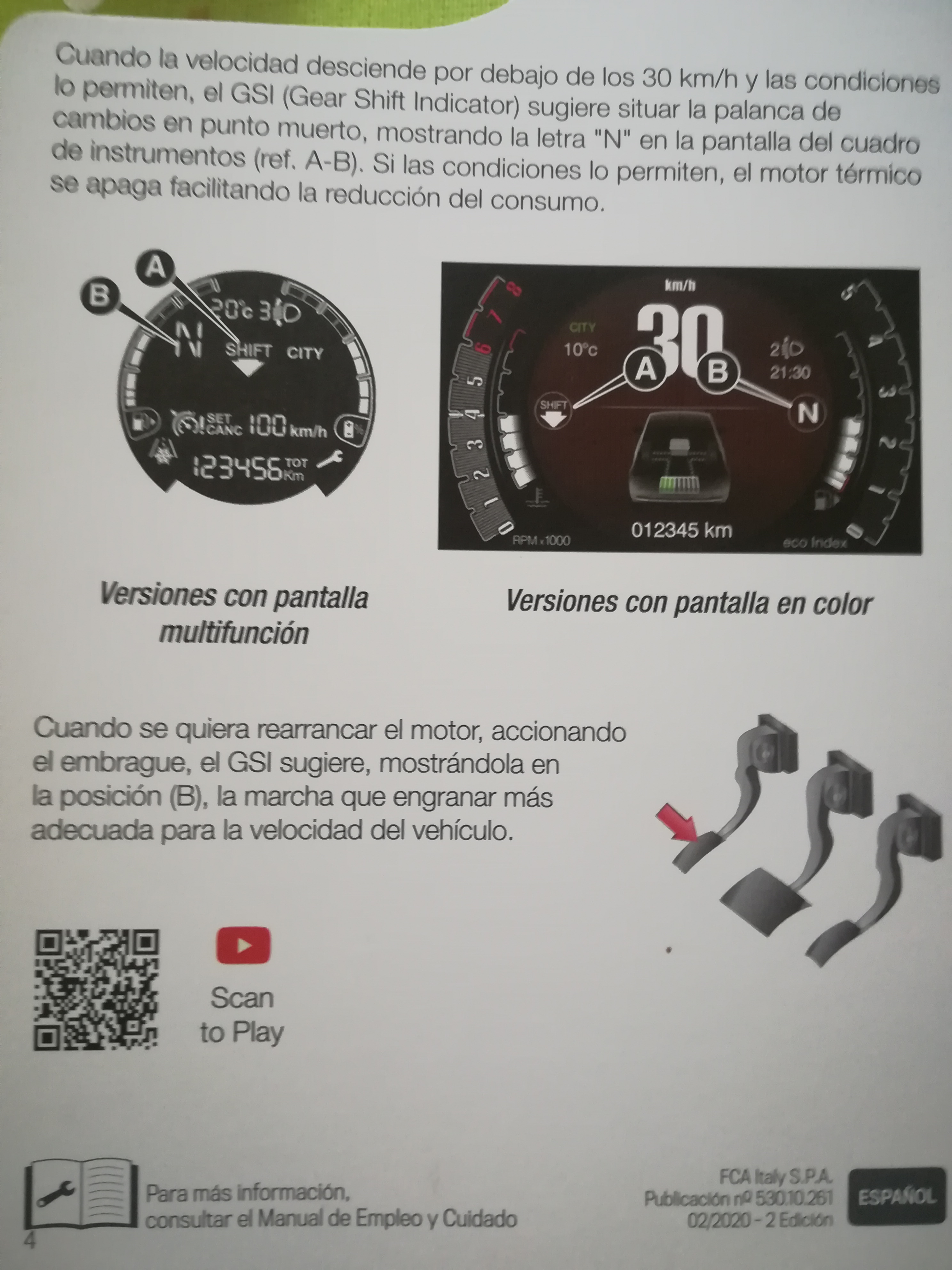

Here's the page from our Spanish 500 mild hybrid hire car
Basically saying: when speed drops below 30kph the Gear Shift Indicator (GSI) will suggest selecting neutral. If conditions permit, the engine will turn off, facilitating a reduction in consumption
Engaging the clutch will restart the engine and GSI will suggest the gear appropriate to vehicle speed

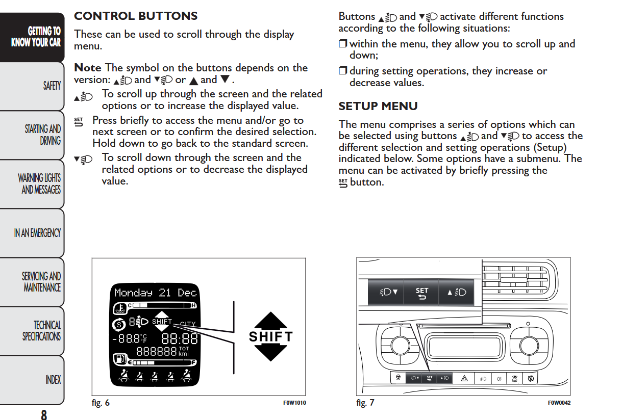

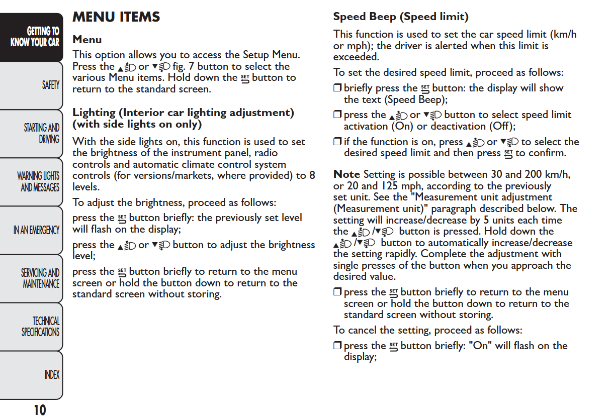

Hi all
Can anyone tell me how to brighten up my 2023 mild hybrid panda dashboard screen ? Struggling to see speedo etc !
It can be found on pages 8-10 of the owners manual - I don't know if the 1.0 mild hybrid handbook is different
If you don't have an owners manual, it's available to download here:
Again, this is for the older petrol & diesel versions, I don't know if there's a supplement or different handbook for the mild hybrid
