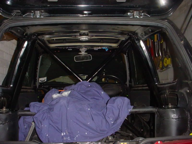

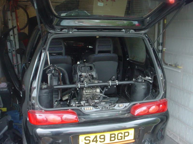

It hit a milestone yesterday with all the chassis welding done, was worried about the chassis strength so I put some more bracing in. Some tying the front and rear lower halves together more and some tying the rear lower and upper halves together. Feels a lot more rigid now so I'm happy with it.
before the extra braces were put in:
after:
quick peak under the bonnet:
