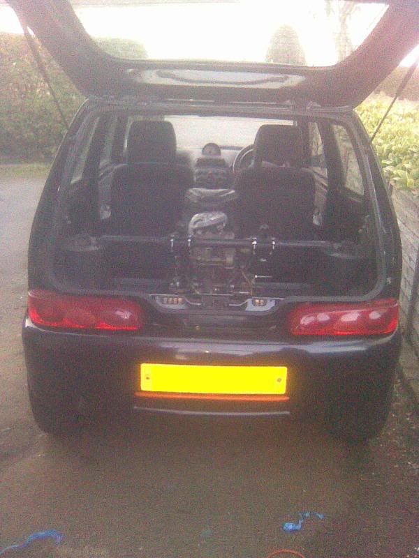

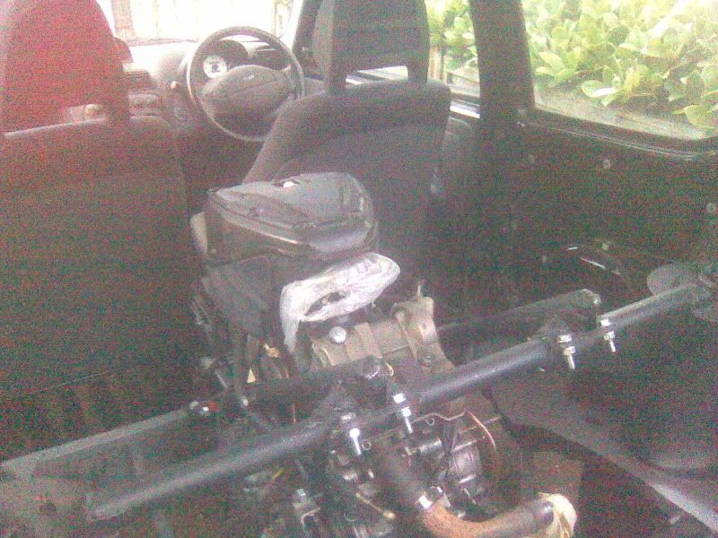

Rear suspension is actually cento front suspension. You can see the lower arms and the turrets in the photos with the engine in position.
Suspension wise it shouldn't be too bad if a little soft because its got the standard springs still and the bike engine with extra reversing bits should be close to the 1108 engines weight. The front will be a different matter entirely as it'll be about 70kg lighter and preload will be all over the shop too. I'll worry about that when I get it on the road though, I can then go shopping for some aftermarket shocks and springs to sort it out :D
There are a lot of scary bits from my perspective, suspension is only one of them :eek:
I'll have effective another set of steering arms on the rear so I'll be able to adjust toe. Camber and castor will be fixed. I've tried as best I can to build the rear matching the same setup as the front. I know car have different front rear setups to front. Ensuring negative camber on the rear might just mean some grinder/welder adjustment of the rear lower arm mounts. Castor I'm not desperately worried about as I can adjust toe to correct any crabbing and as the rear isn't steering I don't have to worry about it pulling beyond that.
