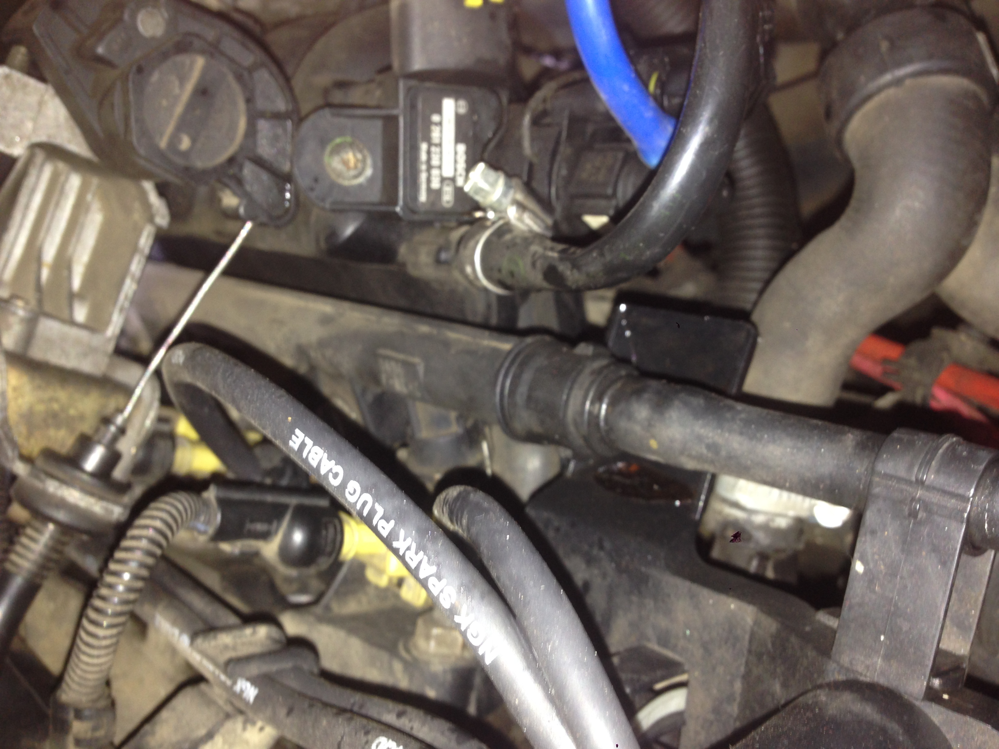

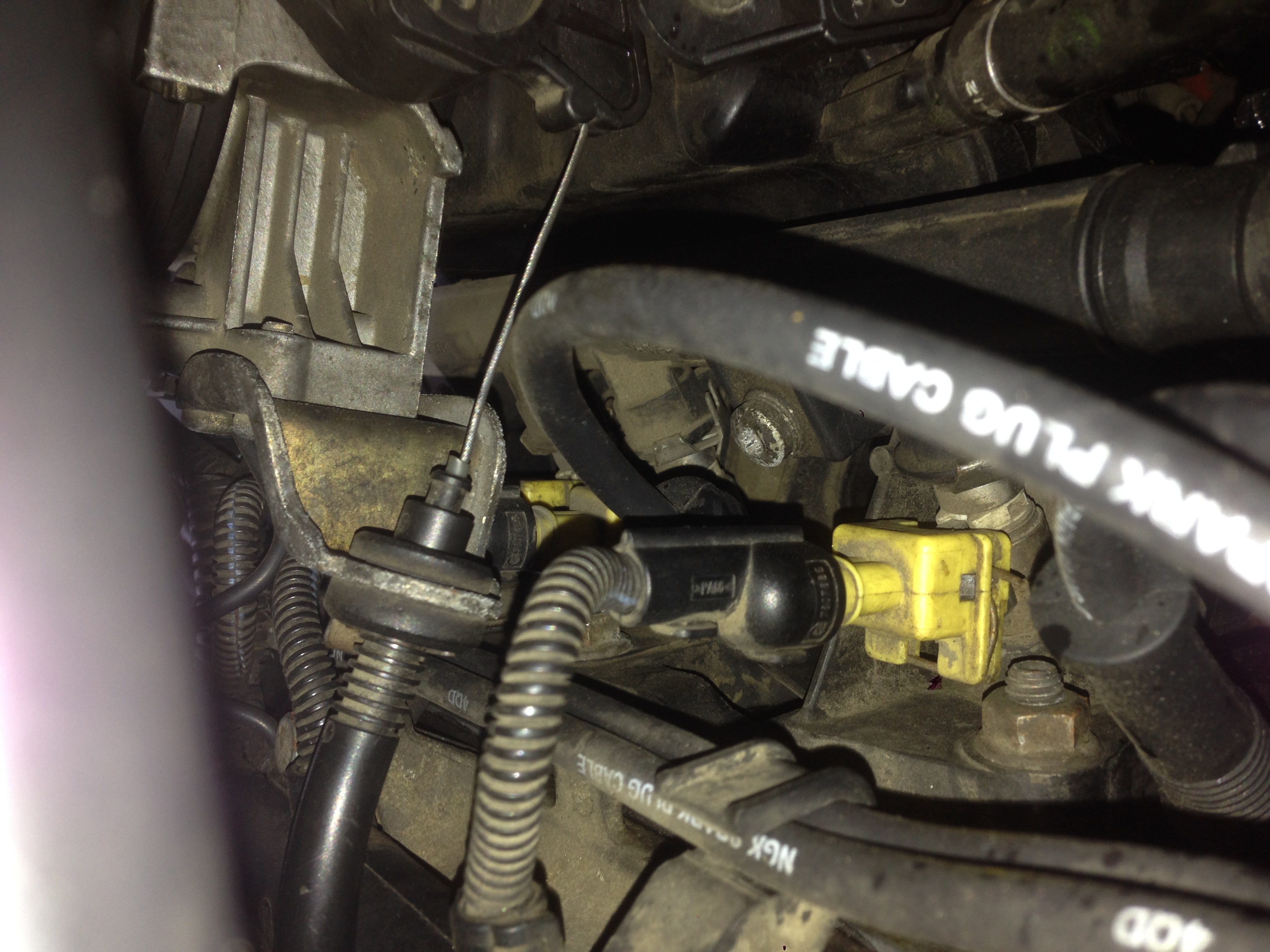

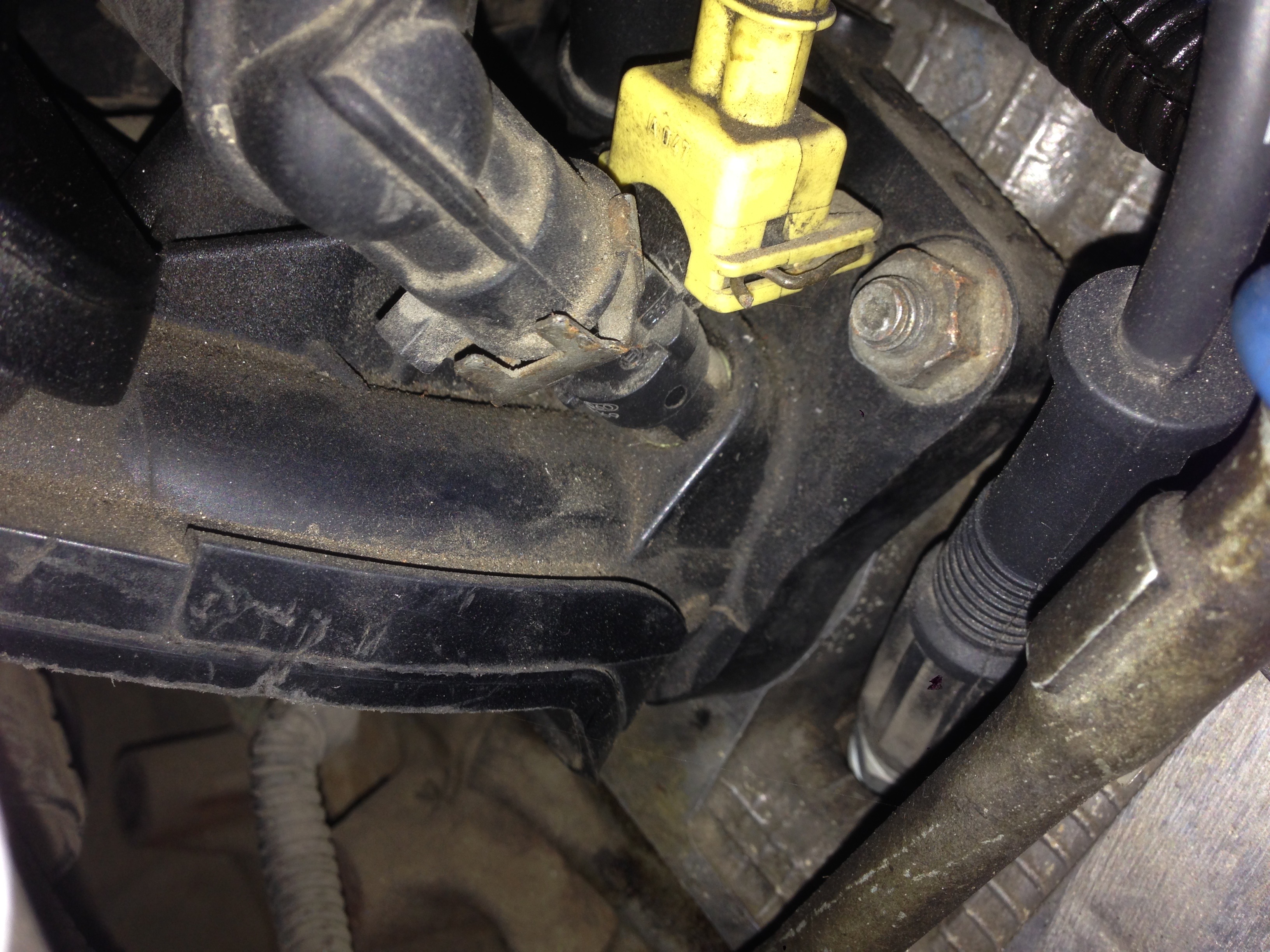

Here it is mate. The direct injection:
I didn't take down the intake air case due to the cold whether, if I would have you could see all 4 injectors. They are placed alongside engine, right near the spark plugs. But I took pictures from aside
In the first picture is the first injector that goes into the first cylinder. The yellow part is the injector's electrical connector and above is the injection rail valve underneath the cap. There you can measure the fuel injection pressure to make sure the fuel pump works well.
The second pic is from the other side, cylinder no. 4, same kind of injector and next pic is the fuel line in the middle connected to the injection rail.

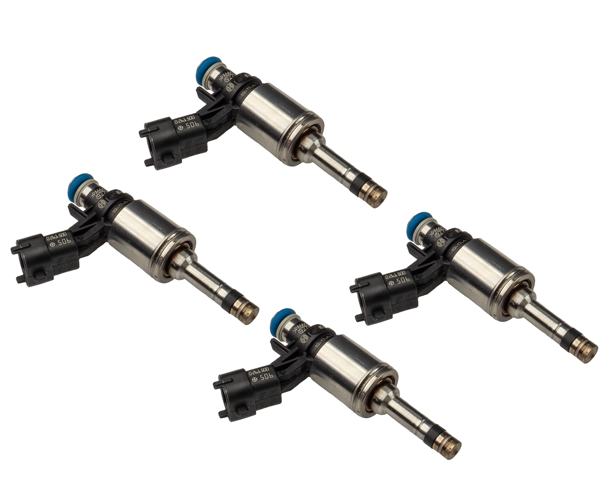

The 4th pic is the rail with injectors on it, it's not mine, I found this pic with an exact same rail.

No, it's inside the combustion chamber. The injectors pass trough the edge of manifold that is attached on the engine body.
And as you can see in the picture no. 4 above, the injectors have a little length, just exactly to reach the inside of combustion chamber. It's a really nice work that they have done, direct injection.

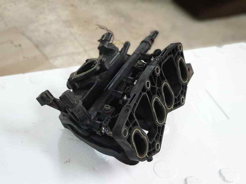

If you look at the inlet manifold picture I provided with the injectors fitted you can see the injectors do not pass out of the manifold. If you compare your injector rail picture with attached injectors, you can see there is very little length of injector after the electrical connection.
You can see in your pictures the injectors are going into the plastic manifold. That o ring at the end of the injector is right at the edge of the visible plastic manifold. It just sprays petrol into the air before it reaches the valves
Picture of gasoline direct injection injectors

Or, now that you've mentioned it, I think I got that wrong. My bad.
The injection do happens inside the inlet manifold and outside the combustion chamber and the mixture goes through the valves to reach the combustion chamber.
