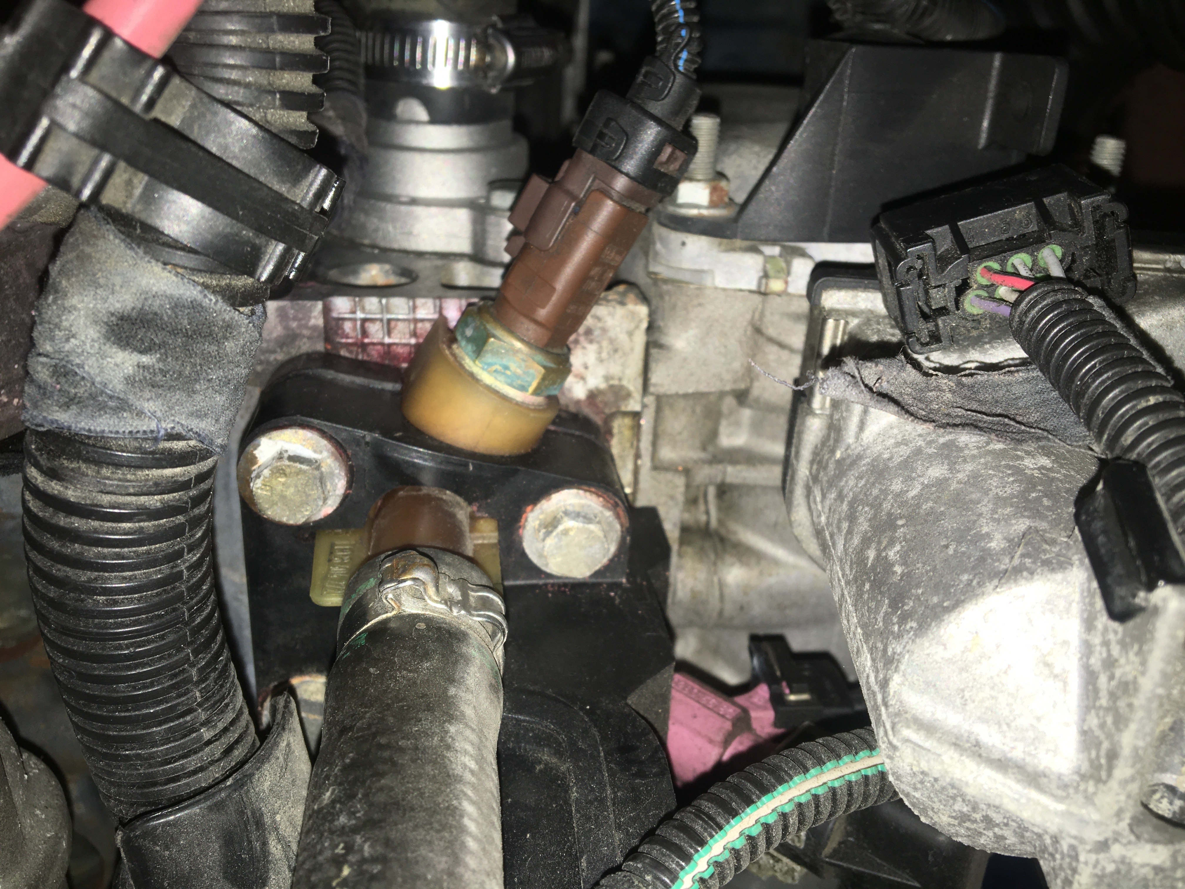

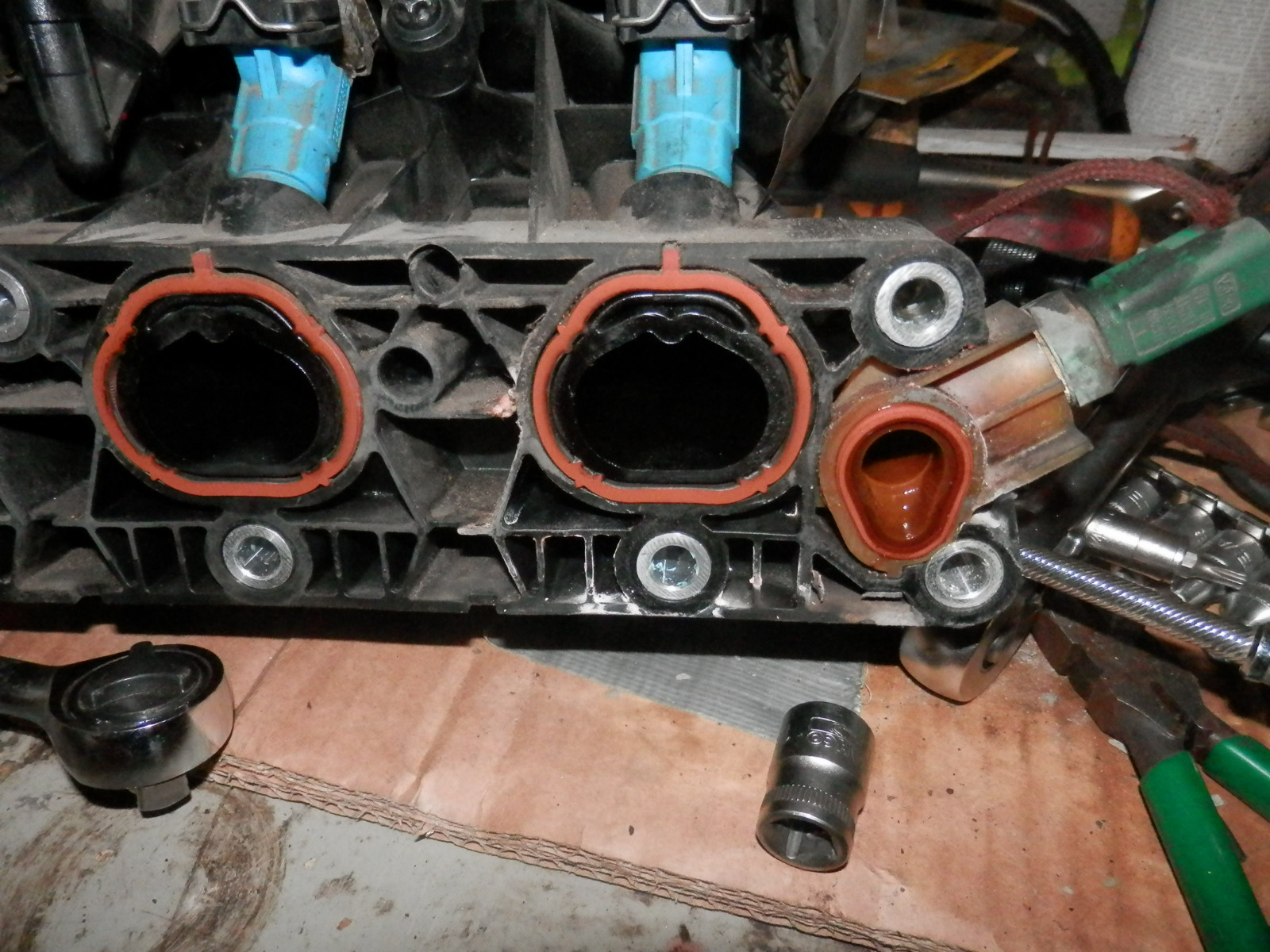

I started dismantling things and it is definitely a manifold off job. (hopefully the photo shows this). I tried tightening the manifold bolts near the housing but there was no movement at the highest force I was comfortable subjecting them to.

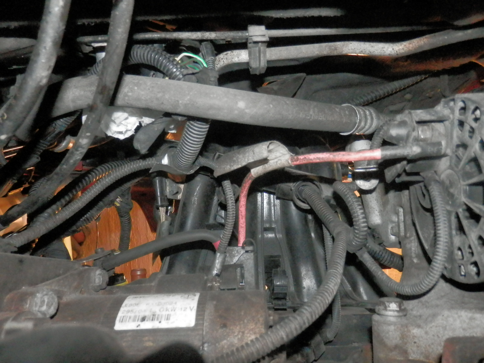

I had a look from underneath and can manage to access all the bolts holding it on, although I may have to remove the starter motor to gain better clearance.
I have ordered the part and some new manifold gaskets. The New Zealand Fiat agent quoted the equivalent of 125euro with a 6 week wait while they get sent from Italy!:eek:
Luckily I found someone else who had the parts in stock at a third of the price.(y)
When the parts turn up I will have to make the decision to proceed or not. I have used the opportunity to give the car an oil and filter change today. Will probably change the gearbox fluid tomorrow - a bit of routine maintenance whilst waiting for parts to arrive.

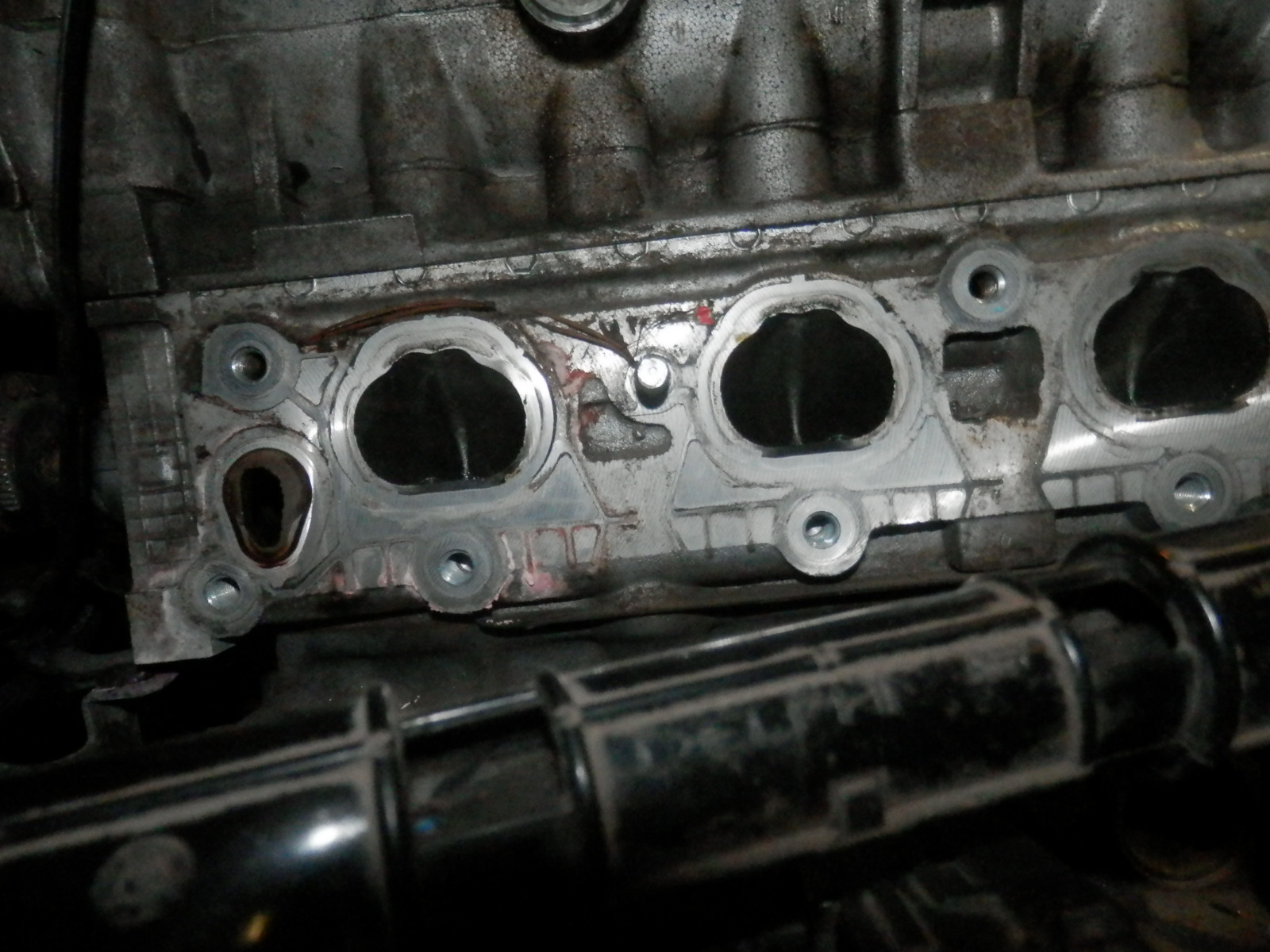

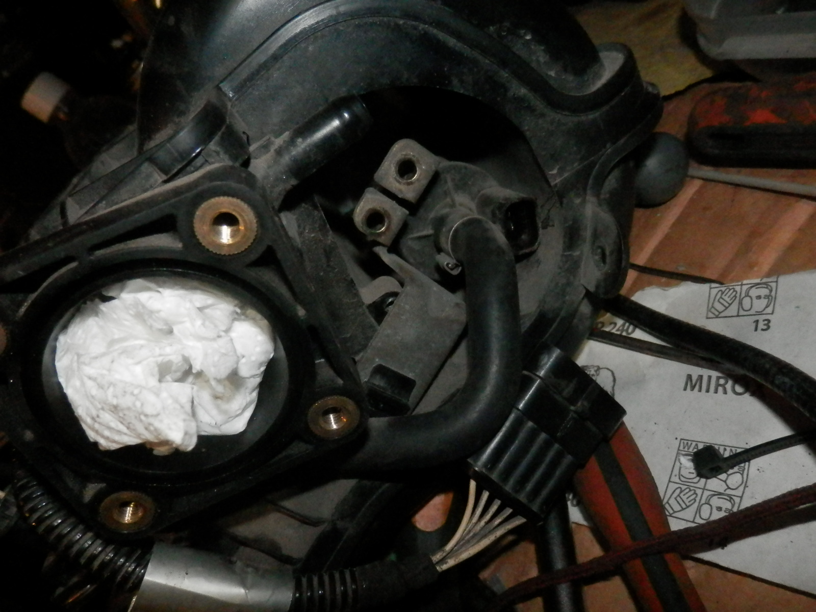

I replaced the gaskets. There was no water leak inside the manifold. The water must have been coming from the hose and travelling inside the housing. It was a very minor leak anyway.
I found it was totally impossible to do this job from under the car. I did however release the right hand electrics clip from under the car. I had to use a bracket to get the other clip off. It is just not possible to get your fingers in there.
When i started the car it ran terribly for about 1 minute and slowly got better. I was sure I had made a mistake but now it is running better than ever. i have had a flat spot on the accelerator since forever. Touch wood it has gone and I can even come up the steep hill from the main road to my house in third gear rather than first. Seems too good to be true however.
The metal surface to my throttle body was worn by the seal so I sanded that out. There was a minor air leak in one gasket judging by the dirt. But otherwise neither the engine or the manifold needed cleaning other than a determined wipe with an oiled rag. the water connection was perfectly clean.

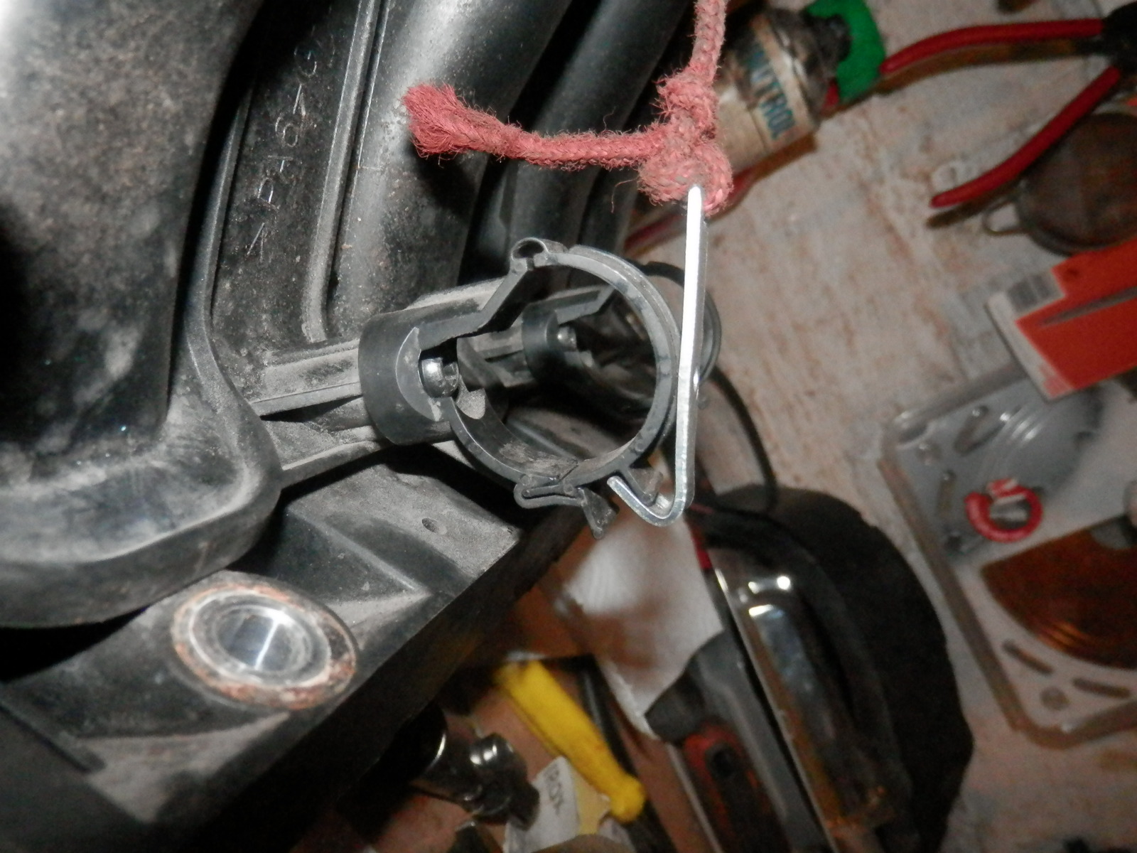

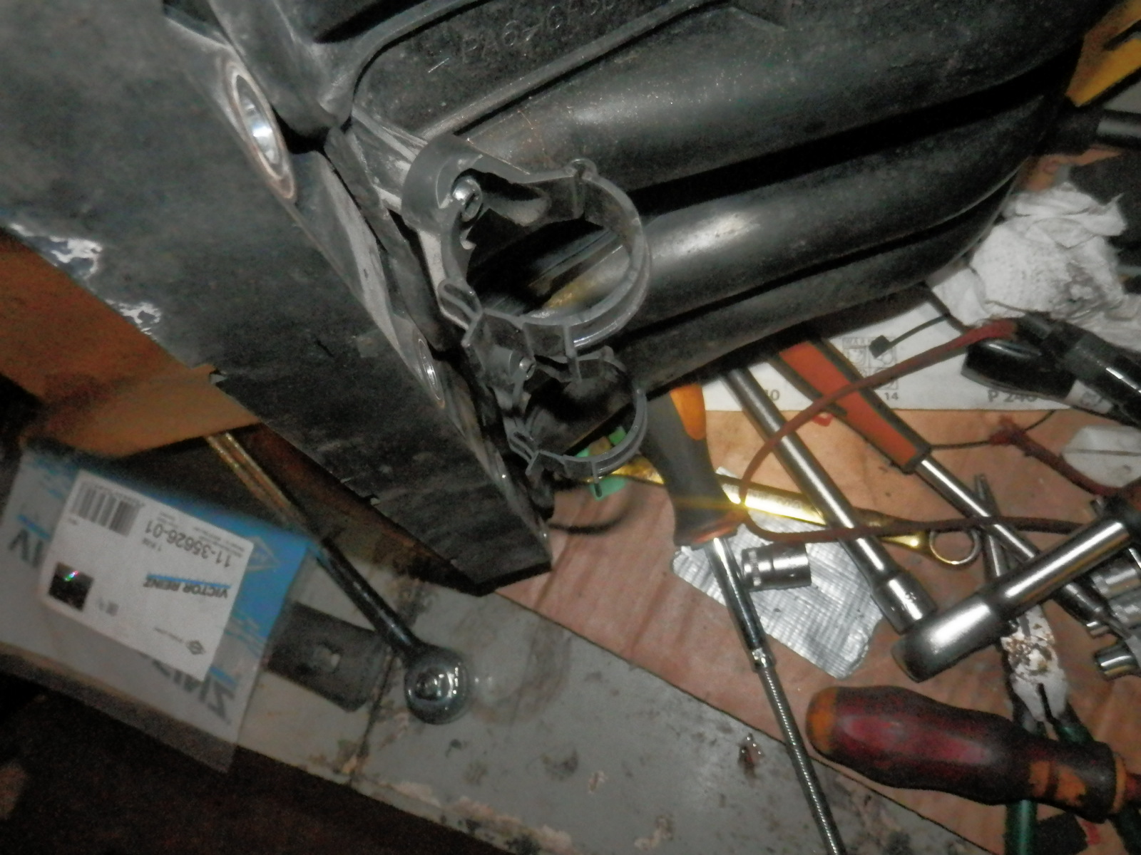

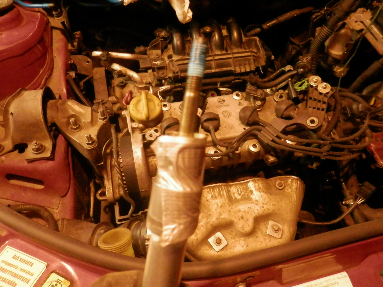

Taking the manifold off is a bit of a mission. To do the work from the top I took everything off the manifold that could get in the way. the quick release petrol connections are undone by pressing the tabs and pulling very hard on the pipe away from the connector. Taking the mass air flow sensor off is a good idea but i left it in and moved the connection sideways and pulled it off. I took off the inertia? sensor on the wing and the earth on the compressor plus released the crank sensor cable from the cover so i could get as much play in the electrics as possible. i also unclipped the electrics at the battery end by the manifold. There is almost no room to move so you need to get as much out of the way as you can.
The middle top bolt is right next to the petrol connector which makes it easier to get the socket on it as you can clearly see it from above. Most of the bolts are relatively easy to feel by hand but it took me for ever to get them all undone. There is one above the starter solenoid I was using an endoscope on. if you have somebody to help you it would be a good idea to mark the inlet manifold so you can see where this bolt is from below and get your mate to help you line the socket up. it is just impossible to get your finger in there to find the hole and put the socket in at the same time.
My technique for the invisible bolts was to hold the socket extension in my left hand and feel for the bolt with a finger from my right hand. But this did not work for a bolt above the solenoid. I used the endoscope with the bolt taped to the socket and pulled the socket off before fully tightened. I used tape for a few of the bolts.
You will need to redo the loctite on the manifold bolts as you cannot get a torque wrench in there and they are only 15nm and you just have to do it reasonably tight without destroying the aluminium threads.

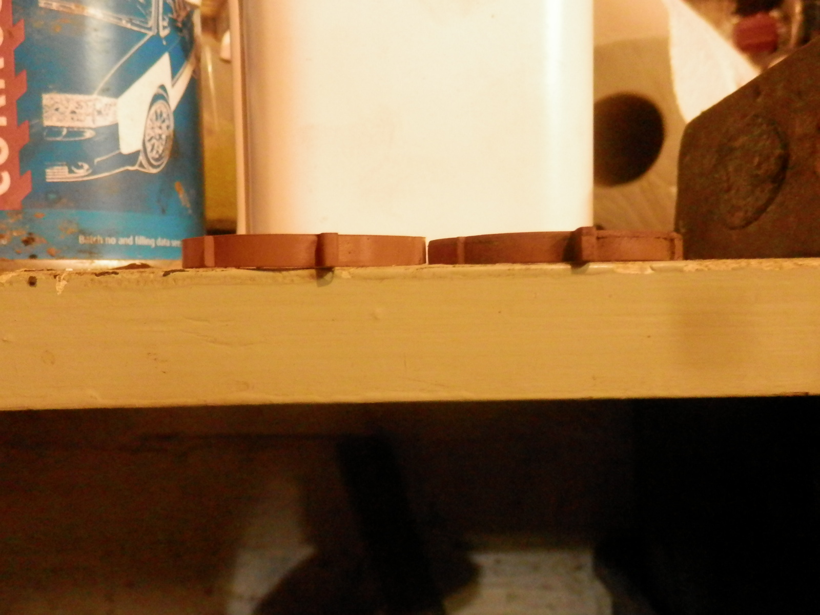

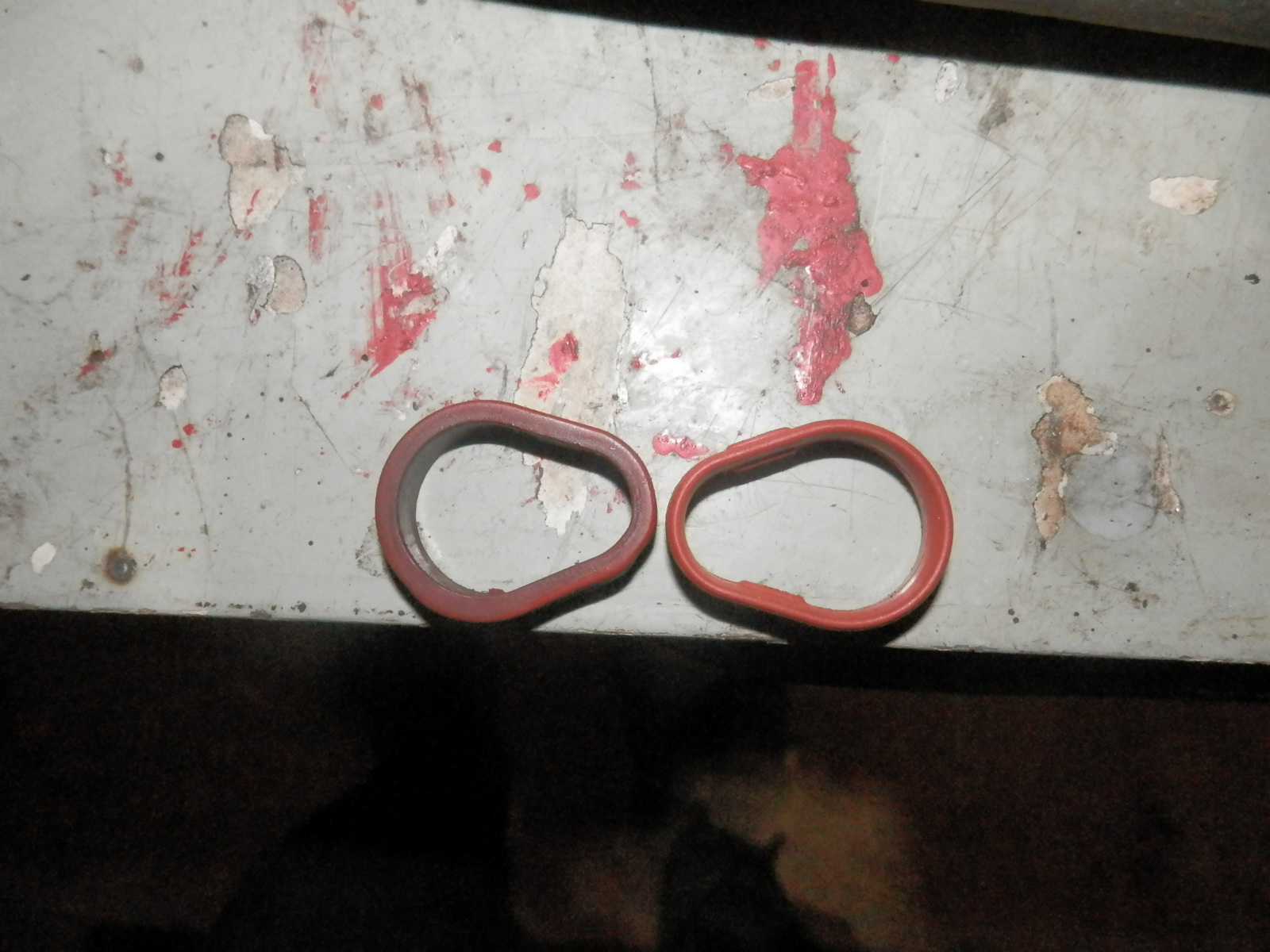

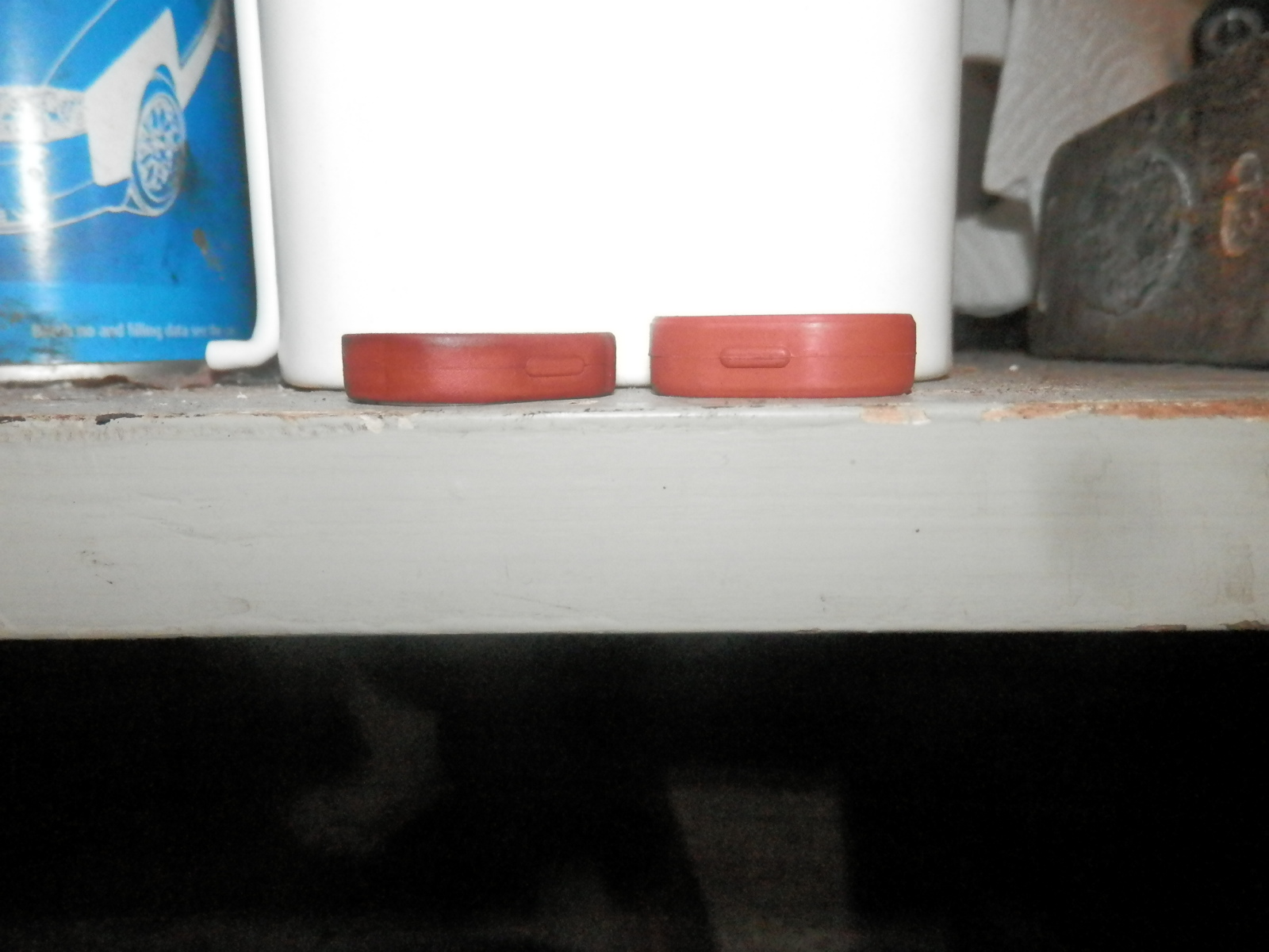

There were the 4 inlet seals to the engine and the sensor housing seal to the engine. The packet came with the throttle body seal which I also replaced.
The seals were still flexible. Even though my inlet manifold bracket to the top of the engine was cut off about 2009 the manifold is still fine.
