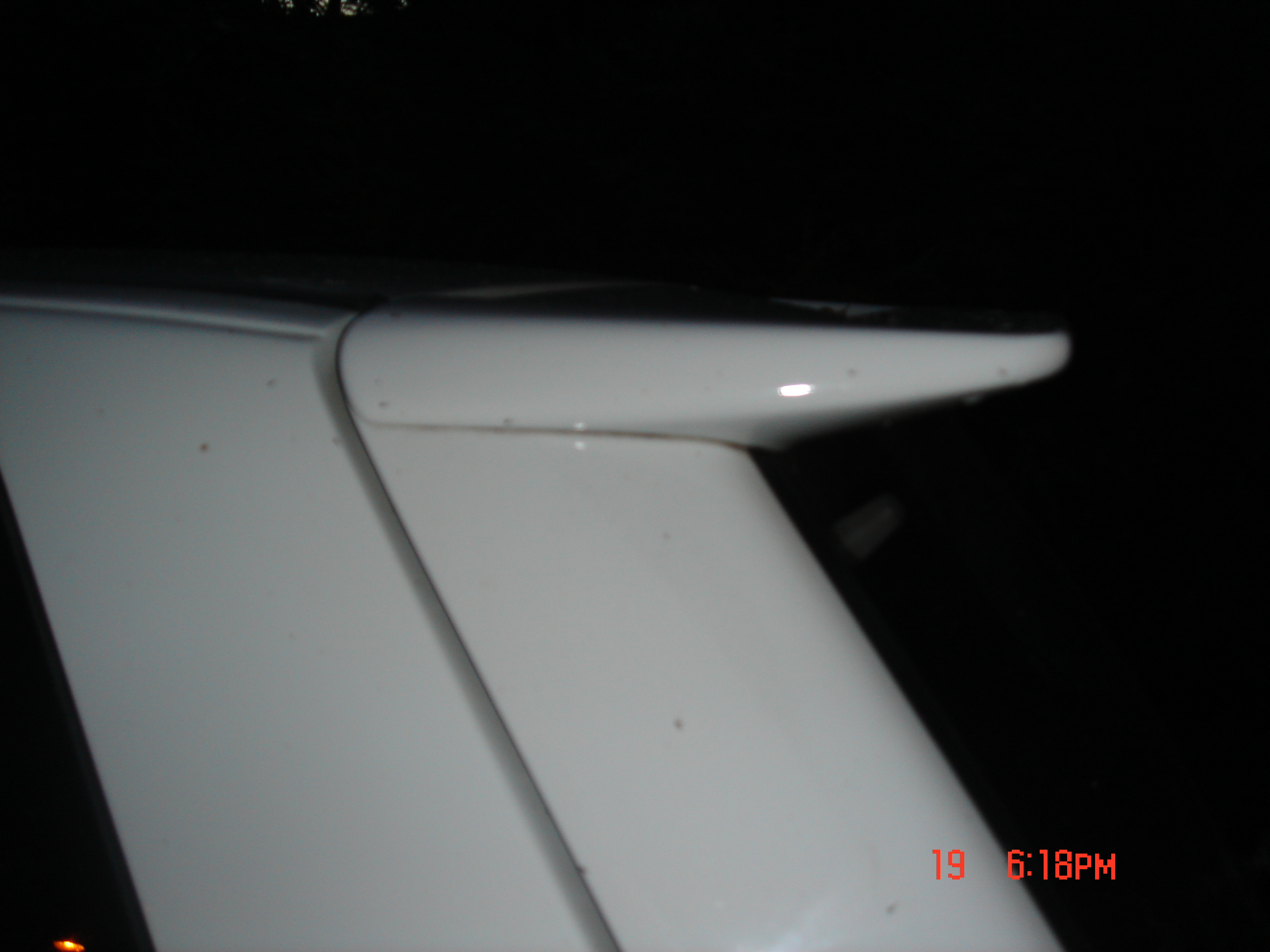

ive just bought one myself, i am completely new to tigerseal etc, im not sure how much to use or anything, if anyone could give me a few pointers i would appreciate it, thanks :)
the punto spoilers are bonded on at the dealers and thats all, First trial fit it and make a few markers for refitting (pen and masking tape) then lightly rub the part of the spoiler that will fixed to the glass with a bit of rough sandpaper, and clean both parts to be bonded thoroughly, i use panel wipe
then put a bead of sealer all the way around the edge of the spoiler about 1cm in, and 4 or 5 blobs in the middle, its also helpful to have an assistant to help you alighn, then fix to the car, press it onto the glass firmly, clean any excess using the panel wipe and cloth, (spirit wipe, turps etc, but non oily!)
and fix in place with a strong tape, i use masking or gaffer tape, then leave overnight until you remove the tape, dont forget the temperature will have a lot to do with the curing time of the sealer, when i did the uno spoiler, on a cold day, i used a hairdryer inside the car (fixed in place) aimed at the area for quite a while, to help! and alls well!! good luck! Ant!

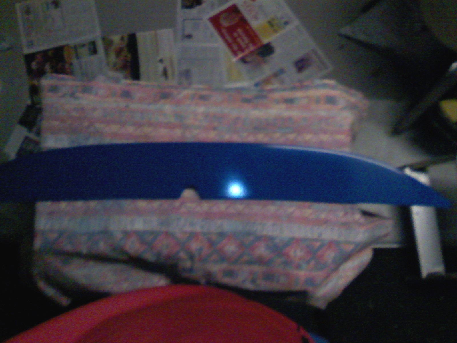

Right here it is finished:

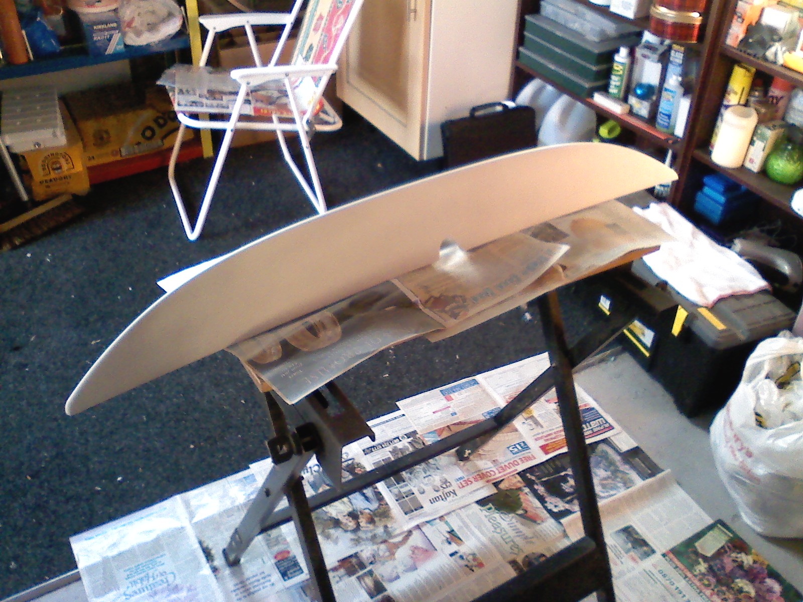

Sanded down and Primed:
Sprayed:

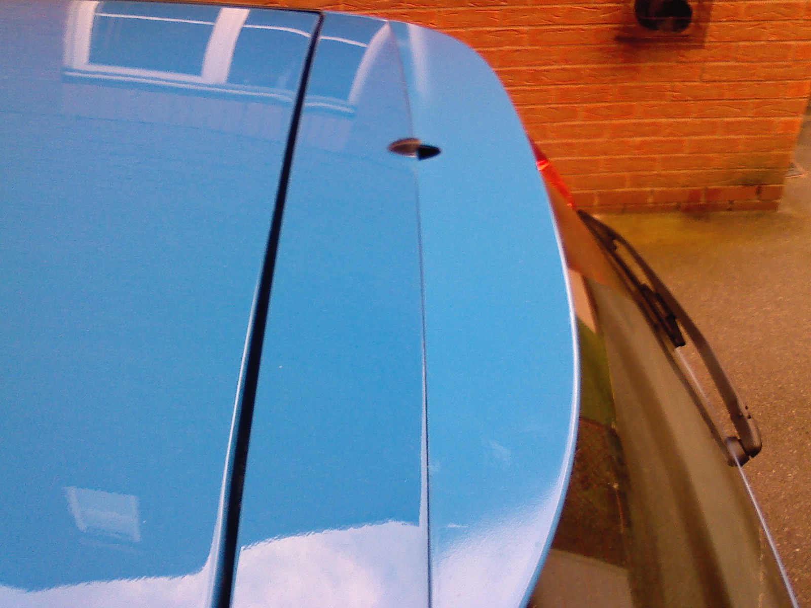

Attached to car:

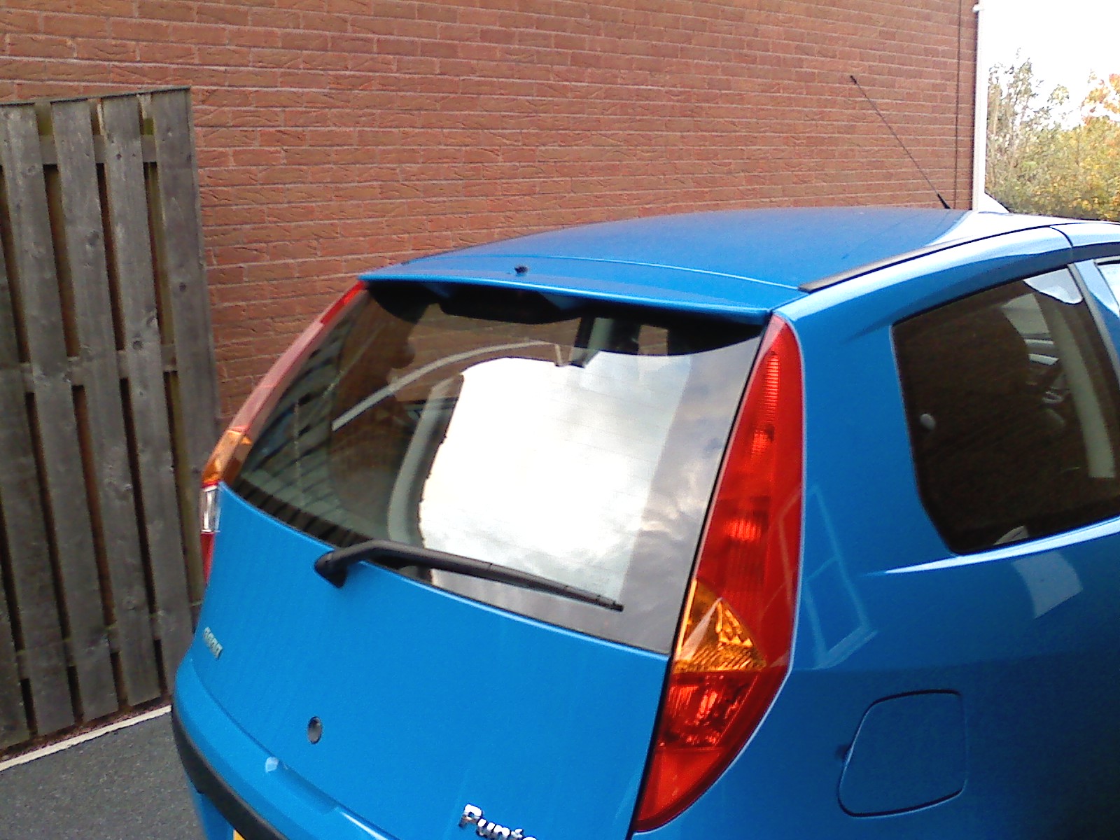

Finished!
The Join: (the colour match isn't actually bas like it looks in the pic ;)
Not a bad effort for my first ever attempt at this :D
