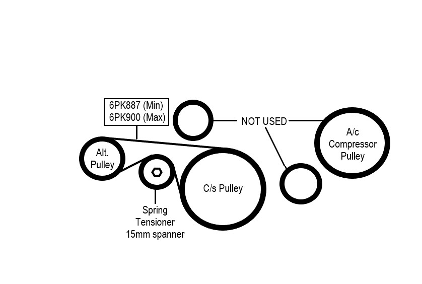

Bypassed the A/c compressor on one of my Stilo JTD 8 valve engines. If that is the engine you have, you need a 6PK887 belt. Route diagram is below.
