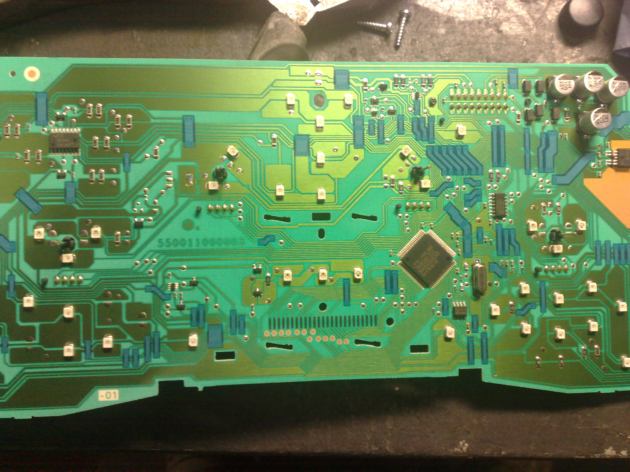

done my mk2b was similar but with less LEDs nice and easy mod that is probably my favourite so far.
Heres the mk2b PCB for anybody who needs it
RED = Dials Colour
BLUE = Needle Colour
YELLOW = LCD Colour
For anyone needing soldering help best way is a fine tipped soldering iron with low wattage 25W max
take note of polarity indicator on LED
then bathe one side in solder then the other side
then heat up both sides quickly and old LED will float off
then use some desolder braid or a solder sucker and remove old solder
place new LED with polarity indicator in same place and solder in
hopefully with time and patience you get
Bang Tidy !!! :D

so the needles DONT have to come off?
This is the only thing stopping me tbh.
Deekstar
Deekstar
Patron member
Parked in the garage
Jul 19, 2010
150
28
  • Oct 30, 2010
  • #57
yeah had to take them off to dismantle cluster, but they easy enough to mark fuel temp gauge and then put back on may need some realignment but got mine bang on in 15 mins was the rev counter that was tricky kept sticking at 2000 revs then dropping below 0 lol but a few turns sorted them out.

"For anyone needing soldering help best way is a fine tipped soldering iron with low wattage 25W max"
Hi mate, is there a way if to fixing the LEDs without the soldering are there any pop in/out smds available anywhere?
Thanks,
Deekstar
Deekstar
Patron member
Jul 19, 2010
150
28
  • Dec 1, 2010
  • #59
sadly no they are surface mount leds that need desoldered and then new ones soldered its not that hard 2 do fiddly but not terribly hard just need a bit of patience and some tweezers
