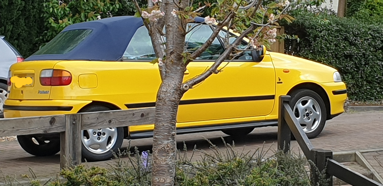

The car in question - hopefully I can link a pic now :)
