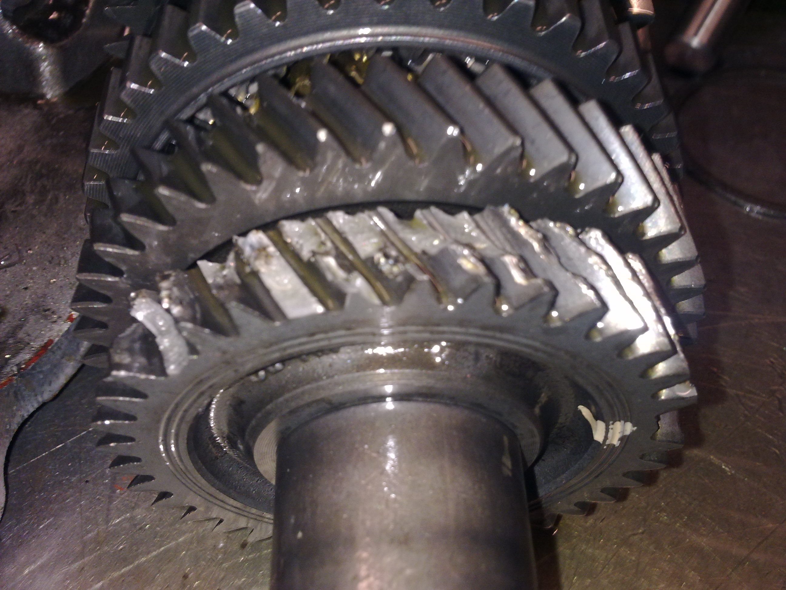

This is an experimental double neutral gearbox :D The second one is placed between 2nd e 4th gear :bang:
