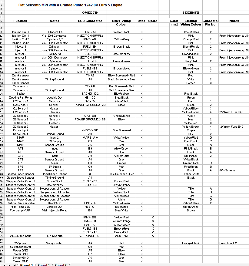

I think you could actually be right, so don't give in so easily ;). What we are missing here is that the MPI Seis (both ECUs) have two plugs. One of these plugs has the engine bay loom attached to it and that has a sort of D4 connector. The other plug has - thats the question - I am not sure how to call this loom and I am not sure how it connected / interfaced to the rest of the car. In any case, all ignition feeds, immo lines, diagnostics lines, etc. go through it, many of them ending up in the cabin, and I have no clue how they are connected. I have the remains of the complete MPI loom in my basement, but pardon me, I will not go to check.
I have a Bin file from my MF59/M1 Ecu but can do nothing with it.
With reference to the D4 Mpi connecter:
May help some?
