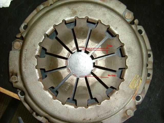

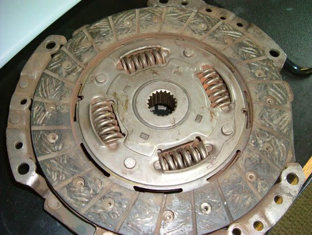

Lets hope I can get my money back from MrClutch see pictures of the removed clutch below
Notice the wear on the inside diameter of the clutch plate and notice the ring where the thrust bearing has been engaging indicating it is not seated correctly in the centre.
