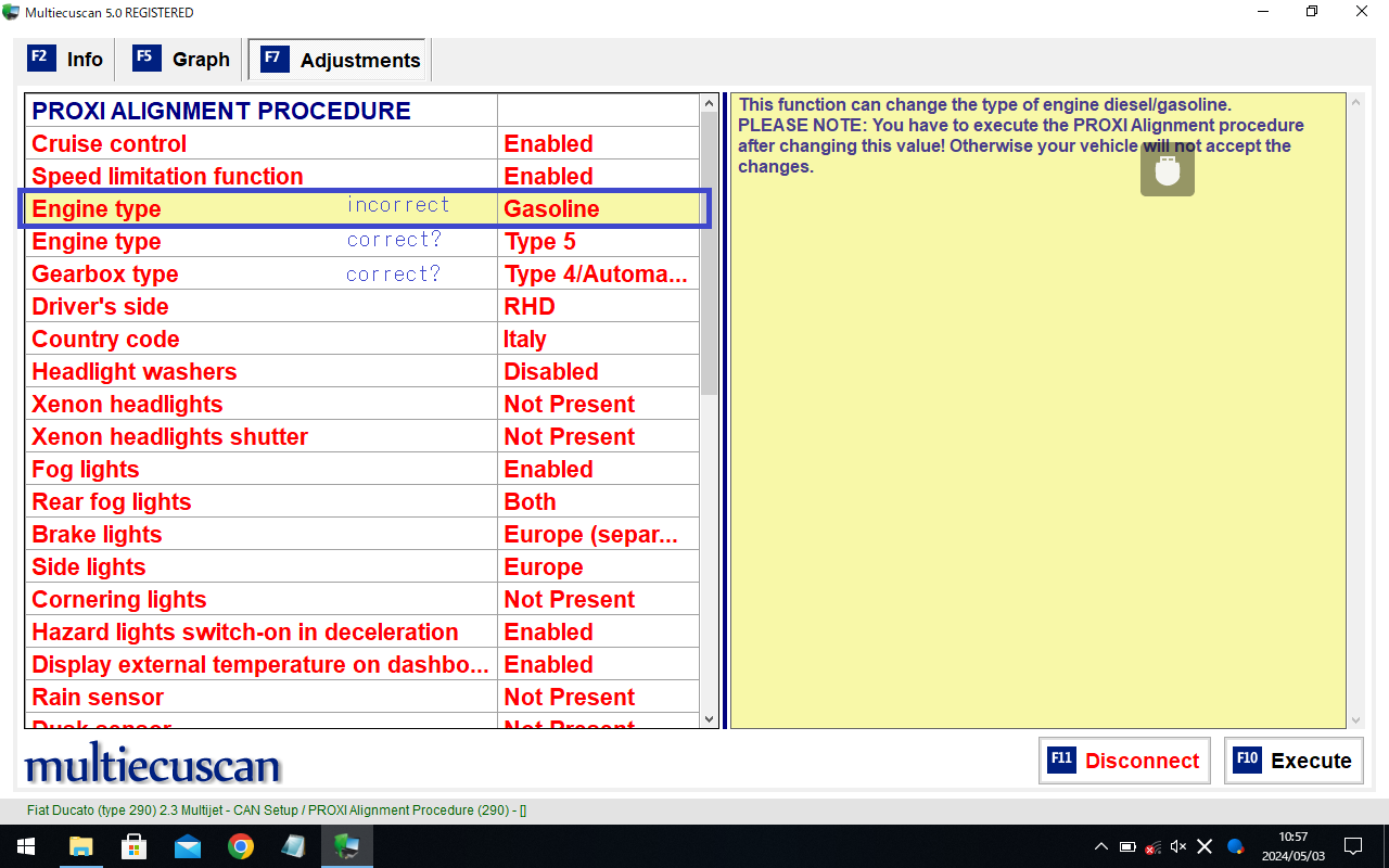

I'll try Proxi Alignment using MES after AirBag EUC replacement.
My Ducato(type290) is Diesel 2.3 Multi Jet 2016 and Dualogic AT.
When back up the Proxy file before replacing parts, I noticed something strange in the display.
The engine type is gasoline.
It's actually a diesel engine.
I can't say anything about other items, Is the engine type correct?
If I execute a Proxi Alignment like this, Will it be rewritten with incorrect information?
Do I have to change anything?

No need to change anything.
its one of the Peculiarities of Fiat/MES.
I found the same and a long time ago i too was worried but no problem. i cant find the original thread telling me it was ok but it is ok.
