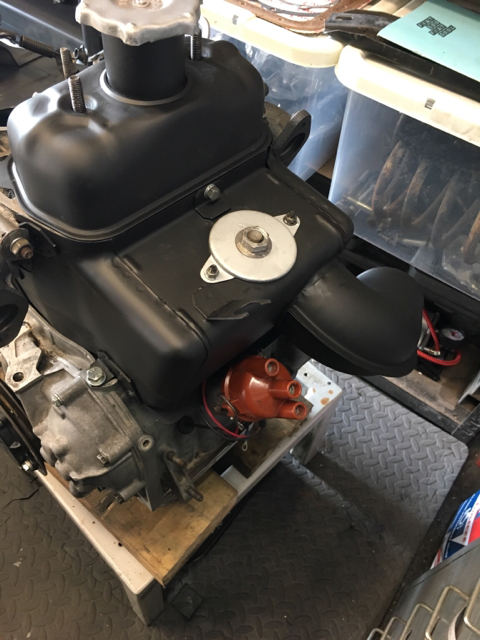

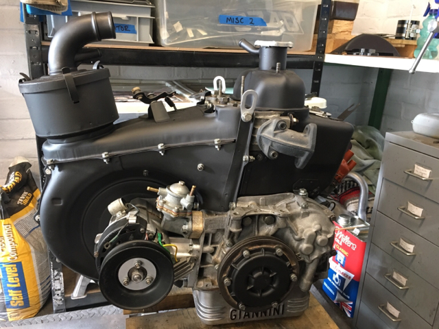

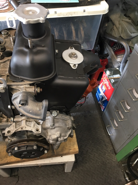

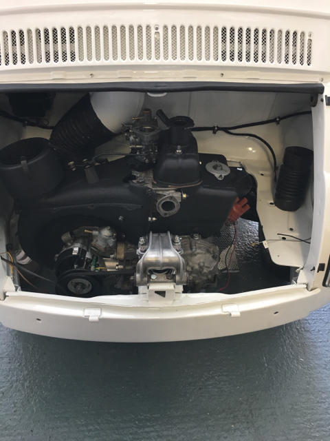

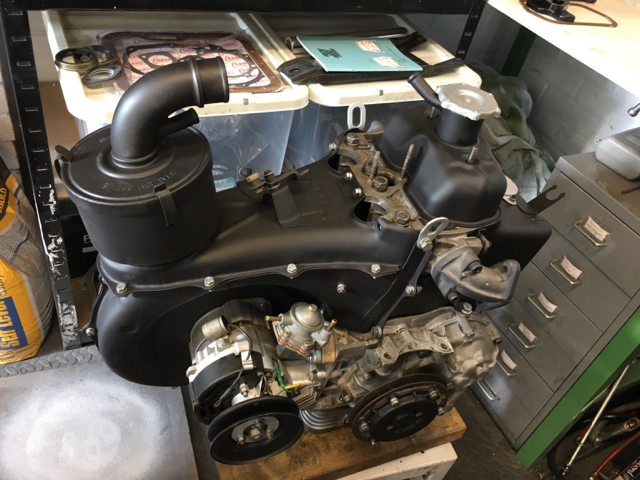

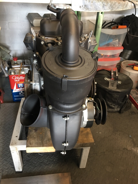

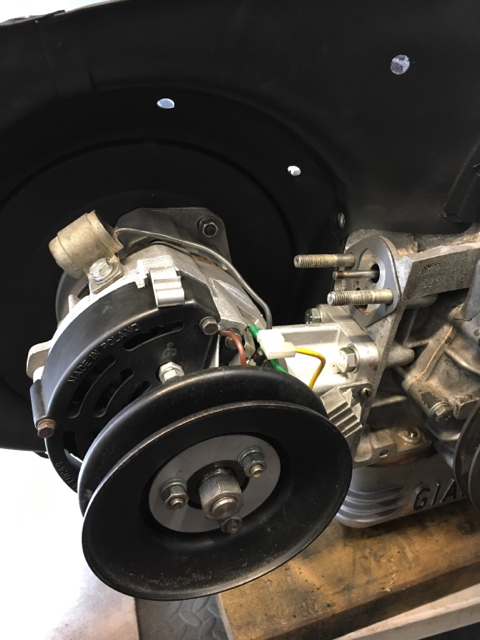

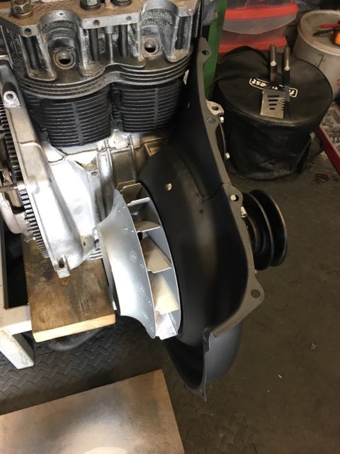

Damian have you sprayed the fan as well?
Yes. It wasnt particulary dirty and of course you cant see it when the engines in but I know that its all clean now
Nice paint job it looks like the sort of paint they use on stealth bombers!
I tried to get that colour a while ago Damian, but all they had left was white or a vivid, lime-green gloss. I have a can of the green but wasn't brave enough to use it. I used Plastikote matt black but didn't achieve your high standard.I'm happy with it Tony. I like the shade and finish. Its high temp and cost £2.50 a tin from Lidl! Bargain
I'm....doing a few paint repairs whilst it's hot and dryI eagerly await the lime green engine.![]()

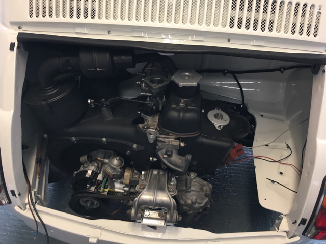

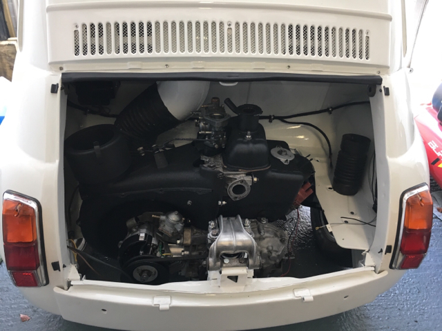

So close now Damian.
It's of no use to you now as you've managed to get the engine in but a trick I've used many times, if an old input shaft isn't to hand, is to make a clutch alignment tool from an old piece of dowel or a bolt wrapped with tape until it's the right size. As you've, unfortunately, just found out it can be a real bu**er to align by eye![]()
The first attempt I used a dowel and thought I had it correct but you need a dowel with two different diameters, one for the crank bush and one for the splines. When I couldnt get the engine in I decided to use what we used to call in the RAF my Mk1 engineers eye. This worked a treat, nice to know that almost 20 years after leaving the RAF, my engineers eye is still calibrated. Even if it does need glasses as I get older!
I have met you both, and wondered why you both had a special eye
Another little trick that I learned (due mainly to not always having the correct tools!) is to line the clutch as best possible (by eye?), but leave the pressure plate bolts only just tight. This way, the clutch centre palate can still move enough to 'self-align'. You will have to go underneath anyway to fit and secure the gear-box 'under flywheel' tray, so you also use that position to finally tighten up the shield bolts (3 x 6mm).![]()
