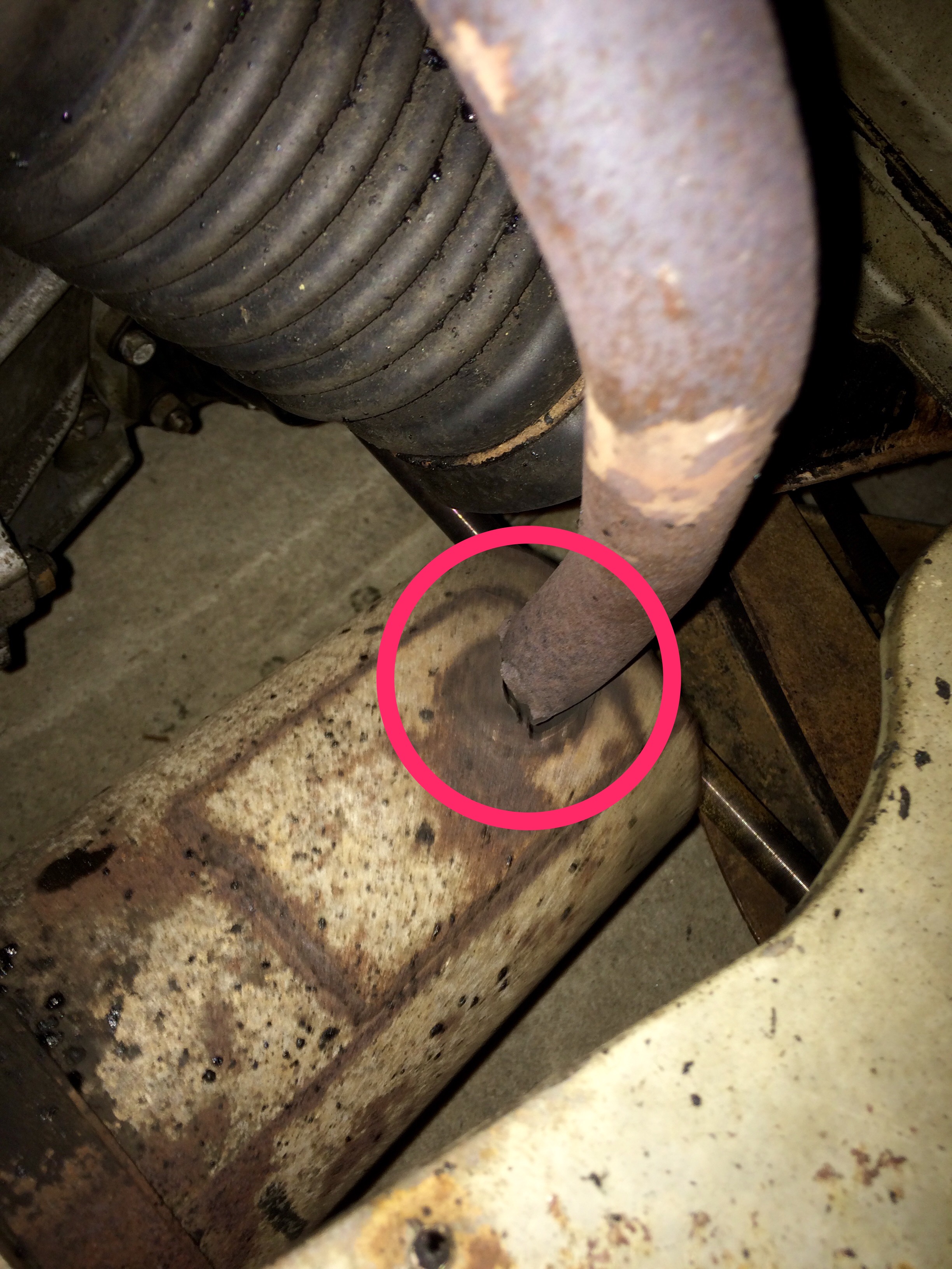

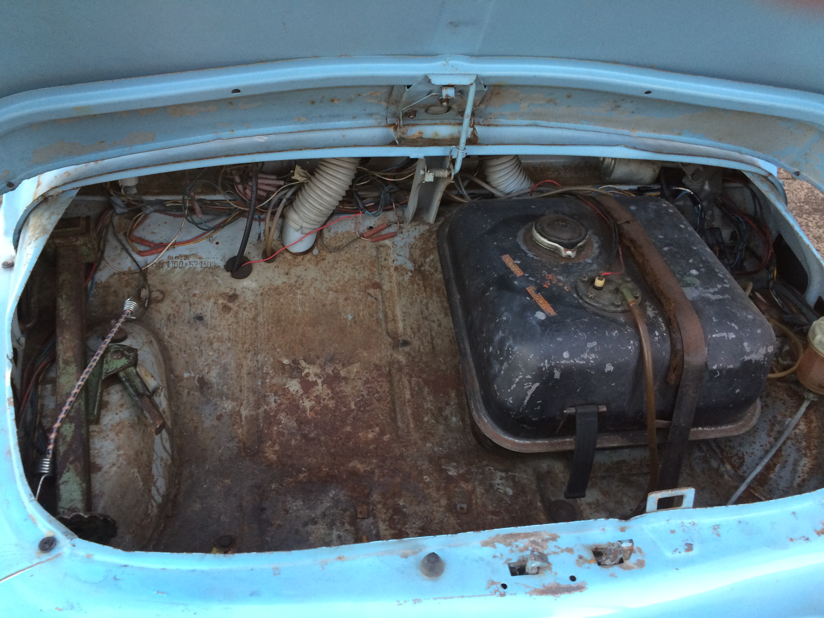

Argh. Poking around and...
Well this could be the cause of the putt putt at idle / roaring sound at speed. I assume this would have a definite impact on performance.
A pretty significant crack there, clearly a weak point as the muffler seems to hang at that point and cause stress on the join when bouncing.
I could get it welded perhaps but I'm wondering if anyone in Aus knows a good supplier for the exhaust locally and I should try for a new one? I fear that shipping an exhaust from one of the European suppliers would cost a mint.

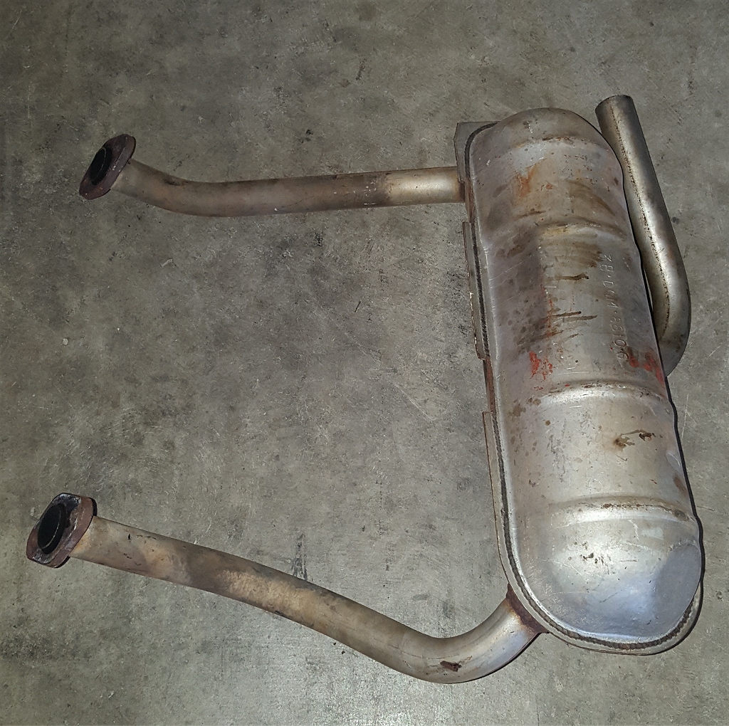

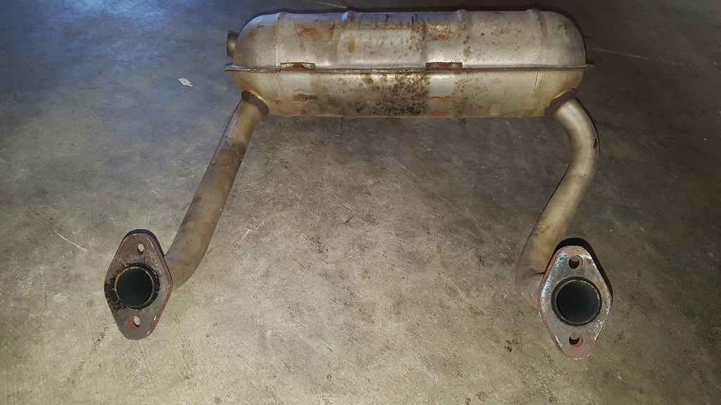

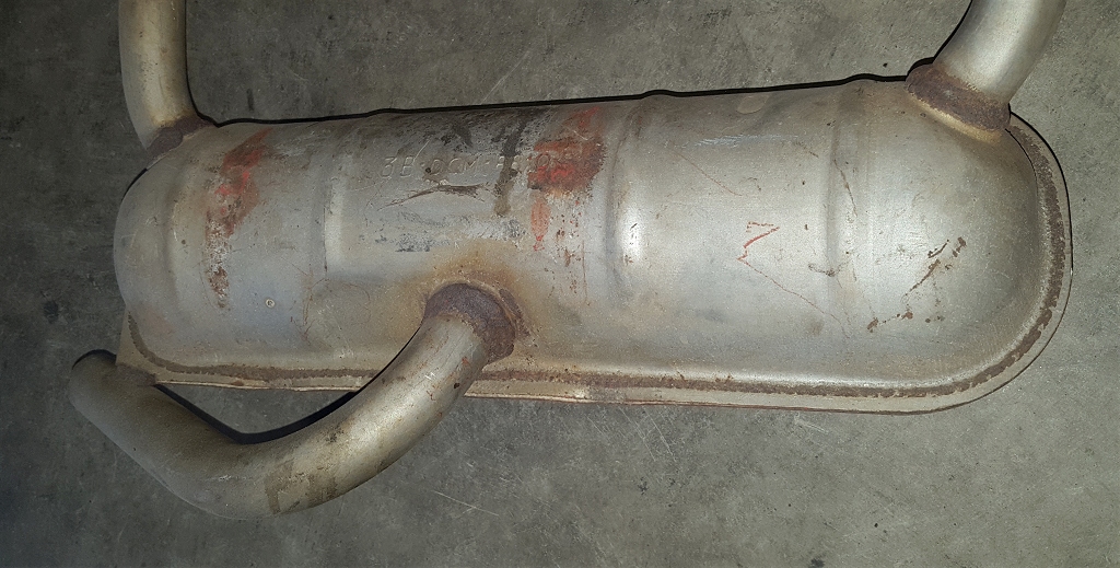

When I replaced my original engine with a 650(695) I kept all of the parts. I still have the exhaust which I think is OK. I don't know for sure because the original engine was basically worn out and never ran.
My car is a 500F and if someone can tell me whether the exhaust is the same as a 500D, you can have it.

Hard to tell as Ricambio sells them as interchangeable between the models, as does Axel, but passione sells a D/N specific one. Though it looks like they might still fit in the same spots where it matters.
D&F exhausts are interchangeable....
if you wanted to be picky N&D exhausts are different, the main box is actually cylindrical rather than the later pressed design, it makes little difference to performance...

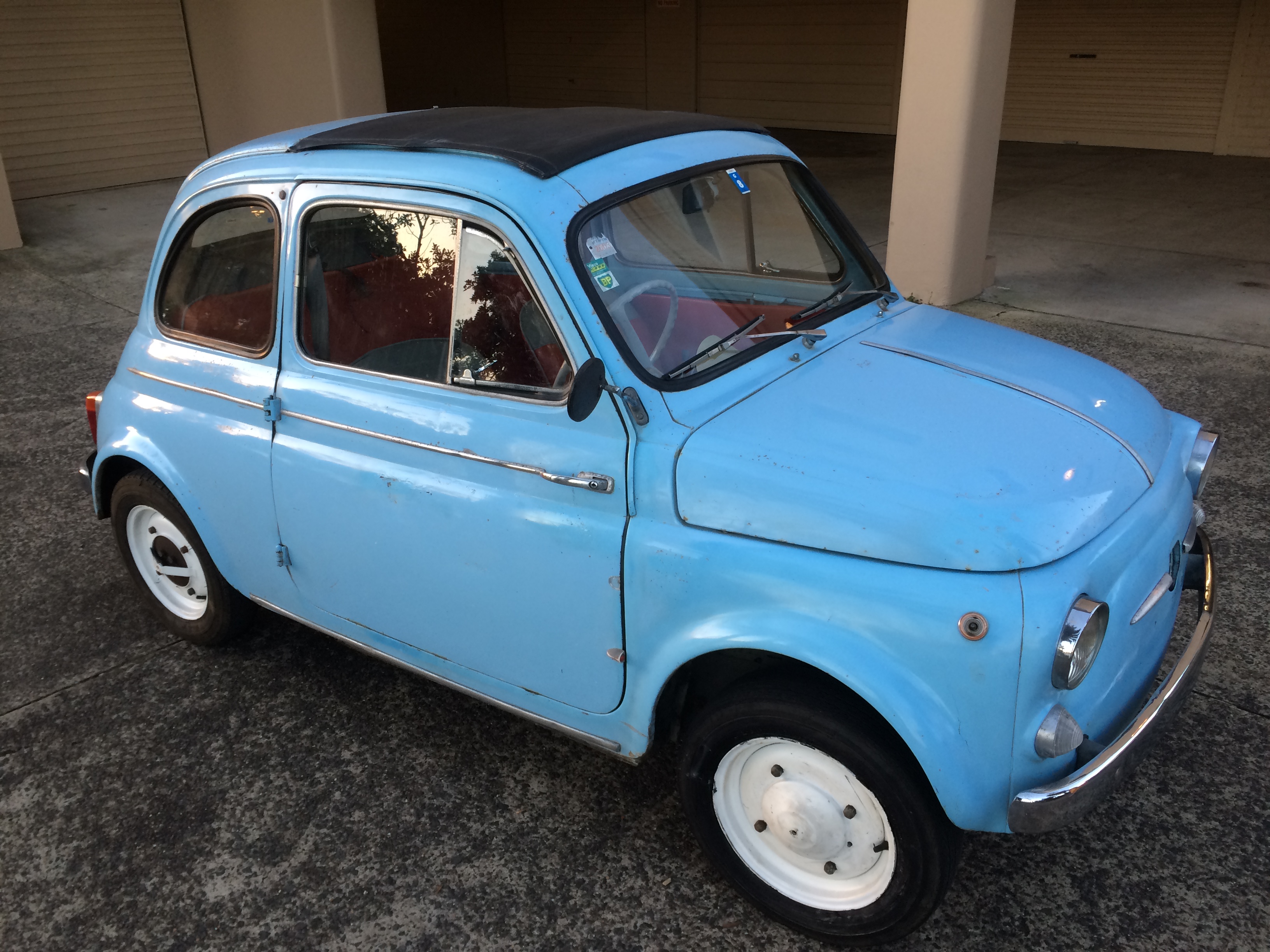

Hope no one minds me adding some pics as she is now, in the hope that a transformation occurs somewhere along this thread. There's a few things to do!

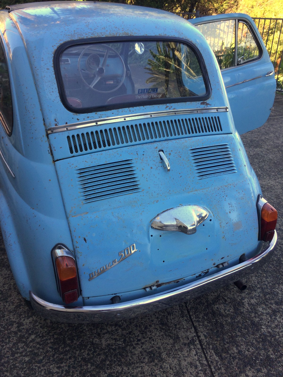

What a bit of elbow grease can do!
First pic is as she arrived. My wife was a little concerned at what I'd bought into... "soooo, how much did you pay for this?"
A solid afternoon and she looks a world better. Thanks to bigvtwin96 for convincing me that the chrome work wasn't a lost cause.
Managed to knock the bumper back into shape and some metal polish and a couple of hours later all the chrome on the back looks great. Not new but pretty tidy.
Plan is now to do the same to all the door handles and the chrome strips down the side and bonnet - I could replace them with new pretty cheaply but then they would clash with the patina I've got going on with the paint! ...question is are they easily removed for polishing?

I think strips and door handles tail light surrounds and number plate light are aluminium so if you buy autosol aluminium polish they will come up like new. You might get away with not removing them. I didn't need to. They go black while the polish is going on but a buff with a clean cloth brings out the shine.
