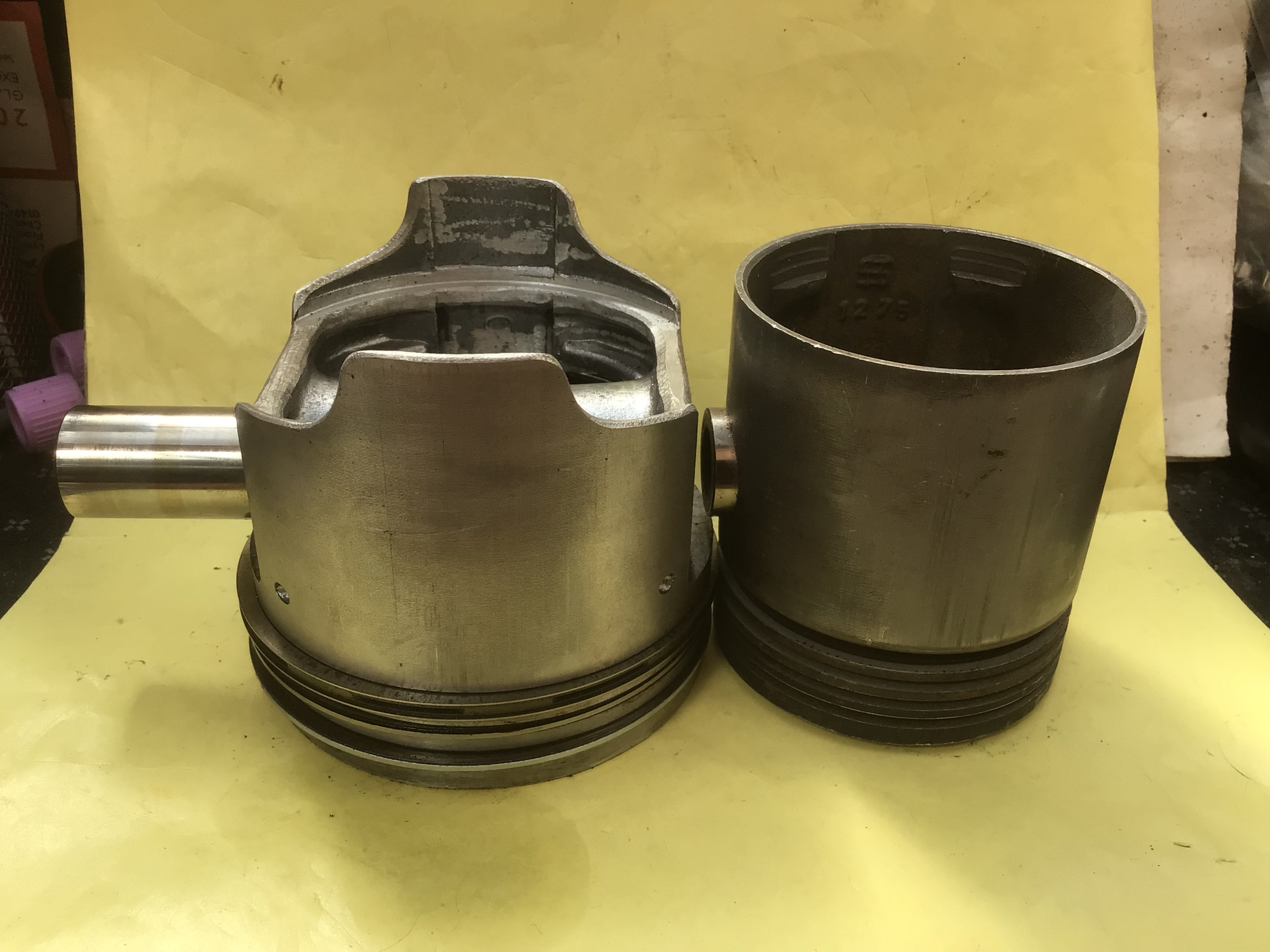

Just working on another rare historic 795cc Alquati engine (85mm bore) and happened to have a 499cc piston on my table so took a picture for comparison.

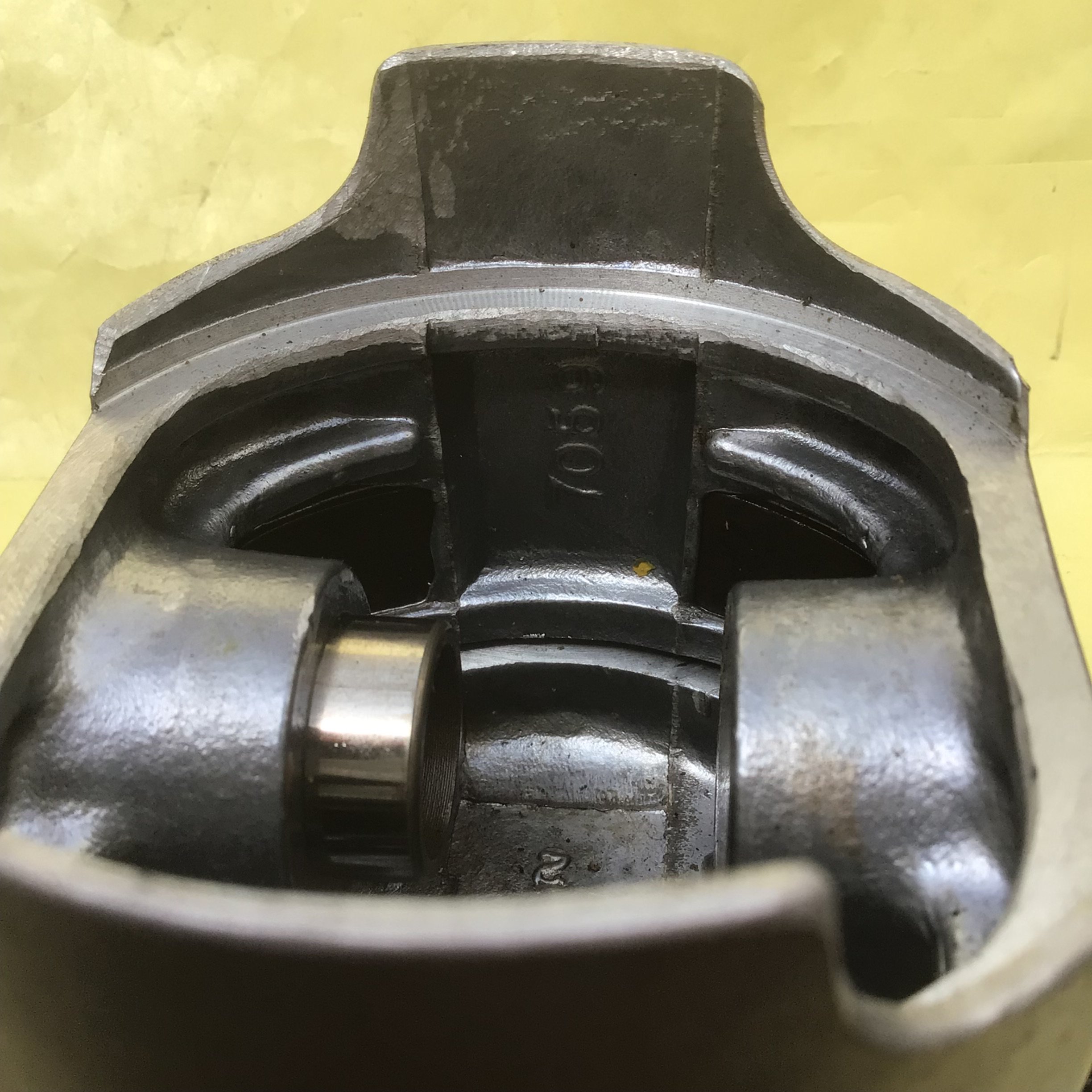

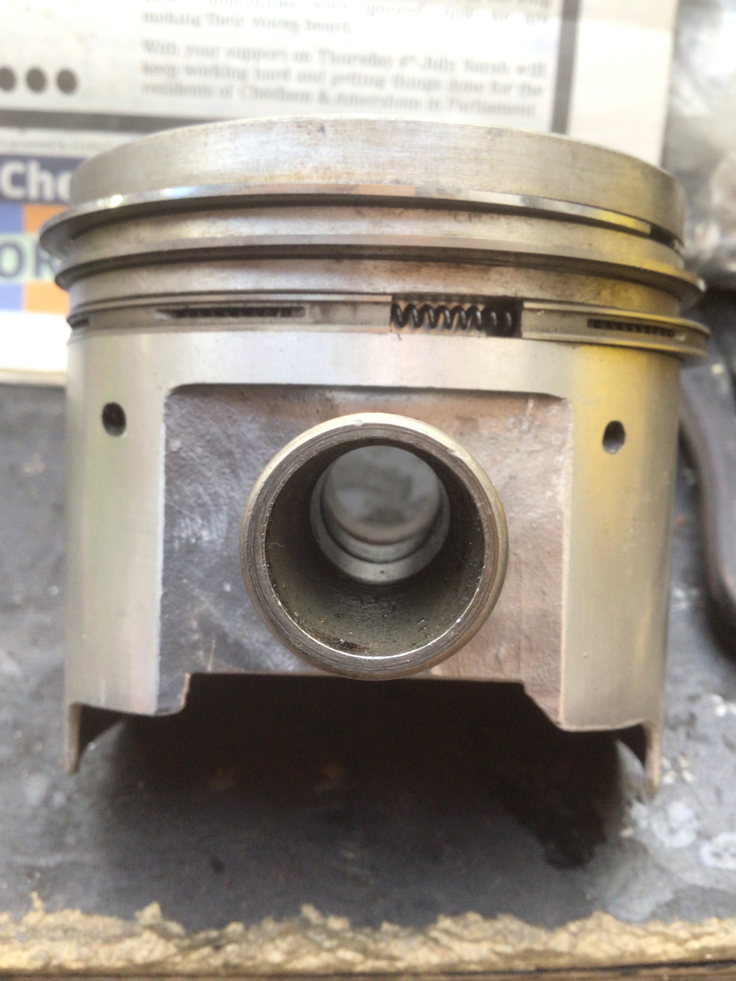

Interesting construction on the big piston. They were made by ASSO No 7059 inside they have four small steel plates set into the piston wall covering four holes that are drilled in line with the gudgeon pin. I can’t imagine what these features do?
View attachment 446808View attachment 446809View attachment 446810
Are plates baffles, with an indirect connection between the external hole and the inside of the piston? If so, could it be to cause an induction of oil on the down-strolke to help lubricate the cylinder.
If they are baffles, I agree with @fiat500, I suspect those holes allow oil mist from the crank case to be blown on to the cylinder walls on the down stroke of the crank to aid cylinder wall oiling. Conversely you often find small holes or slots inside the oil control ring groove, those are to channel oil that the control ring has collected away from the cylinder walls.
Alternatively if the steel plates are blocking the holes completely, then it could mean this is essentially an 'off the shelf' piston that has been repurposed by Alquati and blocking those holes off was part of the modification. Holes like that to allow oiling are common on 2 stroke pistons to aid cylinder wall oiling as mentioned above.

This piston seems to be either an "Invar Strut" piston or possibly an "Autothermic" piston.
For further info, see the webpage below, scroll to Types of piston, then see #2 Invar Strut pistons and #3 Autothermic pistons for explanation on these types. Internet searches using these terms will give lots of other info.
Incidentally, Invar struts were incorporated in various standard application pistons, not just on applications for tuned or high-performance engines.
