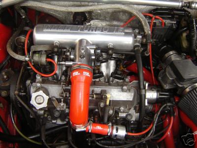

well ive finished the engine bay!
now the rest of the car needs finishing...(lowering + buckets)
let me know what you think and happy to answer any questions :D
cheers guys
