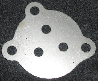

On the note of the blanking plate; Alfa officially released a modified EGR gasket plate for their GT diesels which would have the same effects on the engine fuelling as the type I have installed.
