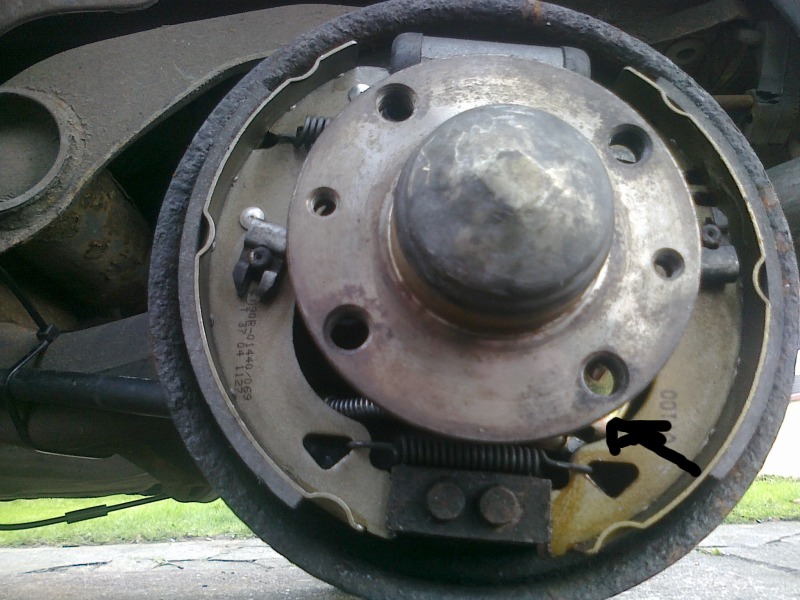

ill take off everything will stick a picture.

your springs look inherently right
look at the picture i copied and you will see to have committed the error of not letting off the handbrake prior to adjustment as that lever should be behind the drum on its stop when handbrake off
when you have done this you should be able to ratchet the shoes up by carefully pushing the footbrake and hearing it click up
this assumes ratchets have good teeth so they dont click back off

not sure now , on that picture handbrake is up or not.
