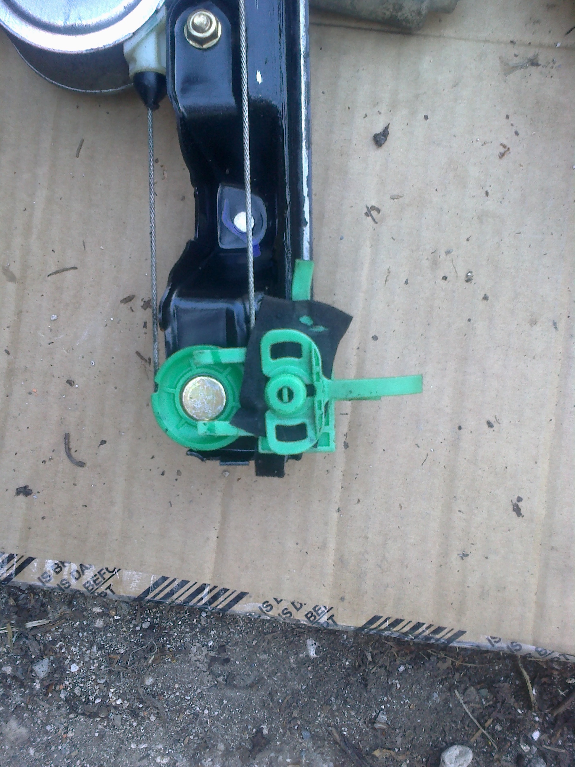

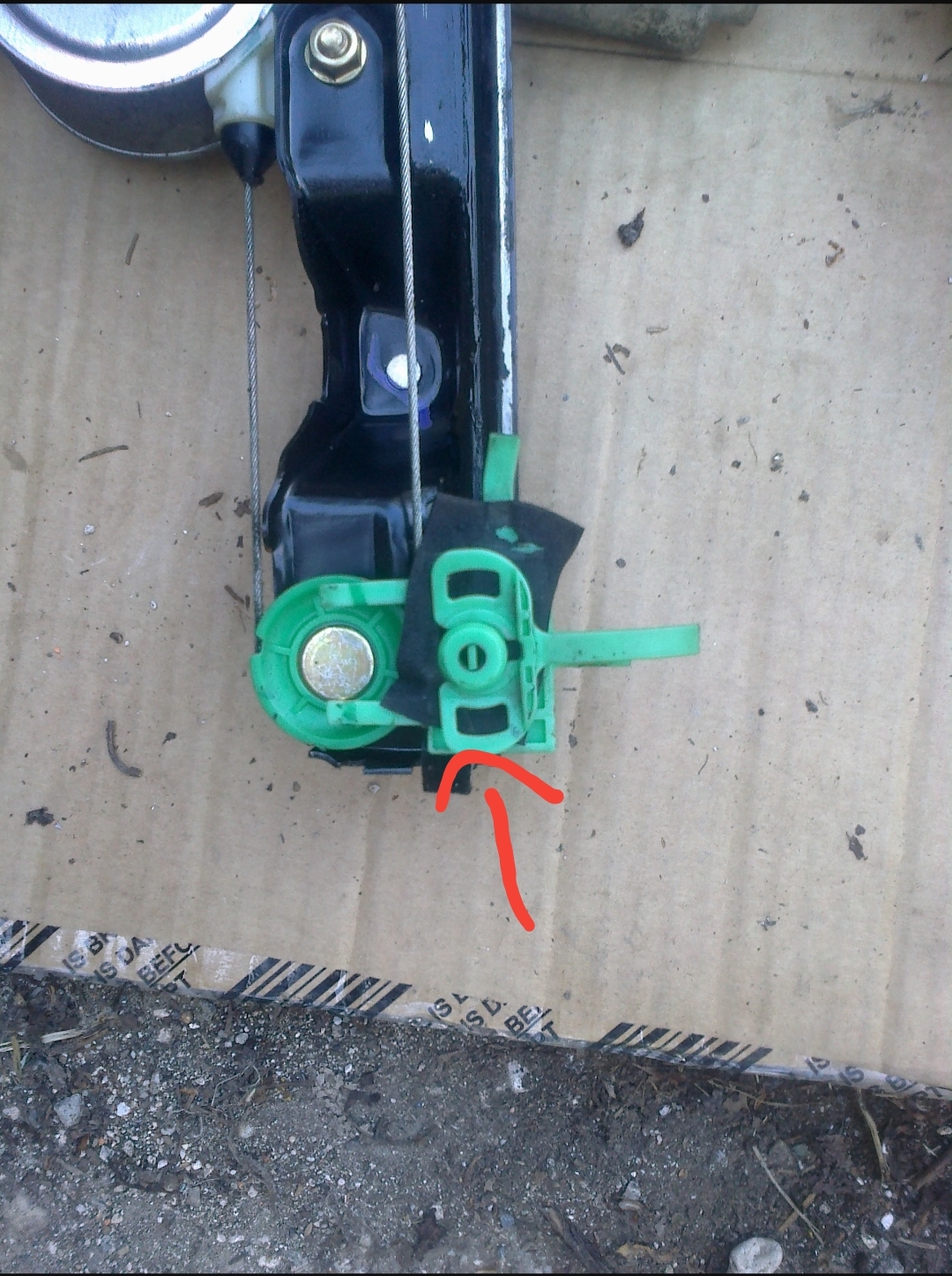

I have looked at the threats thanks. The problem i am having is that I need to change the whole mechanism. And the issue is that the green knob is in the window hole. In order to get it out and release the window you need to lower it a bit. But thats the issue I can't lower my window. Or I don't know how

Generally in this situation you would demount the window regulator and move this carefully out of the door and downward bringing the glass with it until you can access the clip. If that doesn’t work then try and remove the motor from the rest of the regulator so that you can then manually lower the glass, or cut the wire cables that support the glass on the old regulator as you’re fitting a new one hopefully with new cables failing that brute force and ignorance.
Window glass is inexpensive absolute worst case and you can’t find any other way to do it, break the glass and then put a new piece in there is however no step by step guide you just need to apply a bit of problem solving to the situation.
Cutting the cable was the main solution what I found on the Internet. However my problem is that I wanted to buy one from the scrapyard. So I could cut the cable of my car, but I need to find a way to dismount it from the scrapyard (so it brings me back to the same situation, I can't cut the cable or break the glass). I have tried to unbolt the 3 screws in order to move the regulator but I couldn't, I gues because of the weight of the window, for the two cars there was no wiggle room. While I was doubting whether it was possible to get the regulator off (without breaking the glass and such) I think it is a common problem, broken regulator, as I saw many regulators striped at the scrapyard (without breaking the glass). So I hoped it was a common problem and a easy solution to it.
Just buy one off eBay ? Or if the scrap yard won’t remove it for you and the glass gets broken so be it.
As I said you’d need to apply your own problem solving skills to the situation as you get there, there is no how to
