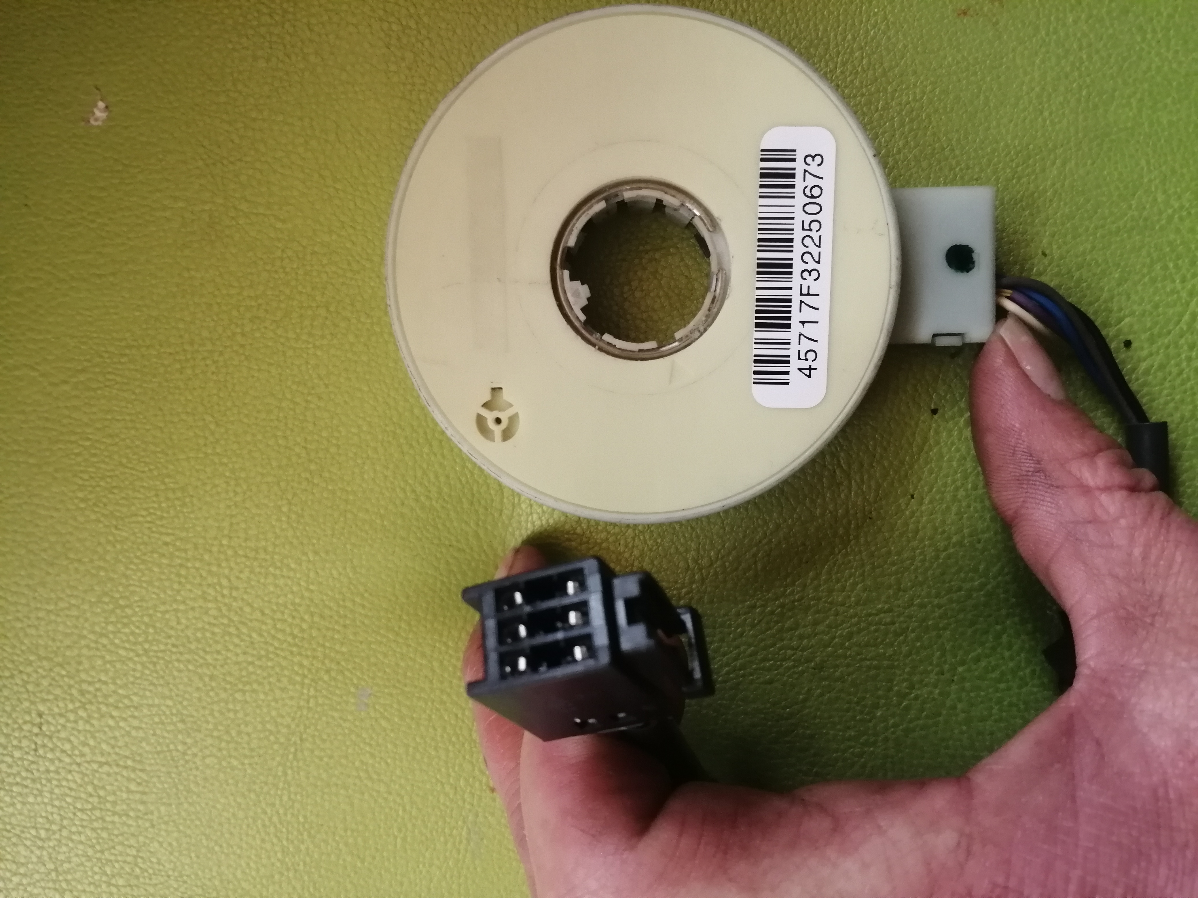

I am trying to source a replacement torque sensor for my 2004 mk2b active sport. My problem is I have a grey cable sleeve and black ecu connector and I can't source one. Closest I can find with correct connector has yellow sleeve. Can I use this? Pics attached of my faulty sensor and ecu.
