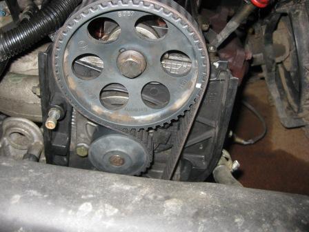

Hi, I only have one clear notch on the flywheel which is aligned to a mark on the housing with a 0 on it. (to the front of the rectangle hole on the housing) ther are two other marks centre of the rectangle hole and to the rear. Your camshaft marks show pointing to the rear, Haynes indicates it pointing to the front. As I said cam lobes on pot 1 are both pointing just above horizontal at aroud ten to 2, with the camshaft mark lining up with a plastic arrow which forms part of hte cambelt cover bolted into the head. is this 180 out, I did try it the other way and had no joy also.

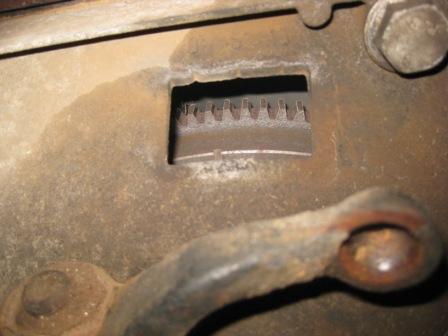

As promised tdc mark on bellhousing,

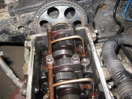

how Haynes tells you to do it, cam lobes above horizontal

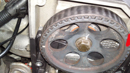

where the camshaft pulley ends up.
