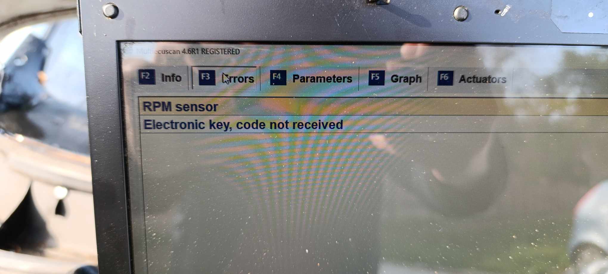

and you were right crankshaft sensor is dead
Parameters show 0 RPM when I try to start the engine

That error 'key code not received' makes me wonder if there's an immobiliser problem. Quite a few reports on the Bravo section:
Do you have a spare / red key you could try?

Hello.
"key code not received"
Simultaneously appear with RPM sensor.
So in Monday we order RPM sensor is only 4 euro 😁
Today we put on car sensor and on 1/2 key Brmmm Brmmm 😉
We tested about 20 time on/off drive today 20-30km no problem
And of course no more "key code not received"
