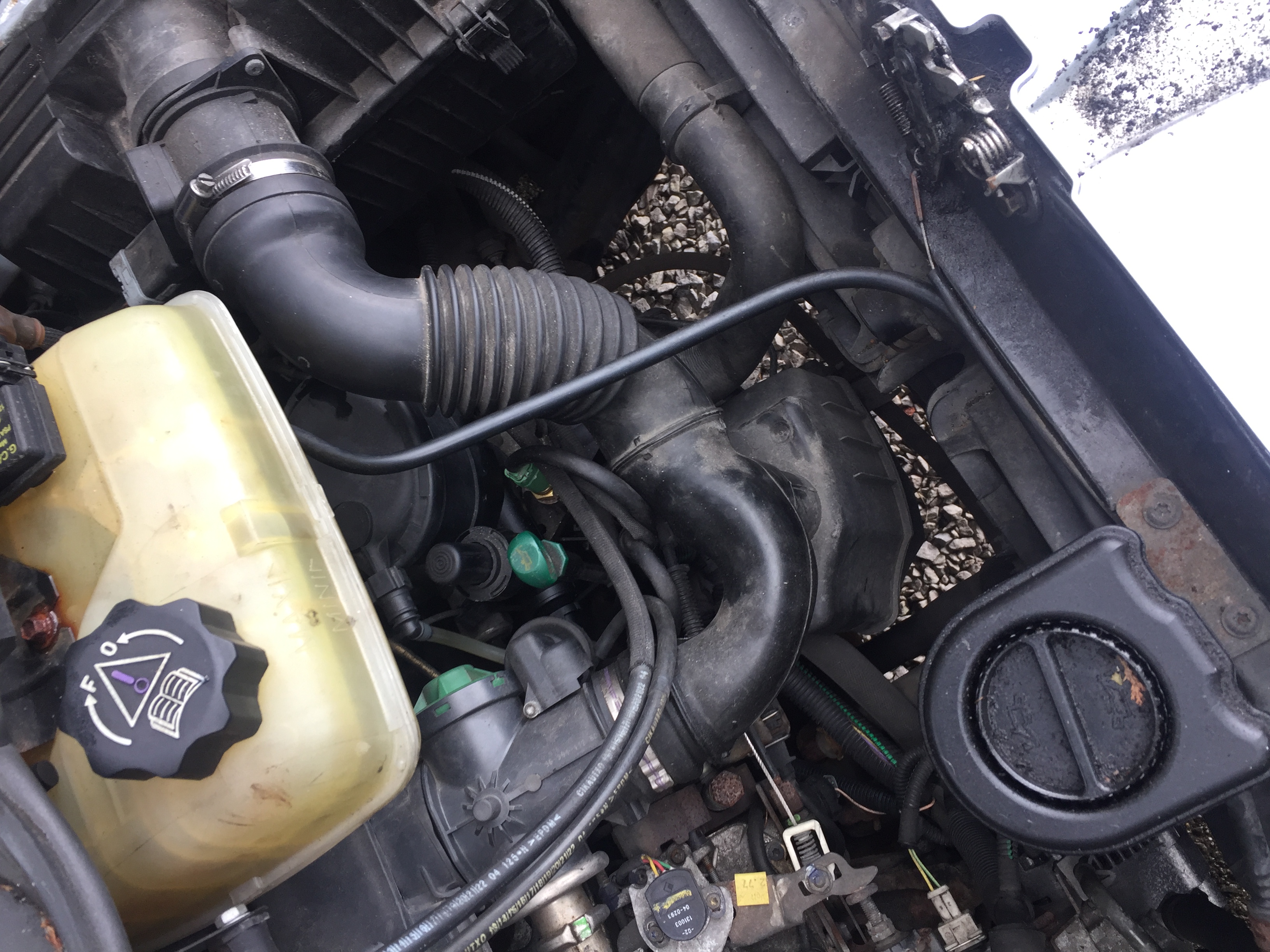

This is the sensor in question. There is another brown sensor very close to where this green one is.

The green sensor I've been working on is to the right of the dipstick.

Thanks for the response.
This is a new temp sensor. With the old sensor the gauge would just go from cold to hot 3 times then settle to the left of the gauge.
