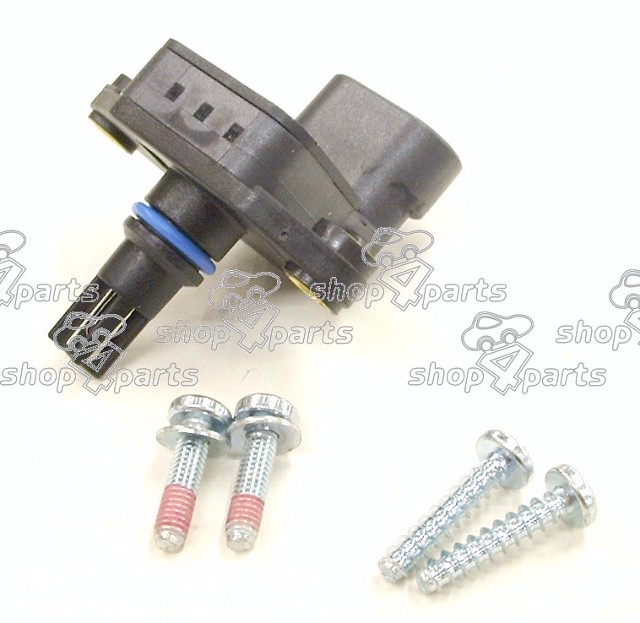

Please send a pic of your MAF sensor.
I dont see mine under the hood.
My airbox fell out and there is no wires running there.
I stuck a cone on the pipe in mean time.
I listen to the car under the hood at idle. It sometimes dips (uneven idle) then the filter sucks air like a vacuum.
Please show me what this part looks like so then i know if I must buy a new box and MAF
I read that my 1.6 model doesn't come out with one?
Should I change my airflow pipe and cone filter to standard box?
Your car must have a MAF sensor. They were part and parcel of the emissions equipment when catalytic converters were introduced.
Mine is an inline one, separate from the throttle body. It sits between the airbox and the turbo (my car is a JTD) but your 1.6 will have one similar, either between the airbox and the throttle body (usually right next to the throttle body), or it will have one that slots into the throttle body itself.

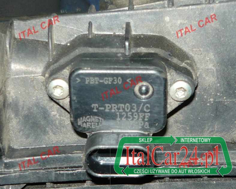

I have attached a picture of what mine looks like (this type are all quite similar) and there's a picture of the 1.6 Brava (same engine family as yours?) type, that slots into the top of the throttle body.
If the airbox fell off then that doesn't bode well... but the cone filter itself shouldn't affect how the car idles and runs. As long as there are no induction leaks past the throttle body, the MAF will measure whatever air is getting in, however it's getting in (even if you had no filter at all) and it ought to compensate accordingly.
Hi Ralf,
I have the second photo yes. The one in the air intake. I took that out and cleaned it. Cleaned throttle body too (both sides)
I do not have the first one however,the one that looks like it fits on a pipe.
