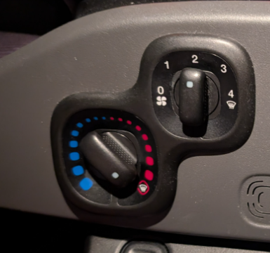

Yes; the fan switch which has a rotary action to control the fan speed but if you push it in it turns on the a/c if the fan is on. Turn the hot/cold switch to cold as I believe the a/c will not turn on if the heater is on, unless you go to full demist when a/c helps clear condensed water on the inside of the screen.

My car definitely doesn't have air con.
These switches don't push in or pull out. And only illuminate when the headlights are on.
It doesn't have a snowflake on the dial. There is no air con.

If there was air con there’s a very obvious ‘dot’ in the fan switch (circled yellow in my photo) which lights up, and the snowflake symbol There is no ‘dot’ or snowflake in Adam’s photo, so (as he says) no air con.
