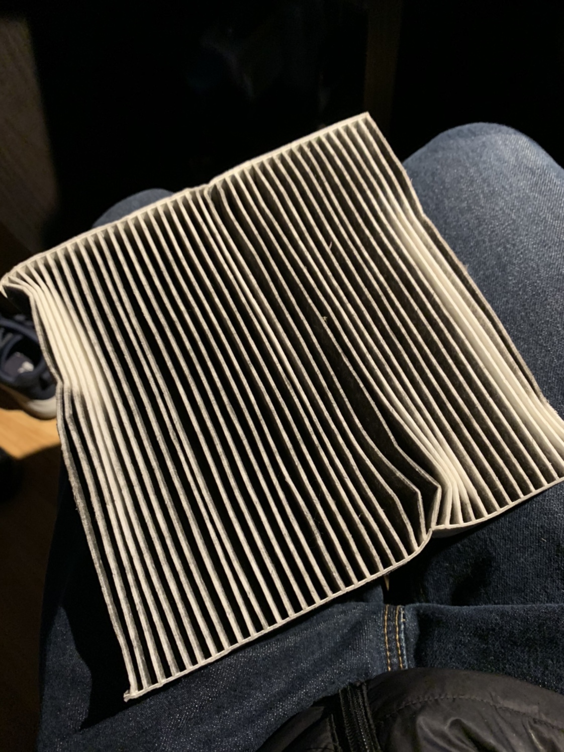

I've just done this on a 2017 UK RHD Panda and my god... they don't make it easy.

I can assure you that it's no easy job on a LHD Panda either.

Having replaced it a few times now on the 2006 Panda, swearing has been reduced.
I remove the bolt from the bottom of the steering column and move the column aside. Then with the clutch pedal held down, the filter goes in a lot easier.
Depress the clutch pedal and use a cable tie to hold it down. This makes life easier too.
