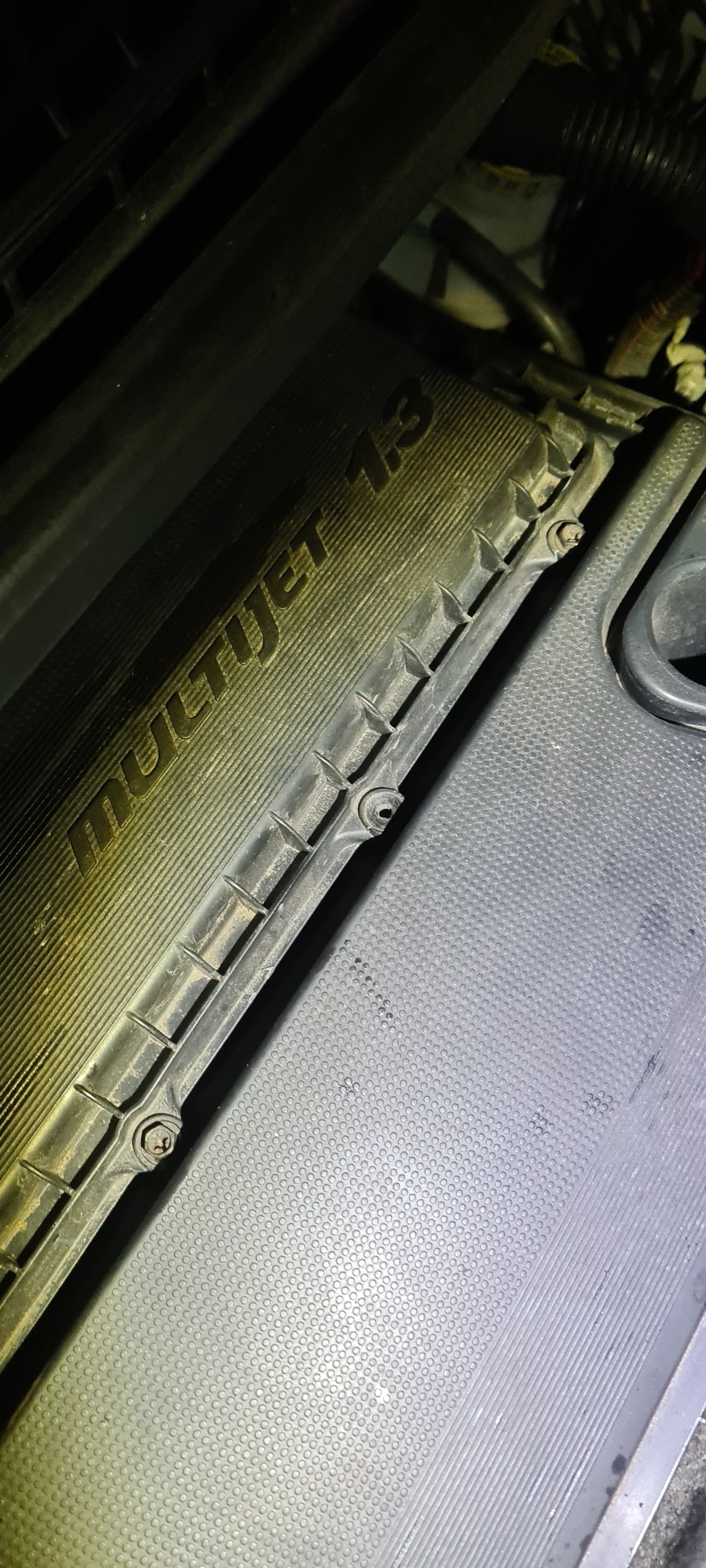

Dear All, please find the picture attached,
Unfortunately I had my car serviced and the garage mechanic lost one of the screw / bolt.
Please see the picture attached I tryed to find a similar screw thread in halfords but I found nothing .
Can you help please.
@Herts Hillhopper I hope your mighty knowledge cab help me as usual.... 😆

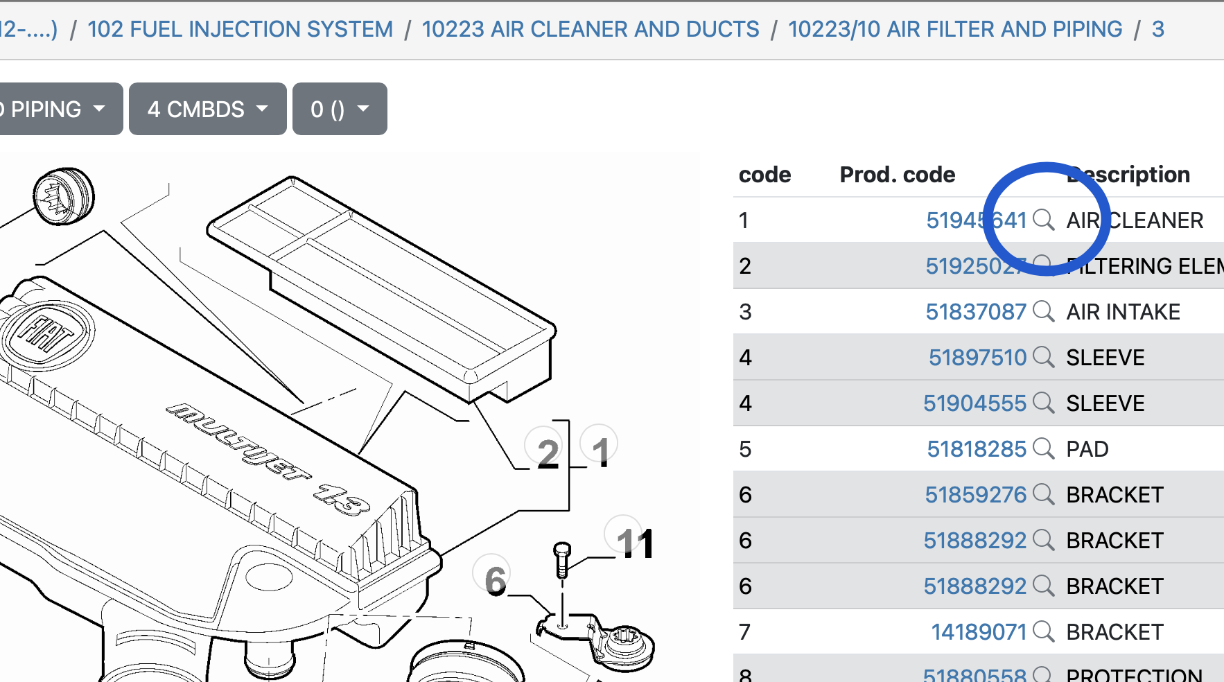

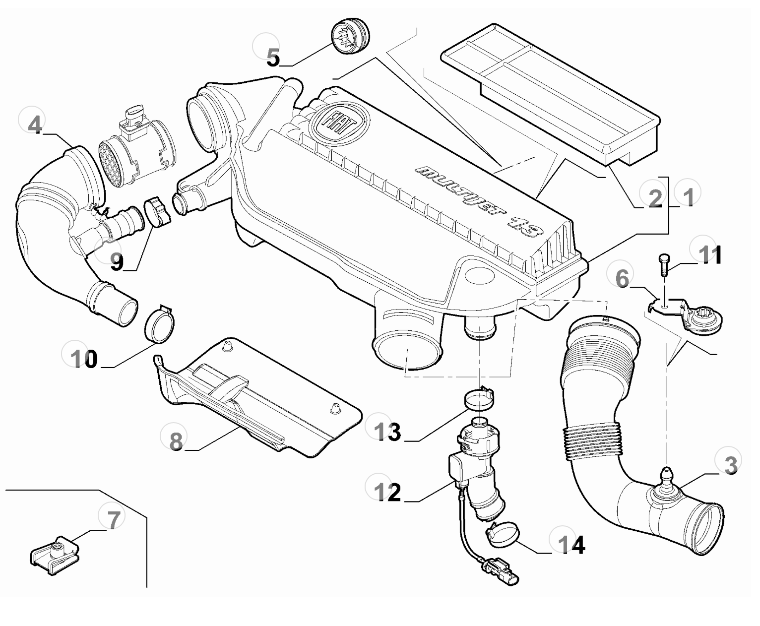

So far as I can see on mine (which, like yours is a 1.3 diesel), it's just held in place by push-fit rubber mounts -- probably to reduce potential damage from vibration. So long as there's a good seal to the duct that leads from it to the turbo piping, it's OK to wobble a bit.
If you follow the links to ePER at the top of this forum (ePER is the Fiat online part catalogue), and delve through, you'll end up here:
and then, from within ePER itself, find the item you want to look for (number 1 in this case).. Then click the 'magnifying glass' symbol next to the part number (I've put a blue circle round it) , and it takes you to Google and shows anywhere with that part for sale... (All very clever, and one of the neat little 'hidden extras' from the Forum's creator @ben that work sooo well) . Several complete airboxes for sale from as little as £40.
