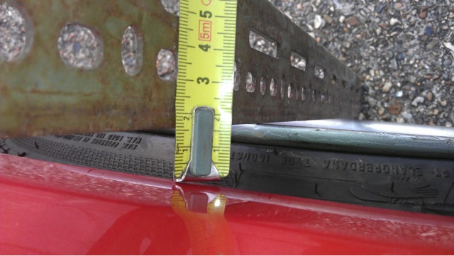

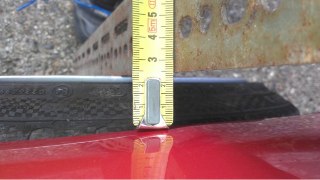

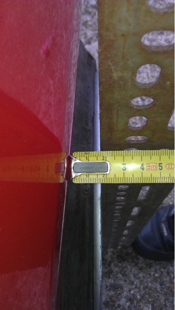

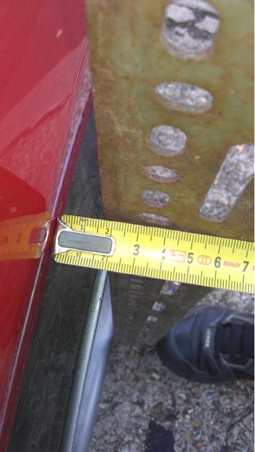

So, my question is... Legal, or .....?
Looks legal, but I can understand why the police didn't like it. Perhaps narrower wheels, or arch trims might be a good idea. Even if you win this one, you are likely to be stopped regularly. Producing evidence of a won court case will embarrass the copper, so he will wast a lot of your time looking for anything else wrong. Avoid the aggro, cover them up.

I'm not sure, the straight edge is touching the side of the wheel rim in your pic?
"d) wheels, if there are no pointed or sharp features which projects beyond the external plane of the wheel rim, no wing nuts are fitted and there are no projections beyond the vehicle body plan form"
could be interpreted as 'wheel level with the arch' in other words, drop a plumb line down from the edge of the arch....
& the convex wheel disc would be like the old-fashioned hubcaps or maybe
Where the convex trim is designed to cover protruding wheelnuts/studs, giving a rounded/smooth edge to protect pedestrians ?
I would say that, without the tyre, that straight edge on your wheel MUST NOT be further out than the arch.
With the tyre on, the tread MUST NOT show outside the arch (which it appeards to do in the 1st picture) but the bulge of the tyre wall can.
In other words, the bulge starts at the edge of the tread & ends at the edge of the wheel.
