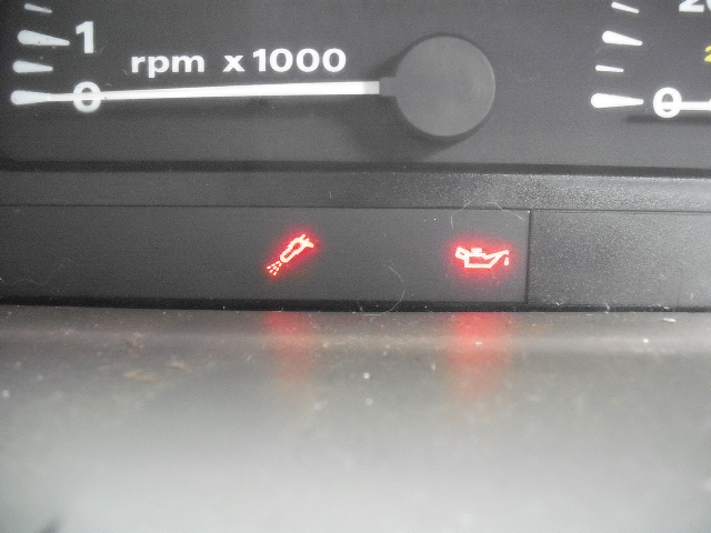

can anyone tell me what this light mean on the dash :confused: it looks like a red microphone (see attached photos)

try starting it with the red key if you have it, if not you will need a new keyset (ECU, codebox, locks & keys) or have the ECU decoded.
just put red key in ignition and turn on once, the put blue key in turned it on twice and nothing happened, tried again three times nothing then again but 4 times and it started.:slayer:
this also happened yesterday but it took a lot longer to start today:confused: oh how much would decoding the ecu cost?
i paid about £30 to have mine done, but its more of a last resort.
if its starting intermittantly it is probably the antenna has fallen away from the lock barel for the codebox do it would be worth removing the cowling and seeing if its in place or not before doing anything else.
Ry
ok will go and have a look not now though its getting cold outside so will post update tomorrow thanks for all the help so far guys(y)
Thats the injector light.
It means there is an engine fault that has been recorded in the ECU
EDIT: why is your code light on aswell? do they both go out after a few seconds?
mine does this when i first start up but it goes out after a few seconds....is this normal?
