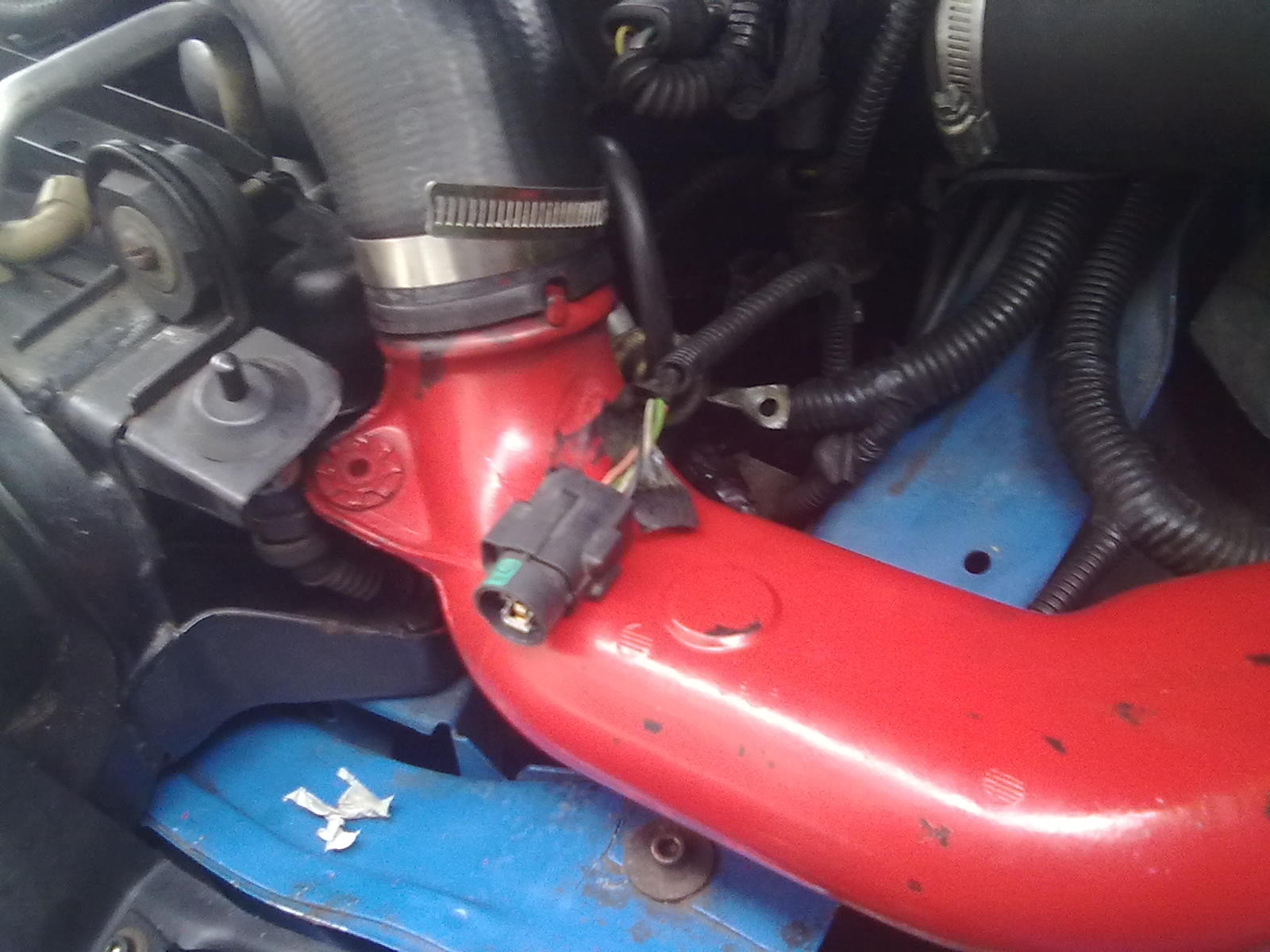

my car is still running 0.5bar boost! no engine light is on..ive replaced the boost solenoid today and has made no differnce.. what else could it be? also i saw this plug which was not connected can any1 tell me what its for or check on there car were it splugged in!

so that wont really cause my car to run 0.5bar boost! could my wastegate by stuck?

Can't see anything looking like that connector.
Just took these from that area and that side of the engine.....anything look familiar ?
