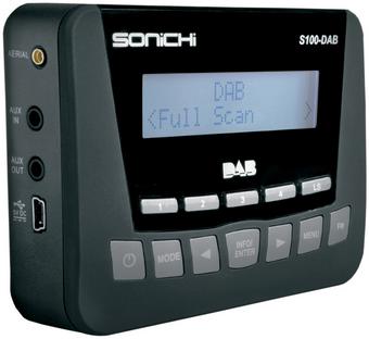

There are devices that will take a Bluetooth output from a phone, and transmit it on an FM frequency. Tune the car radio into that frequency. Bit of a faff, but cheaper than a brand new car. (Is the phone worth more than the car? The car will last longer - bargain, tell her.)
Update: Here's one. https://www.halfords.com/technology...sound-bluetooth-to-fm-transmitter-756621.html
There are probably other solutions out there, but that is cheap, and probably easily obtained.
