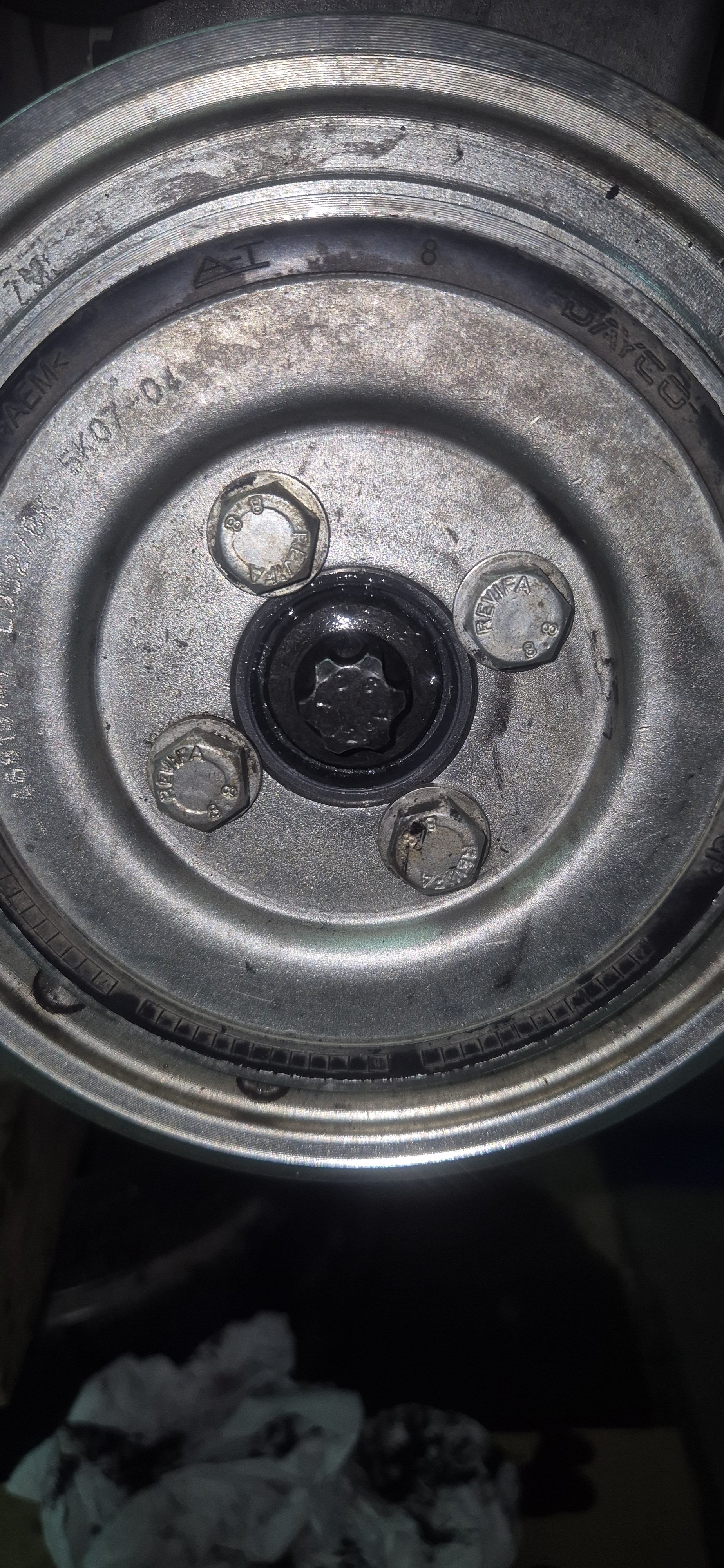

Troquei a distribuição do meu fiat panda 169 4x4 1.3 multijet e não encontro em nenhum lugar o aperto em Nm do parafuso central da cambota.

The central left hand thread M14 bolt
Is a torque to yield type bolt so should ideally be replaced
The four small pulley ones are reusable

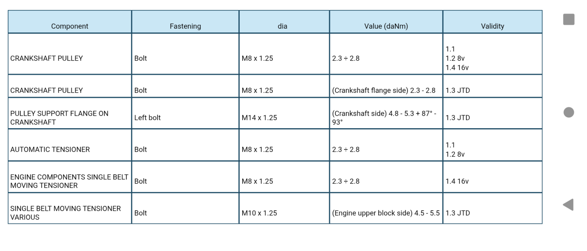

Fiat and GM give different ways to achieve the correct torque.
230Nm or 50Nm plus 90 degrees. I don't have a souped up torque wrench so used the "plus 90" value. The crank is locked using a pin into the flywheel.
