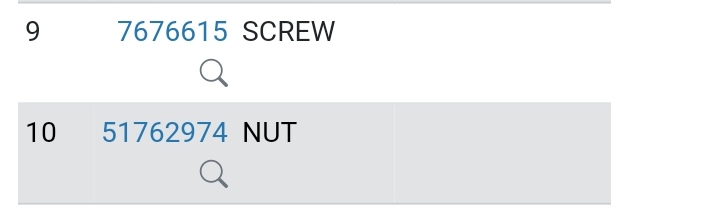

Hi all. New to the forum - posted in the 'newbie' section the other day.
I recently acquired a 07 Panda 100hp. Tidy and original, but needs a lot of love underneath (mainly to suspension and Brake components.)
I've managed to source quite a few bits already, but could do with some pointers in locating others if possible? Any help, greatly appreciated!!
My mechanic has confirmed I need....
- Brake Flexi hose metal bracket
- Bolts & nuts for front hubs to struts
- Bleed nipples
Attached a couple photo's which may help. Please bear in mind, my mechanical knowledge is pretty low. Also, this is the first fiat I've had in 20 years, so not familiar with the best places to source parts (already discovered Autodoc & shop4parts)
Brackets are welded on
Either fabricate new ones or cut them from a solid car
M10 X 1.25 NUT selflocking
M10 X 1.25 X 65 BOLT
Genuine part number
Brake nipples most garages will have them in stock, there are metric 1mm pitch, normally M8 or M10 but they keep changing the sizes, I don't have a 100HP to measure
Genuine part number
Cheers Koalar. That's really helpful! :)
