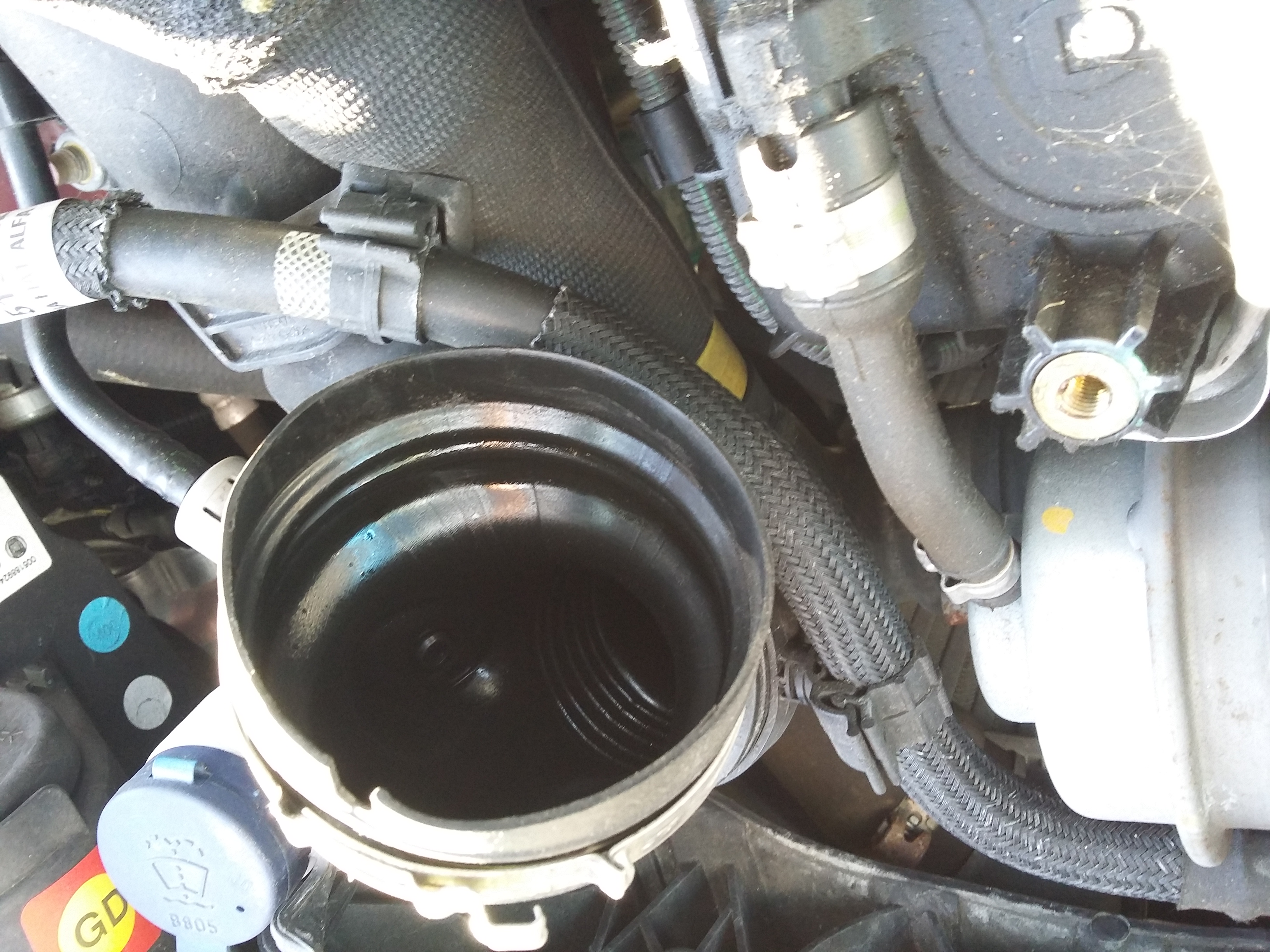

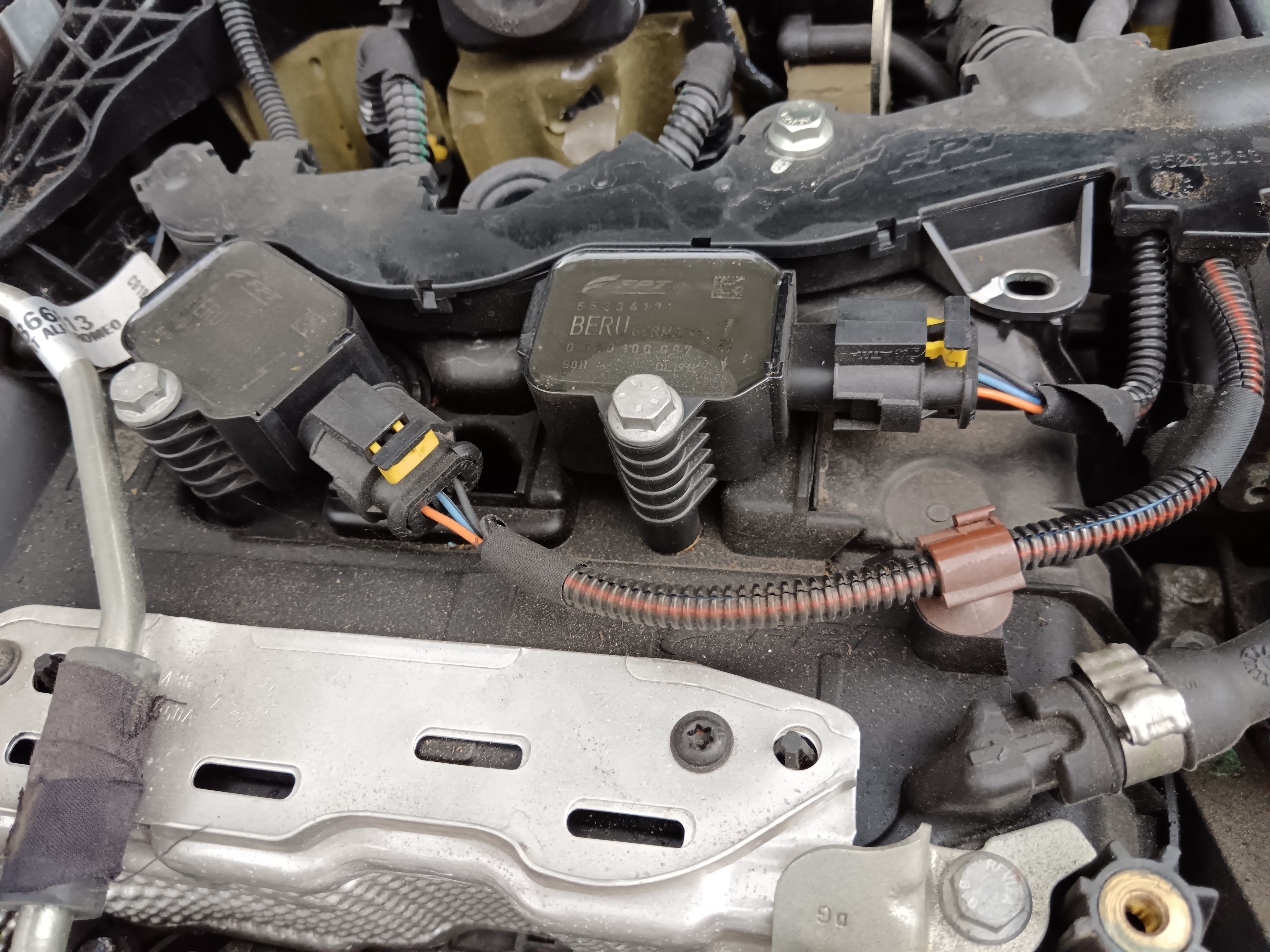

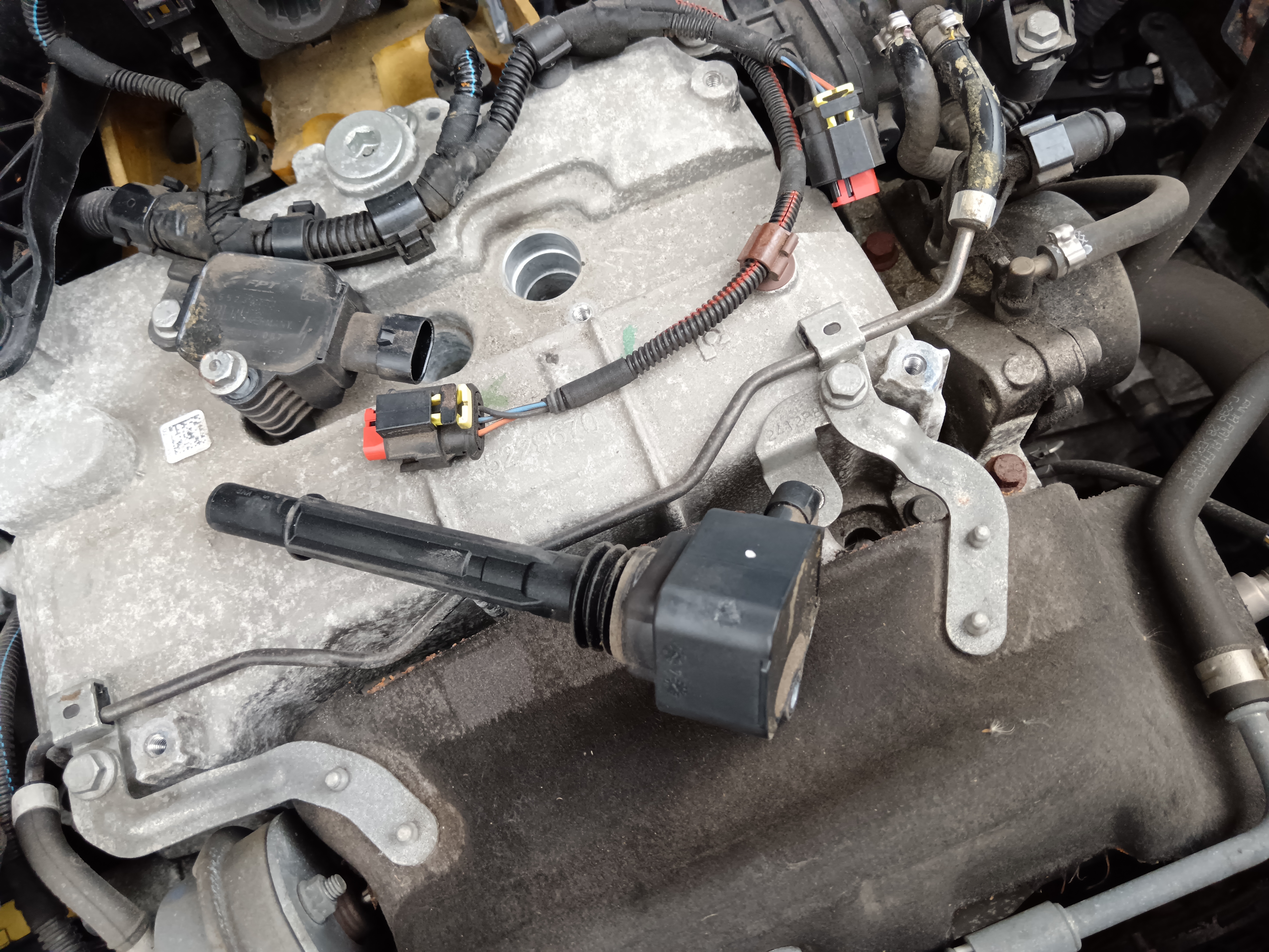

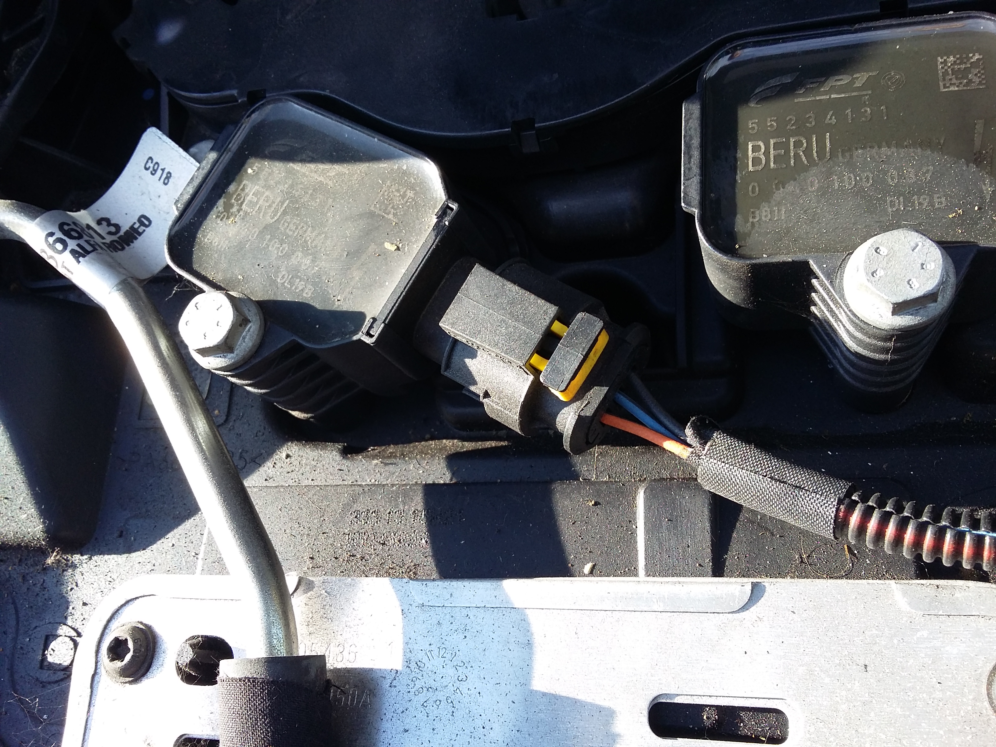

To gain access you will need to undo :

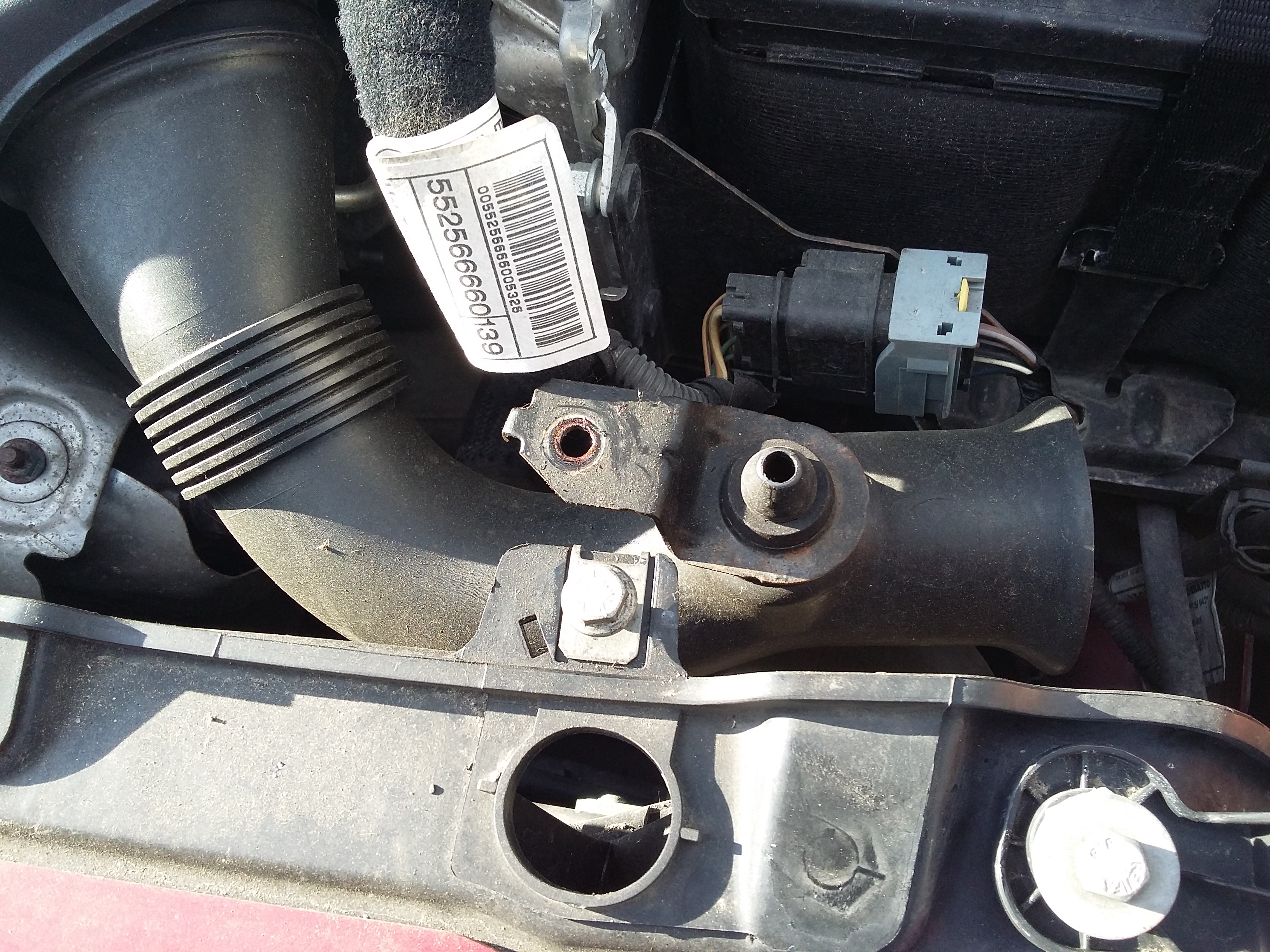

The small air feed hose.. 10mm Hex bolt..(like a horn bracket..just swing bracket)

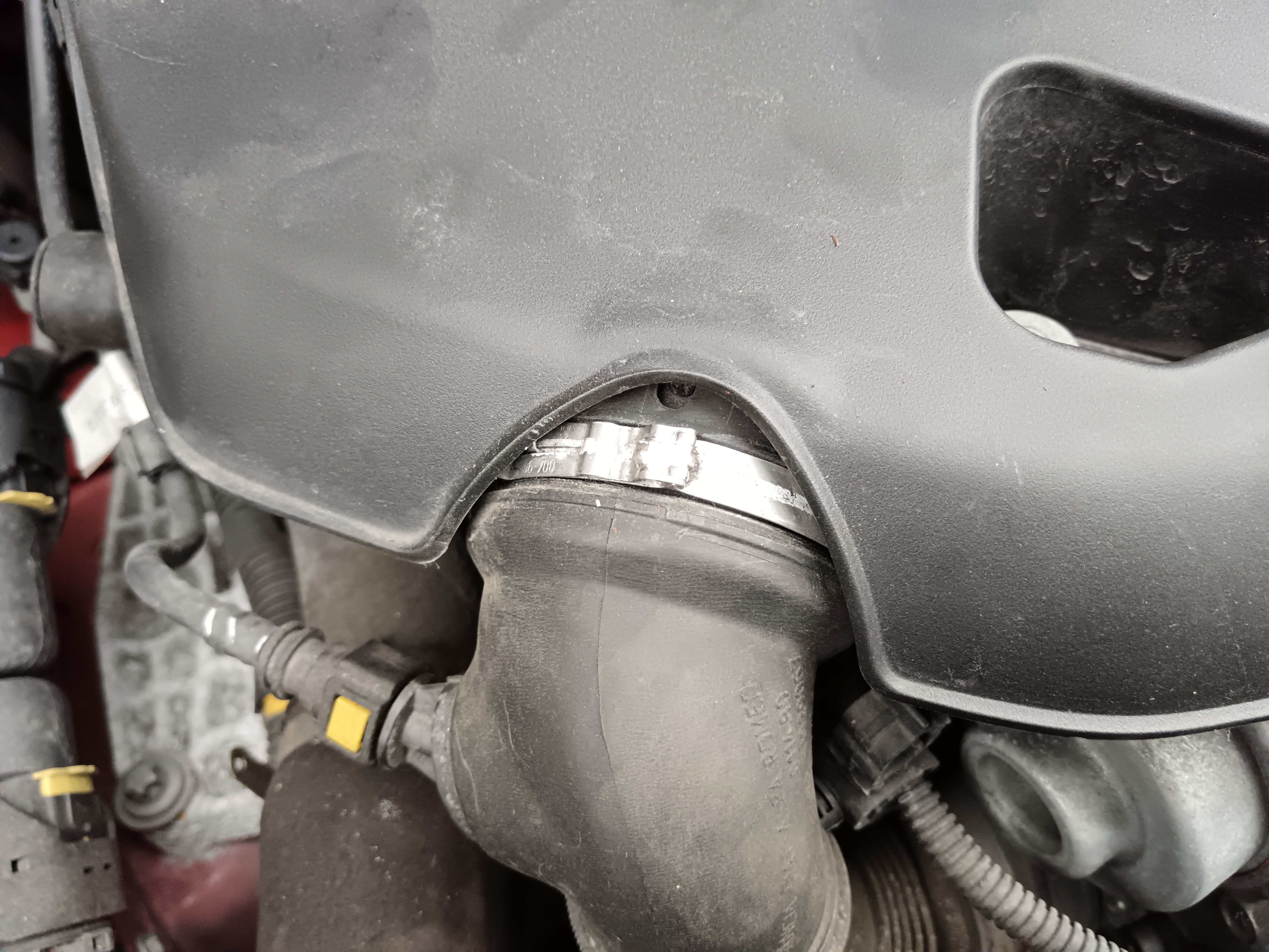

Large feed hose .spring clip (tool required)

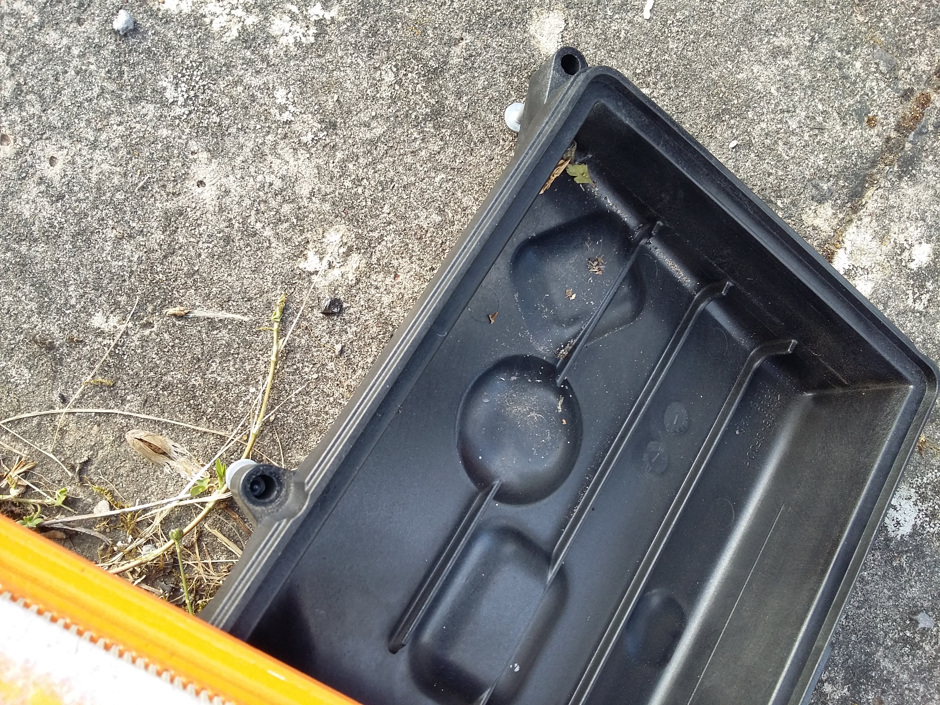

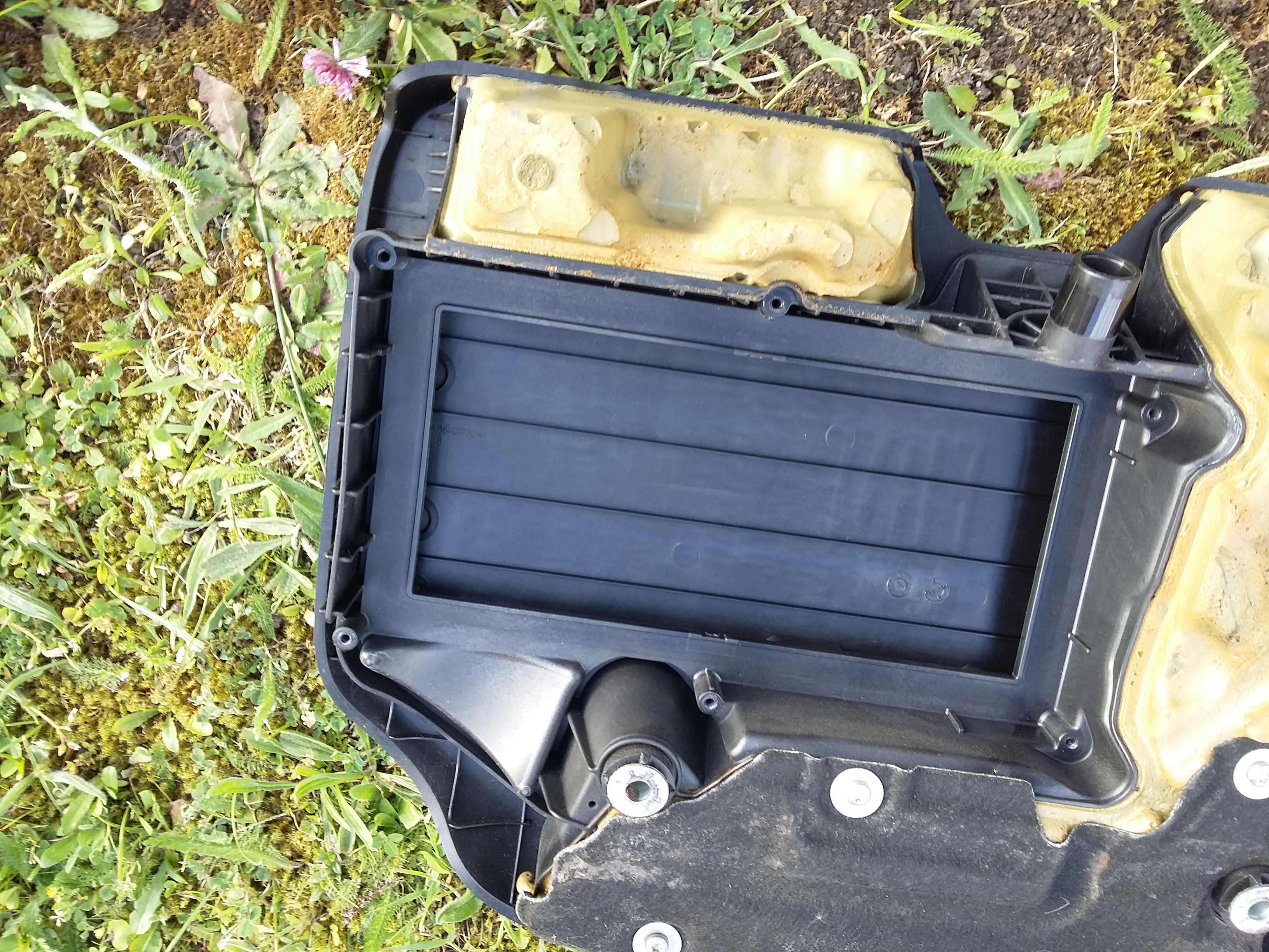

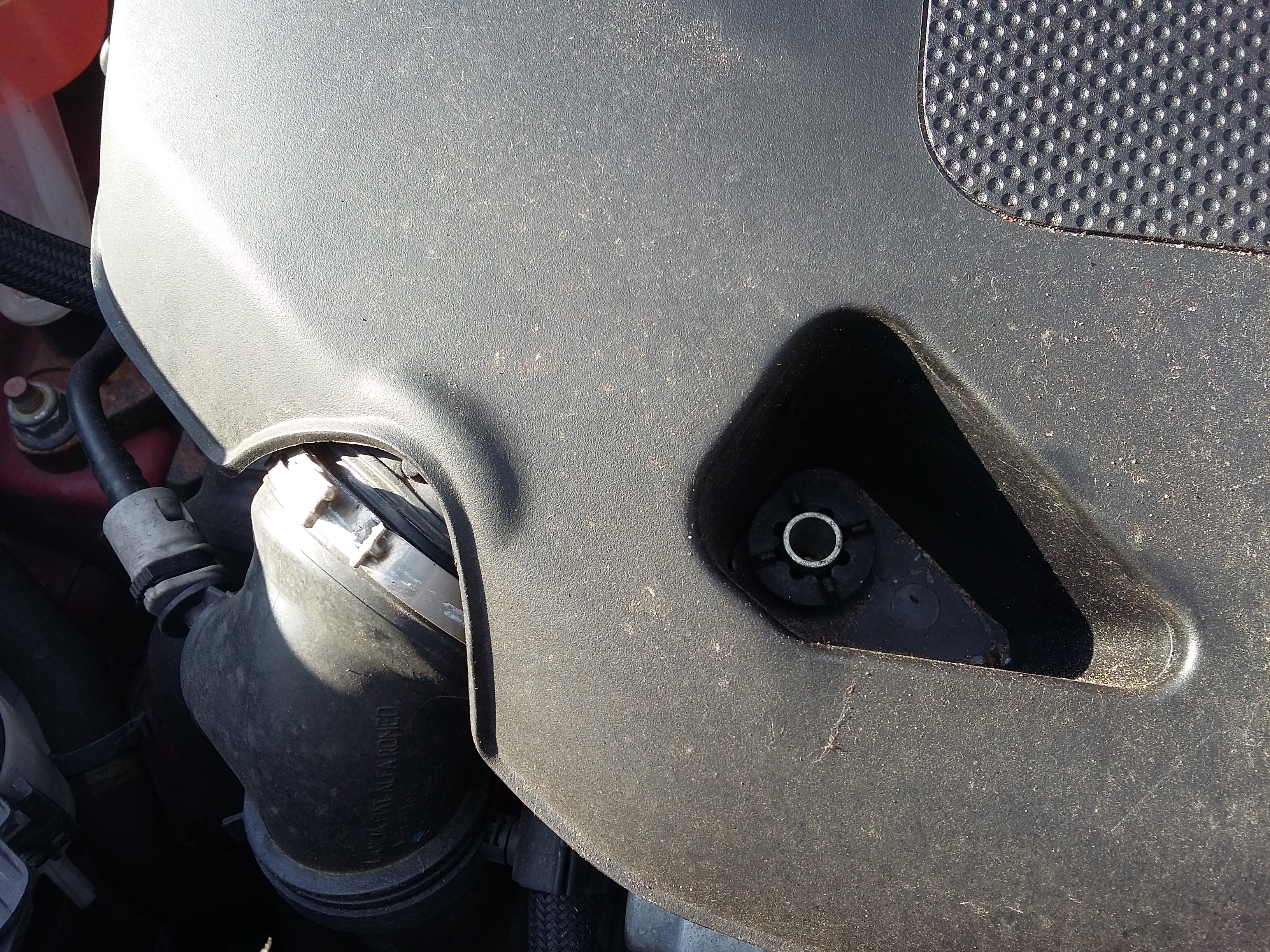

2 x 10mm hex bolts.. retaining airbox

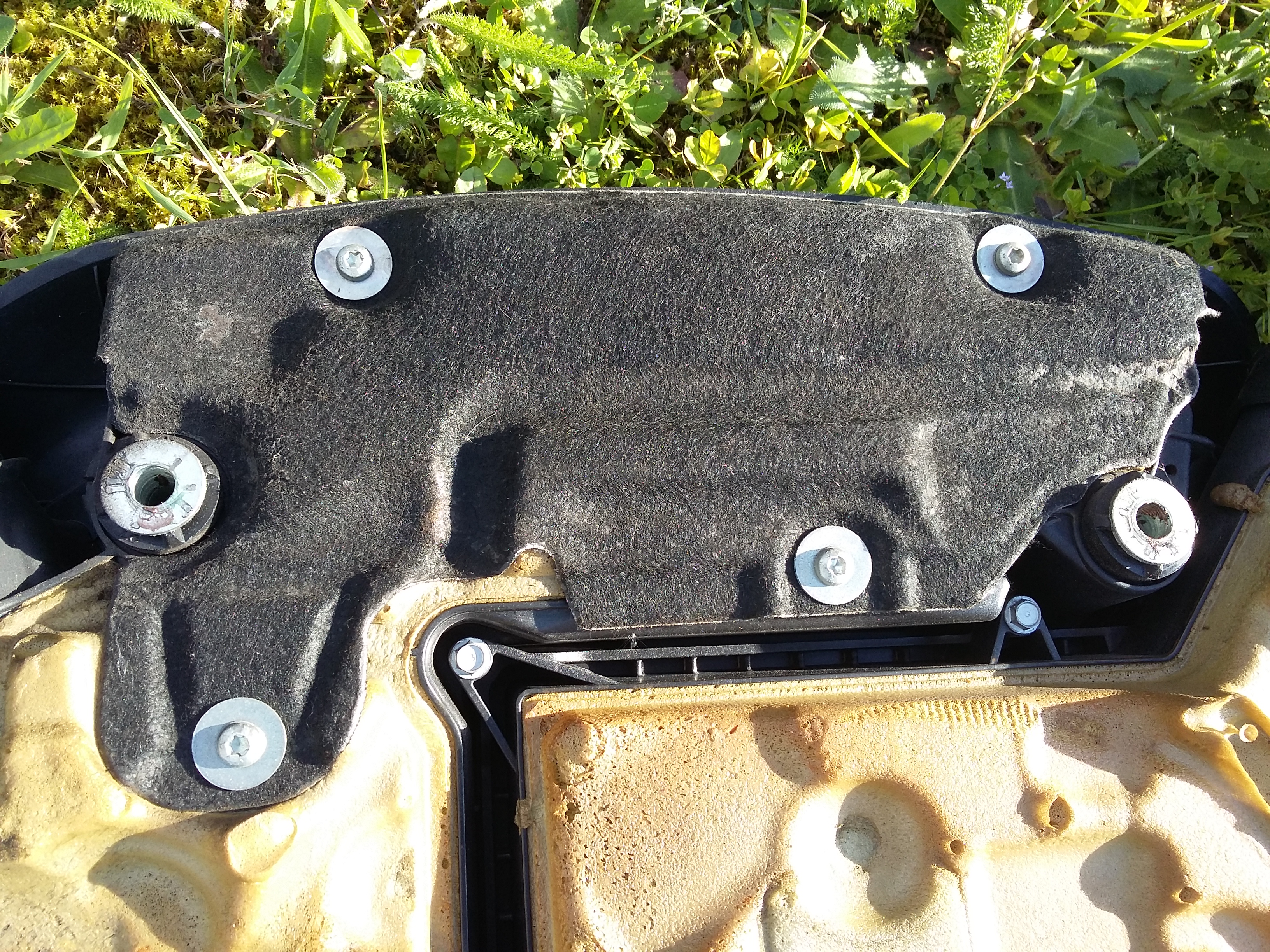

Remove all of those and the air filter casing can be lifted free
There is a moulded spike that retains it onto a bracket at rear of engine
