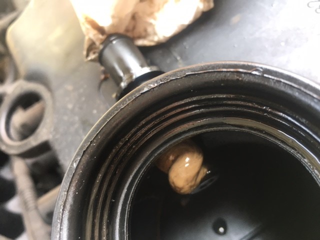

if its a problem it will have a blob of oil on the end. To clean make sure it pointing downward. the sensor is not sealed and you dont want any cleaner running inside. I have not cut one open to see if anything would get damaged, but probably not worth the risk
I will wait to see if its a problem First
to stop it happening again is a bit involved
here me cleaning the air filter pipe
seen this a few times now, but never on my older 05 and 06 cars

Hi koalar, is that photo the underside of the air filter housing, where it connects to the throttle body?
I know exactly where the MAP is and can see the screw that holds it in and just have never got round to pulling it yet. Interesting that you mention they are prone to contamination as I've seen others mention this too.
I cleaned the MAP with brake cleaner when I first got my car, it had quite a build-up of soot around the sensor.
I took it out to check 2&1/2 years later when my car started misbehaving recently and it was still clean.
