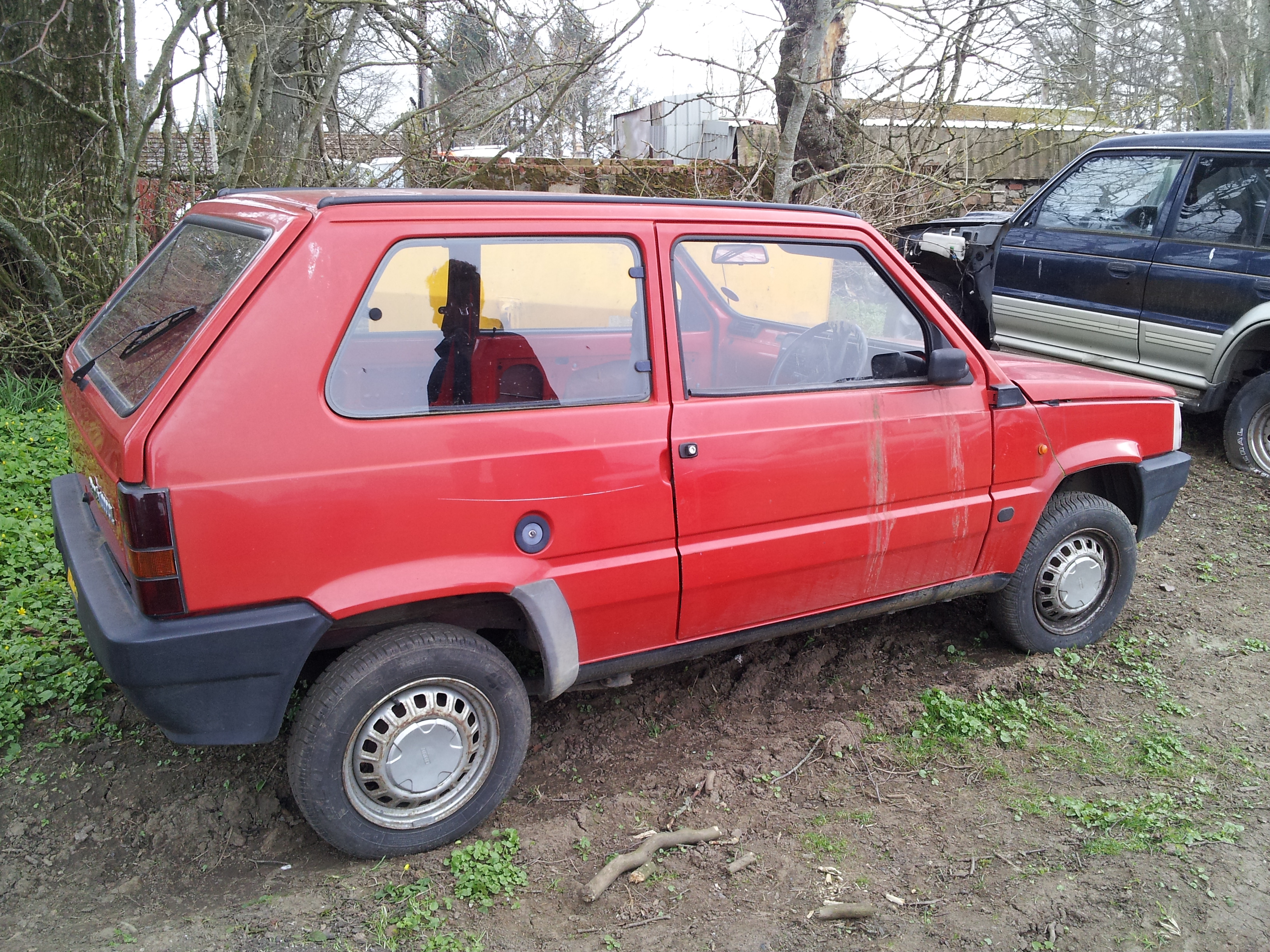

Hi All I have just joined the forum and thought I would share my joint project I have started with my brother as he has been collecting Pandas for years and thought it was about time we modified one. My brother works in Australia and we have have come to an agreement that he buys the parts and as I am a mechanic I have the task of building a race / track car.

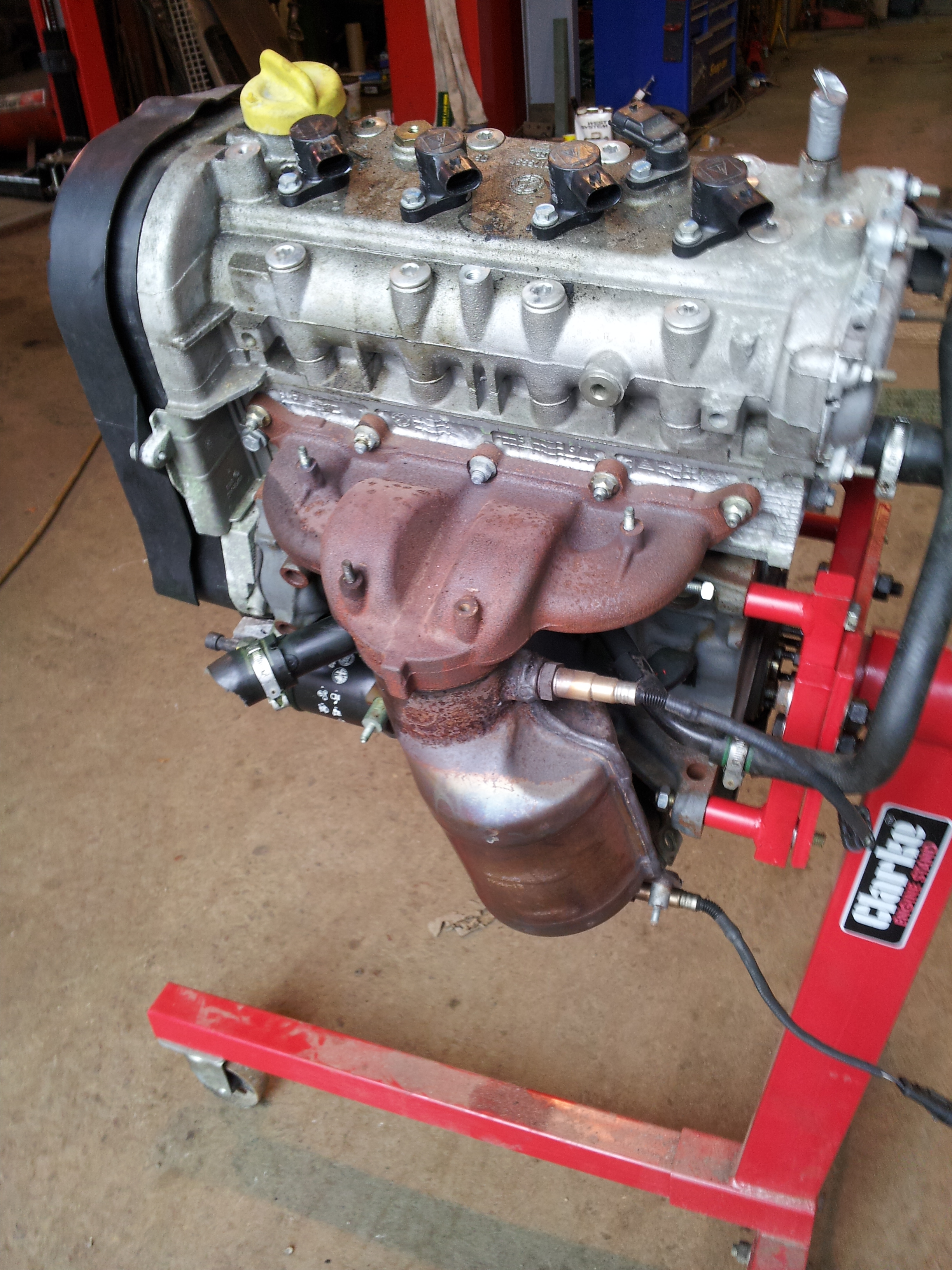

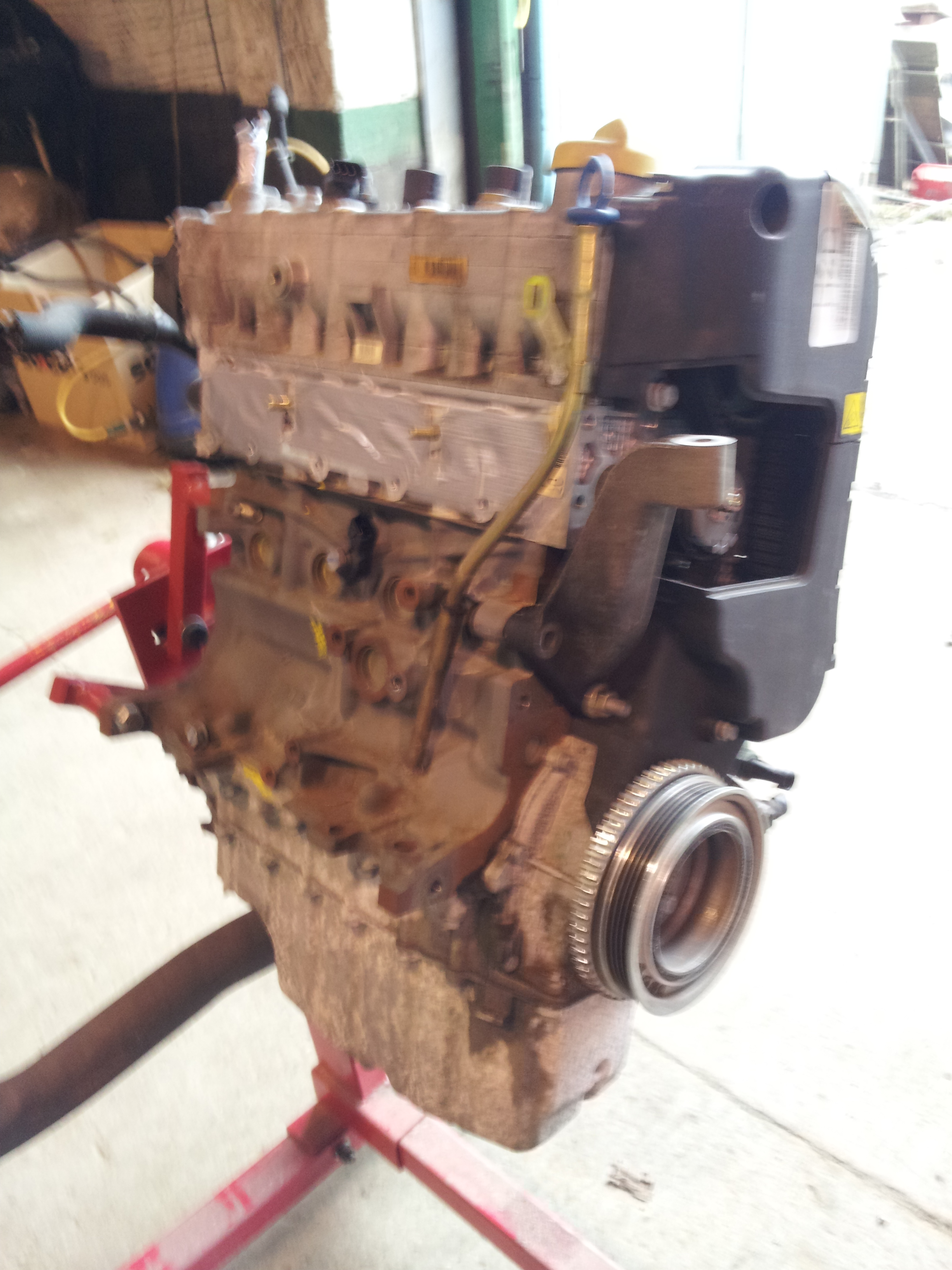

The first task was to select which of the 2 pandas to use. One being a 1990 carbed 1 litre model or the other being a 1993 CLX. A decision was made to use the 1990 model as it never ran great due to carb problems and the engine would be sold anyway.
So initially a 1.2 16 valve engine (out of a scrapped mk1 Punto!) was lined up but we decided that the extra 10 bhp from the 1.4 16 valve Stilo engine was worth the extra money.
So the now redundant 1.2 engine will be going into the newly purchased Panda Number 3 which is another CLX (because 2 pandas is never enough! :D)
The plan is to strip out and lighten it as much as possible, along with fitting twin webber carbs to a custom manifold and running Emerald K6 Management to control the spark.

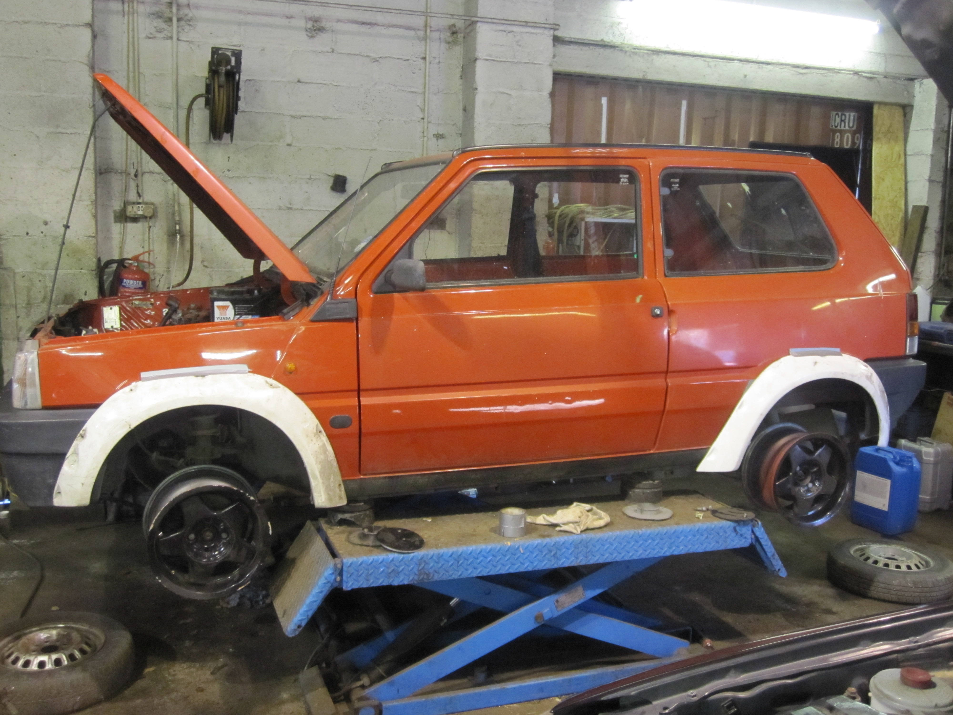

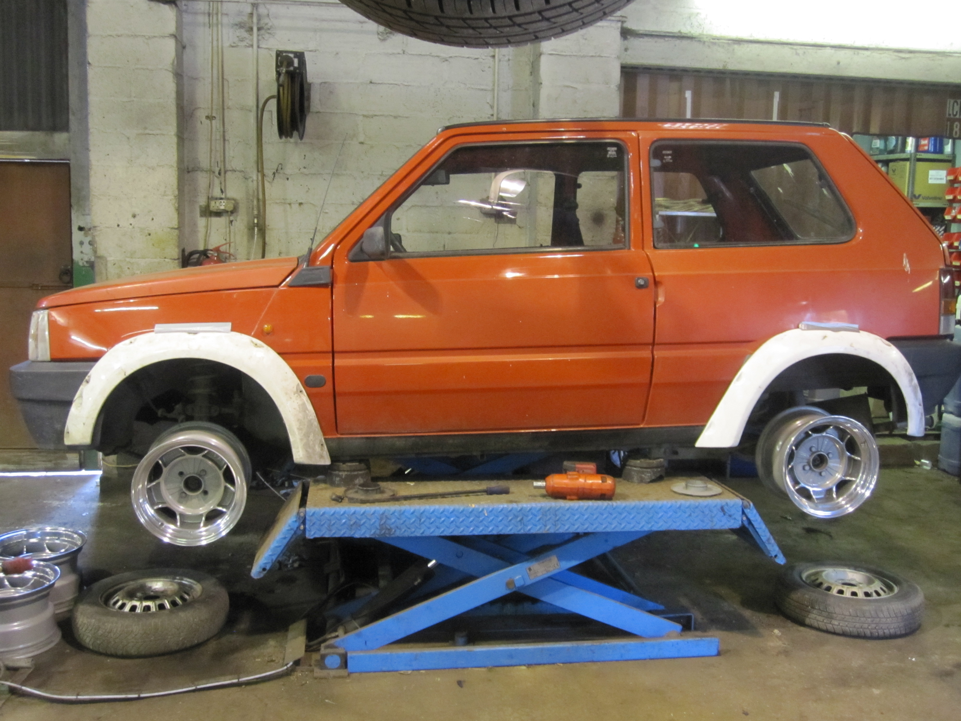

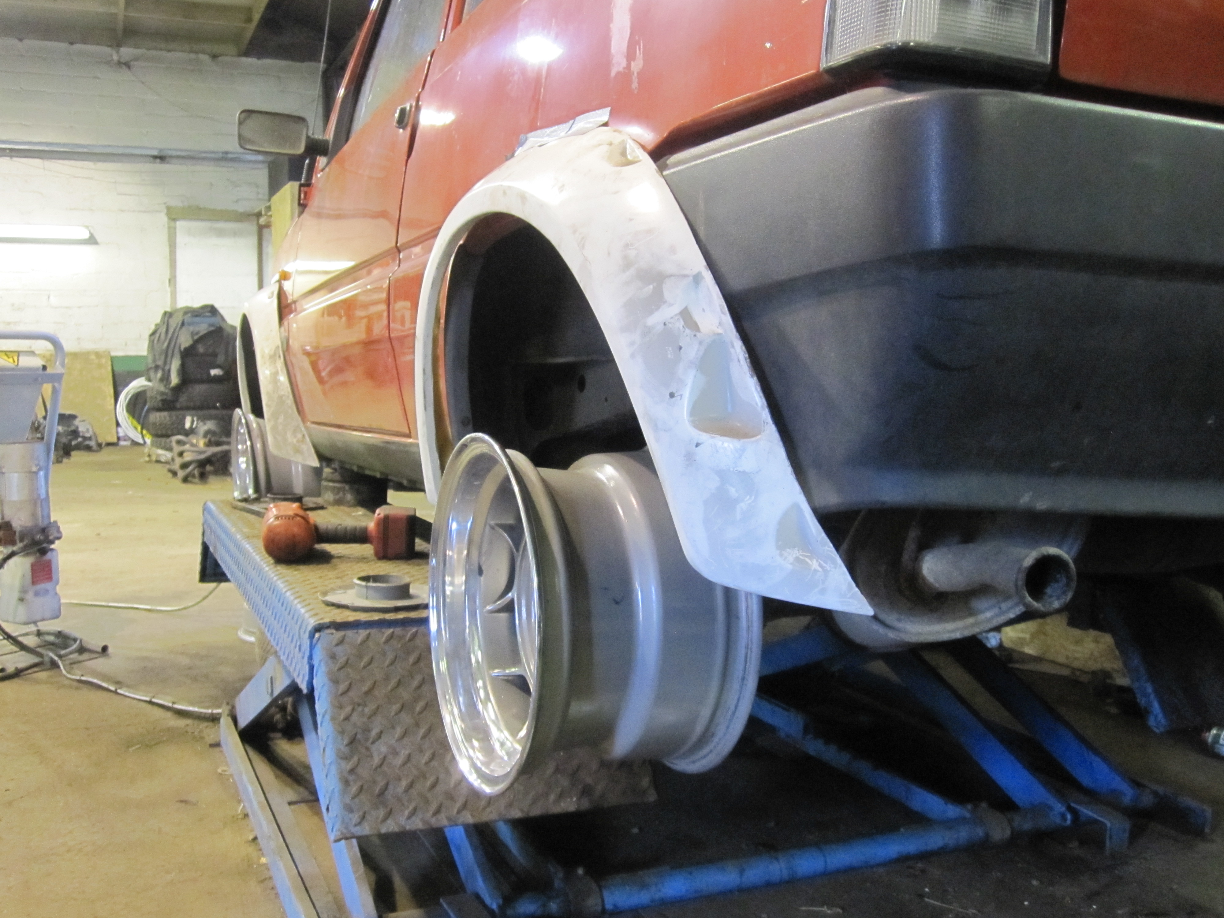

Here are a few photos with the 13" wheels trial fitted , also found some wide arches my old man had from his mk1 fiesta back in the day they could be made to fit well
What do you think ???????

Your right VmanC it does just fit pandas are a bit on the narrow side

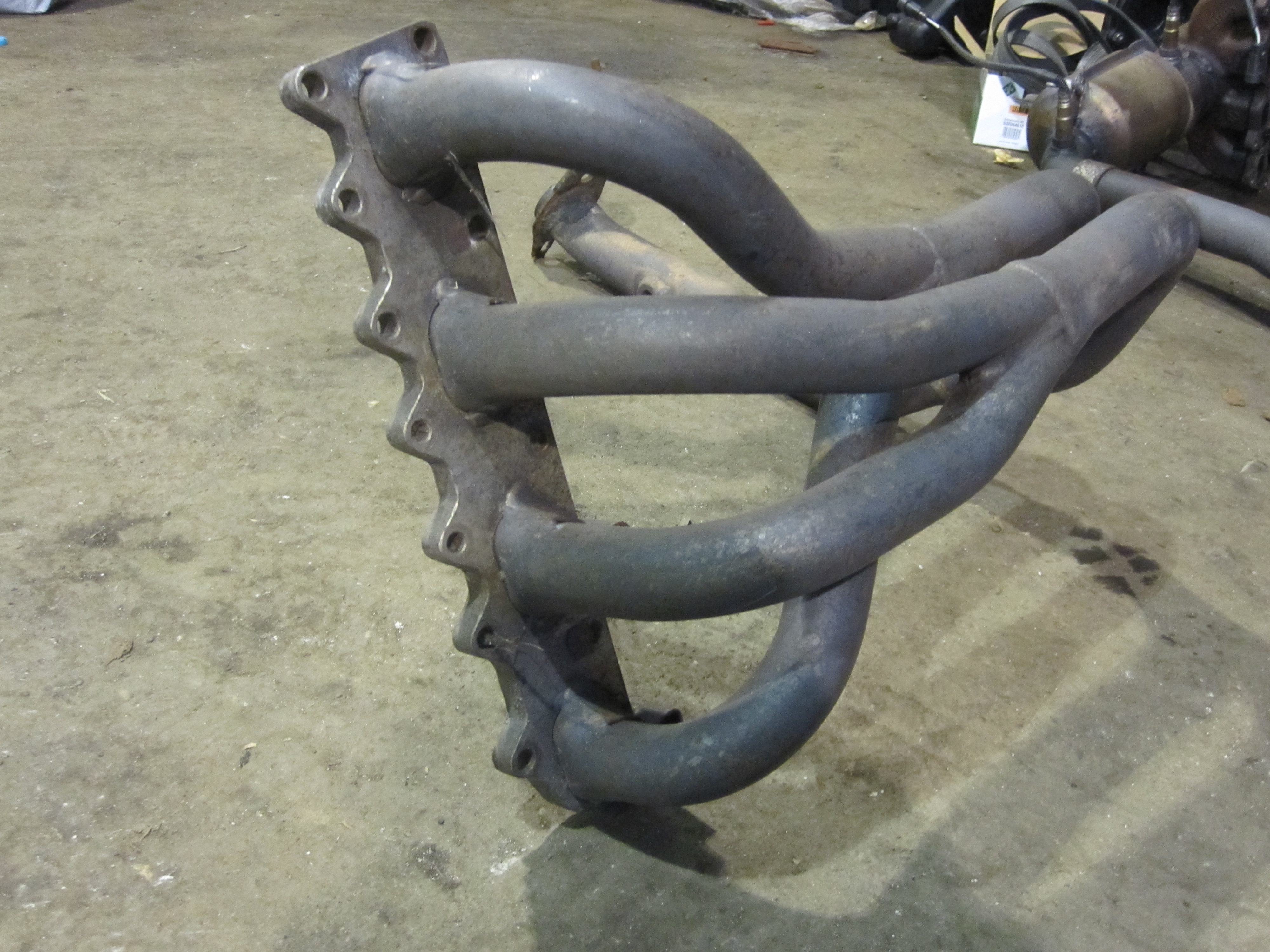

More goodies arrived today from my brother who spends to much time on ebay and buys things not really needed hence the following pictures of 13x8 alloys (Must admit they do look better:cool:)
Also a new race alternator arrived which will need custom brackets but only ways 2.7kg the picture shows it compared to the original as the build goes on you will reliase that Im a bit obsessed with wieght saving and hope to get the car down to 650kg with cage.
The manifold pictured is a vauxhall red top that was lying around I plan on cutting up and making my own 4 branch out of it. The machine shop is making a new flange to weld it to as we speak :)

Yeah your right they probably a bit wide and hamper the handling but would like to make them work as they fill the arches nicely:D

If I worked out correctly they should have more clearance from the inside lip to the strut (front wheels) and rear suspension arms (rear wheels) having an ET0 compared to the ET25 on the 7" Wide wheels! Was I right?

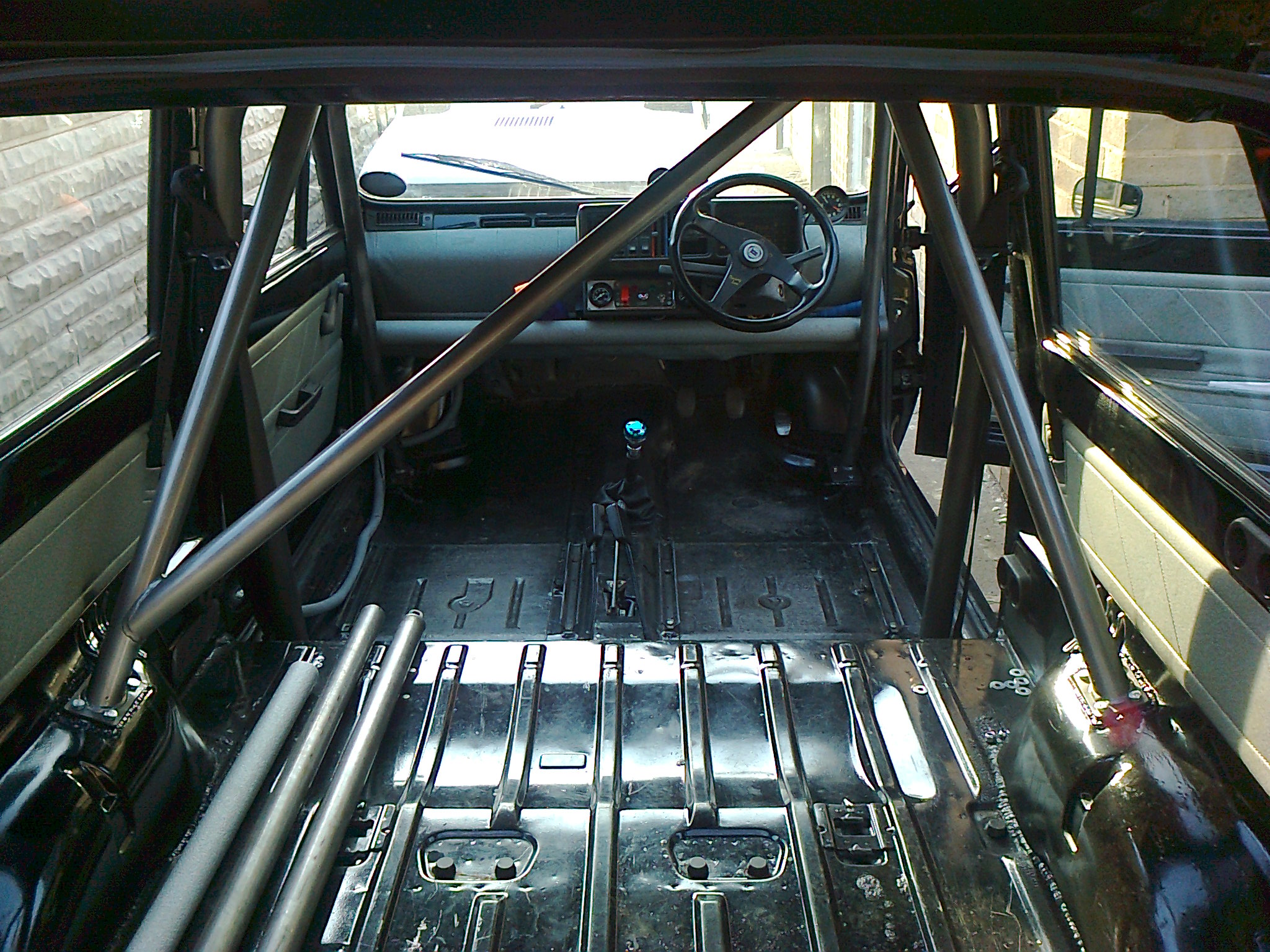

Here is how my rear backstays mount:
not much strength on this arch as the suspension mounts are towards the back corner (where the shackles hang from on leaf springs)
But if you can't use the 4x4 one, there is always the option of custom. How's your welding? :D

Yes OMP, I could only find one place selling one at the time which was Demon-Tweeks, and not sure they sell it anymore either. The rules got changed as well and now you cannot have any bolted joints, so that is another thing wrong with my cage for the FIA :eek:
