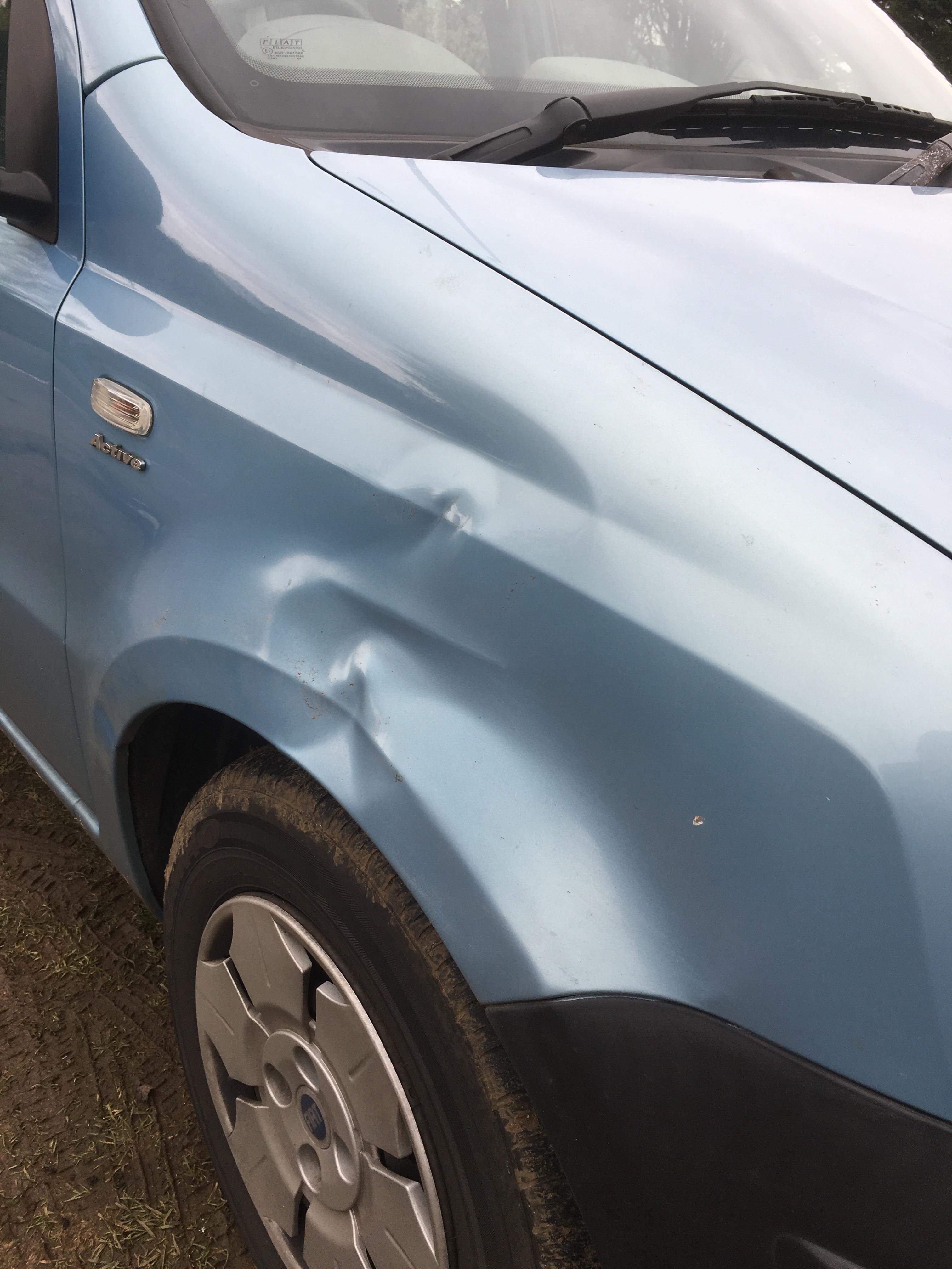

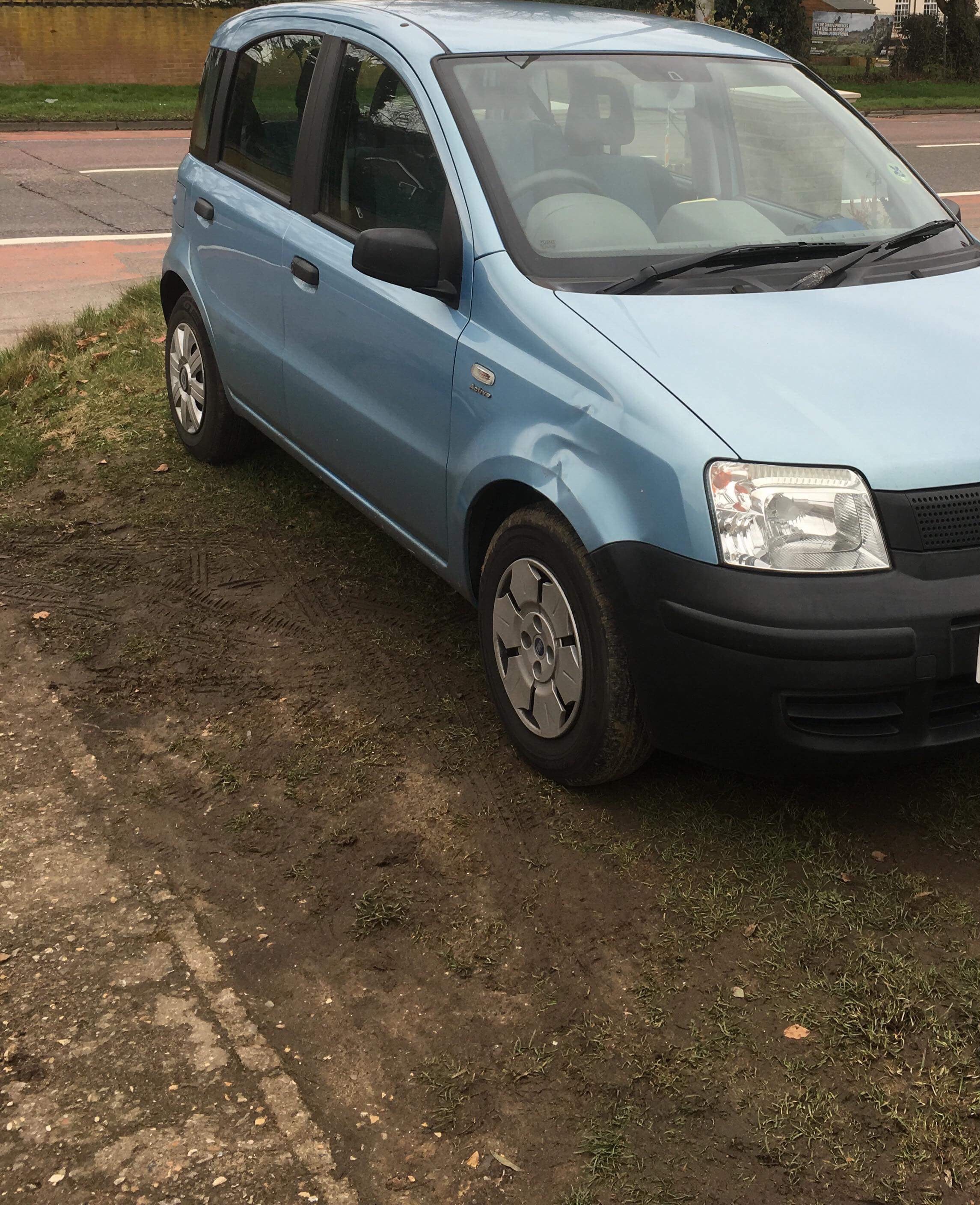

Morning all,
I’m looking for advice on a dented front quarter panel on my panda that someone was kind enough to leave
Is this easy enough to get off and replace or does it look salvageable?
Thanks all

Just bolts on I think. Search for similar threads by SB1500 as he replaced one a year or so ago.
Edit: Here it is. https://www.fiatforum.com/panda/446939-replacing-front-fender-wing.html
If lucky, you'll find one at a breaker in the same colour, although 'same' colour may not match exactly.
Getting that dent out might be a struggle due to the shape, but you could ask one of the 'paintless dent removal' operators in your area.
