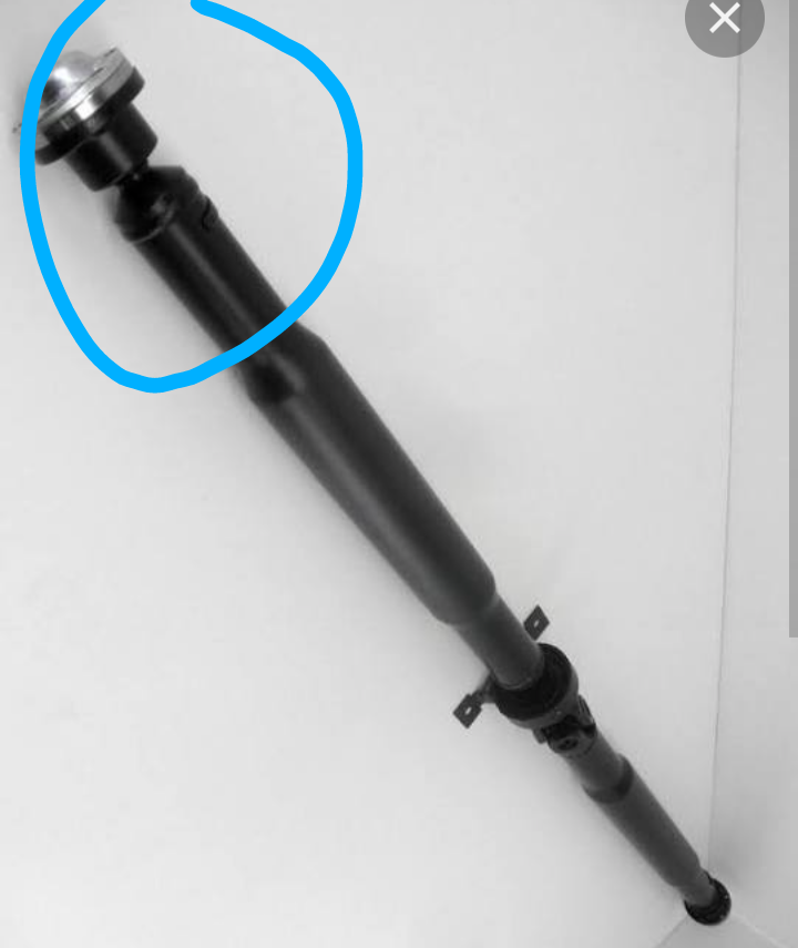

Is it this part that you need?
There appears several brand spanker complete propshafts on eBay
FOR FIAT PANDA MK2 4X4 PROPSHAFT 55222107 55193595 55197051 55264146 BRAND NEW​
Look like very good value to me.
