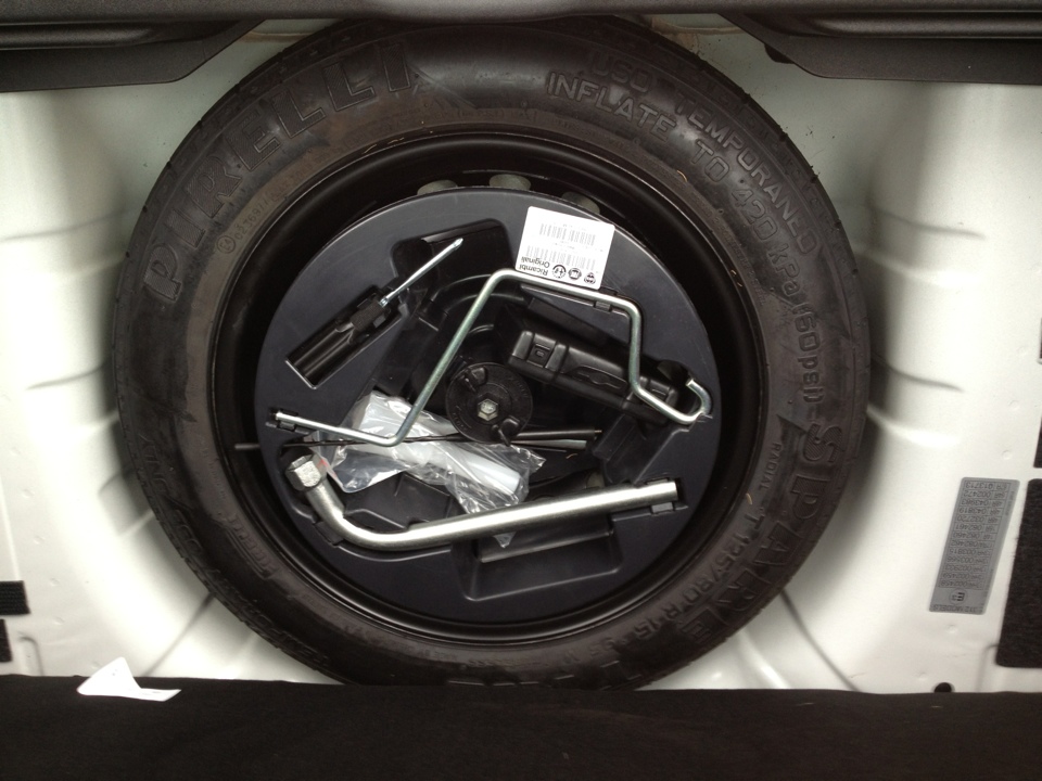

I have picked up the insert today: part number 51716187
It does fit in the spare wheel, but is slightly higher than just the spare wheel so it lifts the boot floor slightly. On the attached picture you can see that the tools fit in there nicely, but the jack doesn't. Looking at the jack, it clearly states it is for the doblo/panda 4x4, so the 4x4 does indeed have it's own special jack and it is not the same as for the normal panda as I was told by the parts department.
Nice surprise was the extra aerial I found in the toolbag.

Oh dear what have I started....having shown everyone a pic of my Panda 4 x 4 spare wheel and fitted toolkit and jack sitting neatly in the spare wheel well ..I have just taken a closer look at my space saver and notice it is a 135 x 80 R14 NOT a R15 as should be fitted.
Have spoken to my dealer and he thinks the factory mistakenly supplied a spare wheel set up for a Trekking not a 4x4.
He has ordered a proper R15 space saver set up for me and also confirms the 4x4 jack is longer due to the taller wheel and increased suspension ground clearance.
