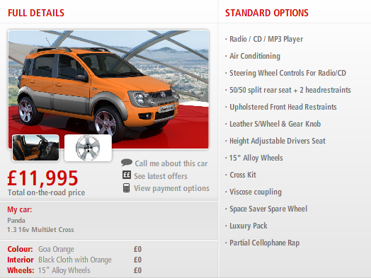

One more edit (last one!). Go through the 'Configure a Fiat' route on their website, and you find the list of what;s in the price - pasted below: (intrigued by 'partial cellophane wrap'!!)

Partial cellophane rap is an intriguing feature, is it a form of body protection or a style of music?

The misspellings are great, aren't they. "Viscose" coupling, viscose is a form of man-made fibre not terribly well-suited to inclusion in the drivetrain of a 4x4, a viscous coupling would work much better. "Partial cellophane rap", a wrap would make better sense.
